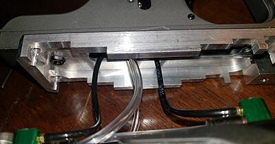

Here's a quick set of pictures I got with the grips off, sorta showing how short the action is. I recently aired it up and shot it in my backyard, it's pretty fun and I could easily see this being a back up or a loaner, works great and is pretty quiet

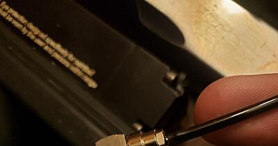

the qev would thread into the front fitting on the firing can, vs in the frame It should fit, but depending on the body you have it could hit while rotating. I have a different qev thats really long and that requires a small radius cut out of the bottom of the stock body to thread all the way in. Now that I snapped a pic I think its a pps one lol. Look at my attached photo.
So that being said you either gotta float it with thread tape or locktite, rad your body, or get an adapter male to female 10-32. I want to be able to upgrade my body so I just got the pictured vibe QEV (4mm line) to try out. Hopefully it lasts longer than the small ones.
