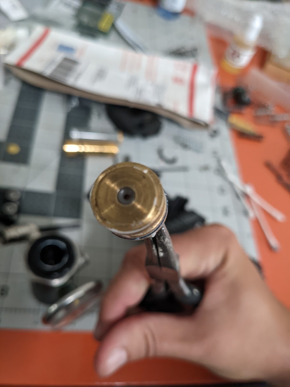

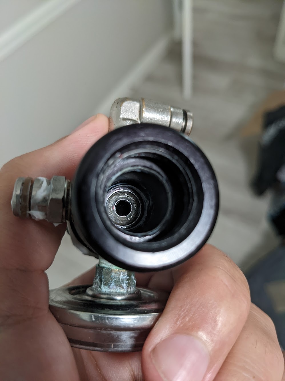

    Uploading some pics. This is perhaps the original max-flo that was used on 4500psi tanks. I just replaced every o-ring I could but it is still leaking out of the front cap when I put air in it. I took pictures of 2 o-rings that seems like that could not be replaced. I am also not sure if I had the correct replacement o-ring kit for this model.
    Can these 2 o-rings actually be replaced? From the reading I have done they are most likely the issue when you are getting leaking from the front cap.
    Anyone have any advice?

    This page gives all the sizes and duros for the orings: https://www.zdspb.com/tech/mguide/re..._manifold.html
    Mine were all urethane, but some have said that you can get away with buna on certain seals.
    The orings you pictured should be able to come out with a pick.
      I. Am. Canadian. 🇨🇦
      • 3511
      Where did you get the seal kit from? MaxFlos are a bit fussy about what you use.
      Every seal is replaceable but sometimes a pain to do.

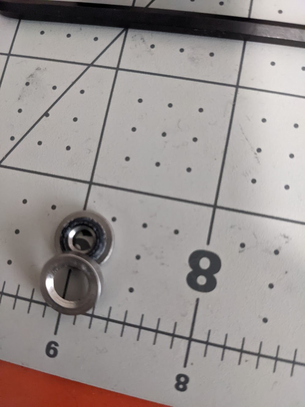

              So I spoke too soon, I tried 2 different o-rings in the base seal and as soon as I turned the air on the blew immediately and destroyed my gauges. Does anyone know where I can get the correct 9/90 O ring for it without having to order like 200 of them at once?
              attaching an image of the the o-ring that went bad.

                  the size and more specifically the durometer of the O-ring is a big deal with these smart parts regs.

                      So I think I have the correct o-ring for the reg seat. Its at least not breaking apart now. I got it to the point where the reg works but it starts creeping and leaking after a few seconds. every time I take it apart this reg seat is not together as one piece anymore its slightly apart and the o-ring is slipping through. Is there supposed to be lube on the o-ring in the housing that this seat sits against? maybe its sticking on one side and when the piston starts moving its pulling apart? the reg seat was very difficult to get open when I first started the rebuild and now it comes apart pretty easily.

                        Have you read https://www.zdspb.com/tech/mguide/re..._manifold.html ? Great info there that should help you, if you've not seen it yet.
                        No grease on that seal.

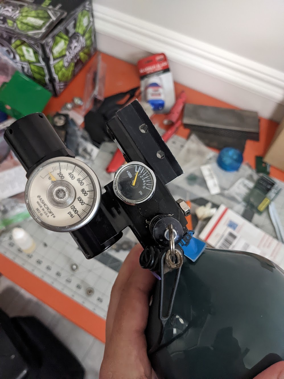

                          Ok, I stopped the leak / creeping issue but now the bottle is... honking? I am putting a link to a video. It sounds extremely weird and the bottle basically vibrates slightly while its recharging. anyone have any guesses on what is going on?
                          My LPR gauge is dead because of the last time the seal blew up. It initially leaked until I turned up the pressure. Is it possible this sound is because the reg is turned up higher than the highest recommended pressure and its struggling to recharge to the correct pressure?

                          If your reg is honking, it's not greased properly.
