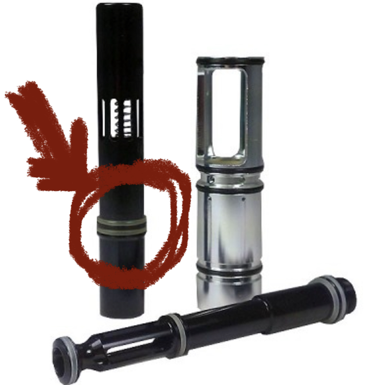

      If air is blowing out of the eye covers it’s likely an inner can oring. I would rebuild all the orings the bolt rides on. This would happen on the older luxe and it would blow the eye covers off at times that’s what they added latches to them.
      I use to know what one specifically but it’s been a min since I worked on a Luxe. I think it’s the SFT oring that causes this problem.
      It could just need a lil grease or a good cleaning if you haven’t serviced it in a while.

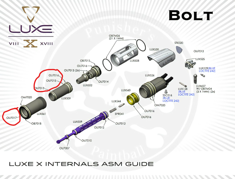

        Pretty sure the gauges is correct, fill station say 4500 psi when I fill as does the gauge on the bottle. The Luxe X and TM40 have a different bolt design then the one you pictured. I think ill inspect the orings I've circled in red and replace as needed. You could be right it could just need a bit of grease.
