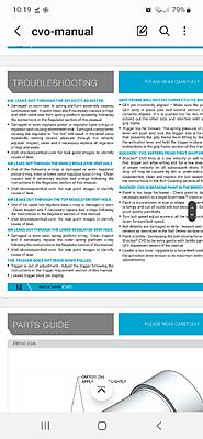

      That's what I saw in manual too. I just replaced all the o-rings in regulator and no change.

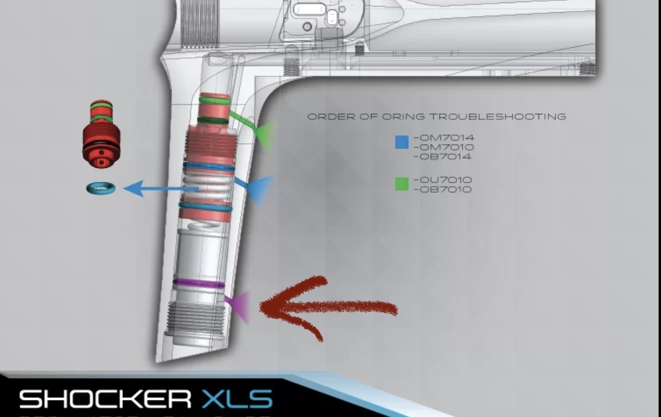

        First step it’s to determine what is actually leaking. These diagrams will help you determine exactly what is going on and what you need to focus on.
        https://www.shockerpaintball.com/tro...ng#toggle-id-4
        Its probably this one if it’s leaking from the lower vent hole.
