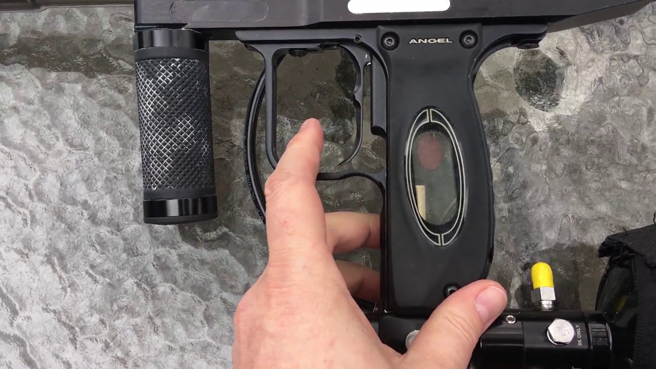

MAC-33s can definitely be shorter. Generally I like to put the solenoid valve relatively high up behind the trigger (as high as I can go without hitting the piston) so that the trigger provides some leverage, which makes the pull softer and longer (about 1 mm). But if you put the solenoid farther down, the trigger pull can get pretty stupid short.You could run a Mac33 solenoid if you convert the valve to mechanical actuation (ahem, rawbutter) but you'd need to run an external LPR to provide air pressure to it and then have to fiddle with balancing your LPR and HPR.
Smavs have a 1/16" stem travel, though - is that not short enough?
The disadvantage to this is that the trigger pull is heavier. You can see in the video when I try to tap the trigger farther up, and the marker doesn't shoot because I'm being too gentle. This isn't as big a deal when you're shooting the gun the "correct" way instead of using one finger on your weak hand at a weird angle, but it's still noticeable.
