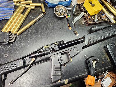

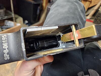

          I shimmed up the magwell and added a mag catch today. Now that its where it needs to be, I can start working on mounting all the internal components and mill the breech out.

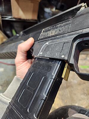

            Did you use a DAM magwell or mod the existing SP8 body for the DMags?
            • JeeperCreeper
              JeeperCreeper commented
              I cut the reg mount and everything out of the stock magwell. Its set up for Dmags, they seem to have the smallest profile. I think a Dam / CF-20 mag would fit, and M17 mags would be the tightest fit. I have all 3 on hand, the Dmags just fit the magwell with the most room, which helped with the catch. You would have yo get really creative with the other mags, as they really fill up that magwell. I'll take better pictures of everything after its working.

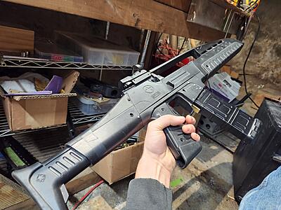

            Its a tight fit, but I think it's going to work. I have to get creative with the rear section of the body, as the reg sits where the old pin used to hold the stock on. Overall, taking this apart will be about the same difficulty as it was before. Good thing it will be mech and I shouldn't have to take it apart very often. If I had a Mini reg, I could have probably avoided most of this work.

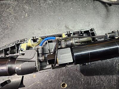

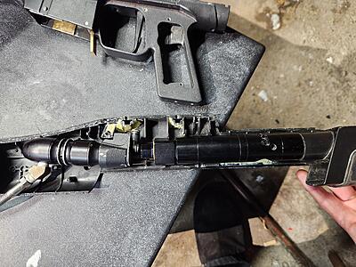

                Plumbing wasnt really too bad. Now I just need to clearance the other half of the body shell. Then I need to mill the breech. It's getting close now.
                Dont mind the ugly putty. I'm attempting to gain a little bit of strength. This body was so bad when I got it, I'll likely replace it when I get another.

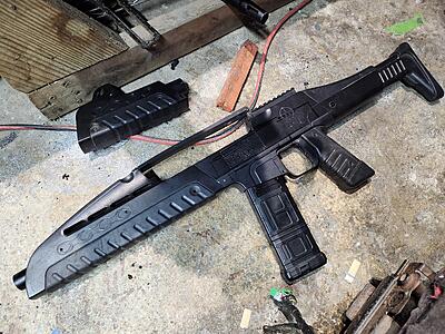

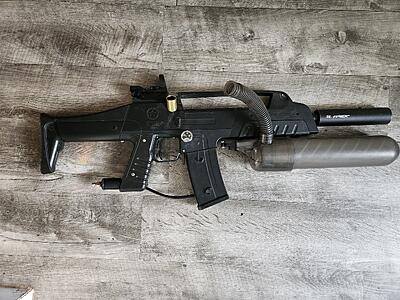

                  Just needs a few more little things, but its all coming together now.

                  • RAZRBAKK
                    Unburdened by genius.
                    • 1380
                    • Calgary, Alberta
                    Man that's so sick. I've been wondering when someone would finally do it.
                    Very clean work getting the DAM mags on there, too.
                    • JeeperCreeper
                      Dmags, not DAM. Slight size difference made me go with the Dmag/helix magazines.
                    • 6249
                    Are you just cutting a hole so you can adjust velocity?
                    • JeeperCreeper
                      Multi-purpose
                      • 2129
                      • Western MA

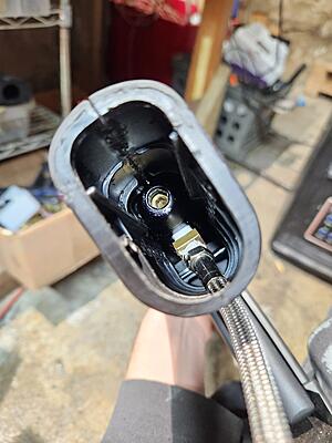

                      Trbo323 I made the rear section of stock removable, and its a Dye Hyper 2 so the adjuster is right there facing out.
                      Its still big, plastic, and cumbersome, but overall its better without a hopper or qloader strapped onto it. Overall its about the same work to dissasemble it (still a PITA), and to get this barrel off I have to jam an allen wrench into the slots and twist it, but overall I think this thing is going to be fun to bring to a local magfed meet-up. The only piece I need to buy for this is to run a remote line, everything else was on the shelf. The magazines were donated by Jonnydread (thanks again!) and I think I payed $25 for the Sp-8 and $50 for the mech parts.
