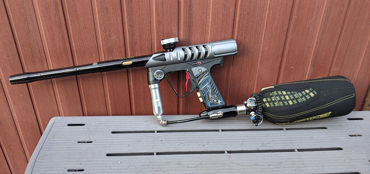

    So I've got a couple of Ions that I picked up as part of a gearbag sale, figured I'd turn them into mechs. I've got two of the ssc kits ready to go, as well as two of the dual oring shocktech bolts. I was getting the first one fitted out yesterday, got everything together and put air to it. No leaks, but the bolt shoots forward and stays there. The tank I was using had low air, I was only getting about 140 ish psi out of the regulator. I'm getting more air today and will test with full tanks, but this seems odd to me? I double-checked everything, all the connections are in the right place and the switch is not depressed. Does the bolt need a certain amount of back-pressure to overcome the forward pressure on the bolt sail?

        Thanks guys. All orings are fresh and lubricated and the bolt assembly is assembled correctly, so I think the issue is likely a pinched hose to the front banjo or something with the smav3.
        • RichM
          • 164
          • Vancouver, Canada
          As suspected, the issue was a pinched hose. Thanks Jordan for the diagnosis, and also JeeperCreeper for the pen spring trick... worked like a charm! She's shooting like a champ.
