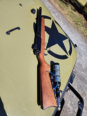

            I wanted one of these, but I'm not really into magfed, so I never got one printed. The thing is you have to flip the breech upside down, then mill the feed out (I believe there's a print for a jig that goes with this) and then you would presumably want a way to cover the air lines that are now up top. The rear can swivel on Ions, but BOB bodies also have a fixed rear air line. So then you have to either jam this all into an airsoft shell, or maybe make some kind of sight rail that will cover the lines. It's alot of work, so that's why it's not popular. But who needs to be popular? These things are so cheap, why not try to make a magfed? You can pick up spare parts for cheap on the book face, so not much to worry about if you mess up.
            I just prefer to run single shot. I can hand load FSR pretty dang quick through a milled breech in this Ion/SP1/mech mutt. Honestly it fires FSR great. I've yet to miss load and break one in the breech. And it is stupid quiet.

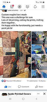

              Also found this on FB one time. It's a magfed Ion
