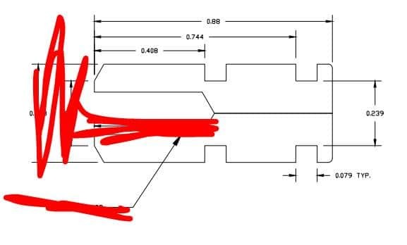

    • 3511
    The spec for the second oring location...Click image for larger version  Name:	FB_IMG_1595817449343.jpg Views:	0 Size:	19.9 KB ID:	82382
