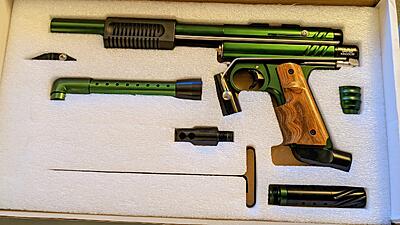

    The black block right under the barrel goes on the dovetail then you hold either the stick feed or feedneck on with the screw. You can see the grove in the feedneck.

    I don't know of a clamping feedneck that would work. Maybe we could get someone to make a batch of Empire feed stubs that would fit into the feedblock or possibly have your feedneck milled down to take an Empire feed. I have other pump guns that I can use so I've always used my Sterling with the stick feed but if I do decide I was going to regularly us it with a hopper I'll find someone to cut down my feed and convert it to an Empire stub.

    started a topic "New" Sterling parts questions
    First, I love/hate all of you for sharing where to get new Sterlings. A green stock class version arrived at my house yesterday. Took exactly 8 business days from clicking the buy button to the mailman getting the delivery signature.
    Now, I'll certainly run it sc sometimes, but mostly I'll run it as oc.
    My questions:
    1) how do I get a clamping feedneck on this thing? The vertical feed adapter uses the mounting screw as a retainer bar for either the stock feedneck or the stick feed. I didn't see any other feednecks listed on paintballshop.com's site.
    2) how do I get an on/off asa on here while still using the gas-thru tubing? I can run a bottomline via the vert adapter & use any ol' asa, but that's boring.
    Thanks, in advance!
