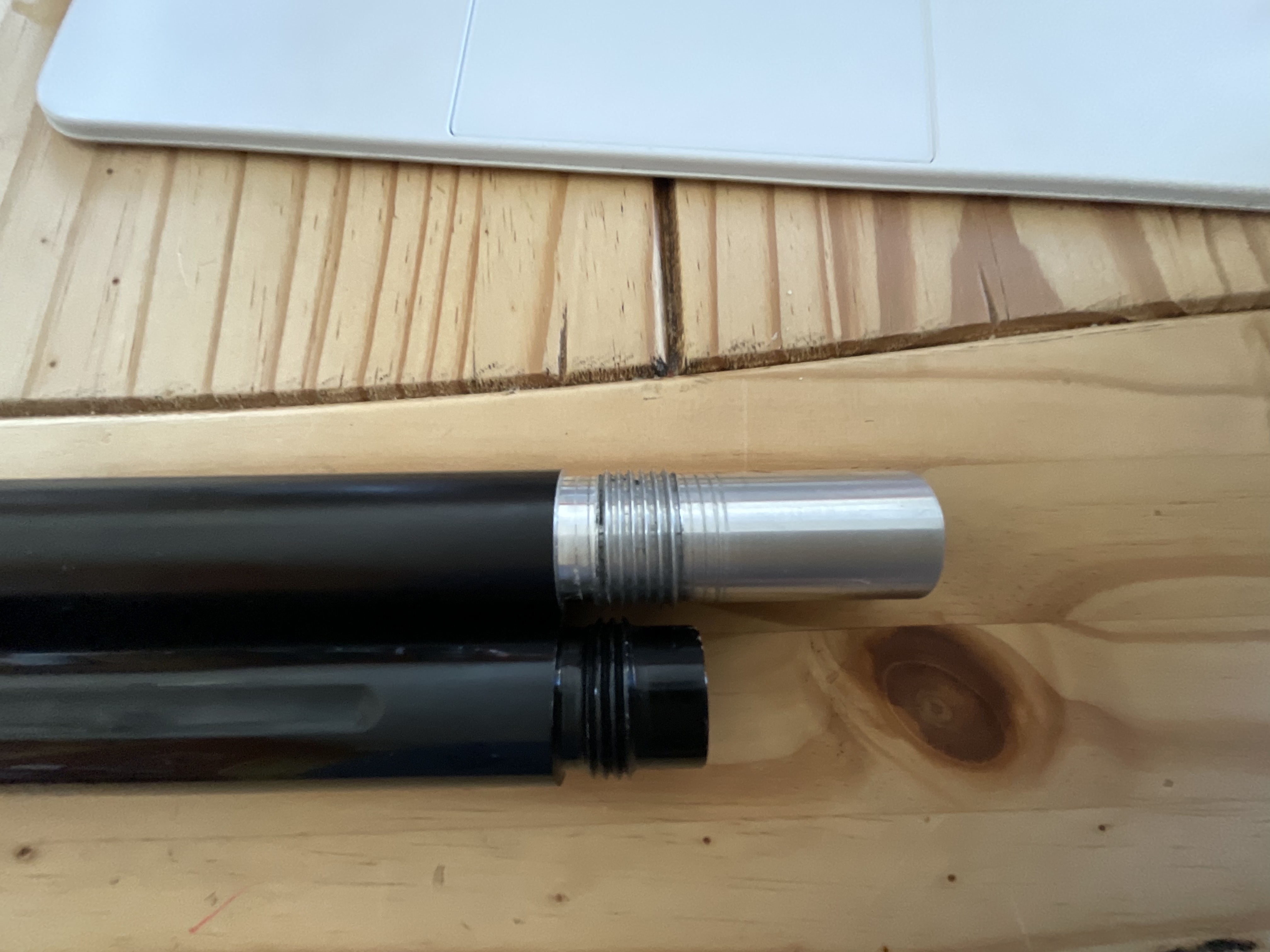

      Sov threads are different from sterling I think. The shaft is super short compared to my sterling barrels. I have phantom barrel that was retreaded and freaked for my sterling and it's pretty thin but the sov barrel doesn't look any thicker than an insert itself at the threads. I'll have to break out the calipers tomorrow and see just how thin it is.

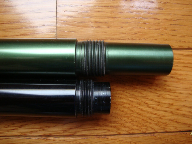

        sovereign and sterling are different barrel threads. hard to find any sov barrels, closest threads are phantom. phantom will actually kinda thread into sov

            actual threads are supposed to be the same, ive never measured

            Yeah looking at mine they do look similar just about half as many threads. Od of the threads measures out the same. Pitch looks the same. It’s the shaft being so dang thin that is the problem on the sov.

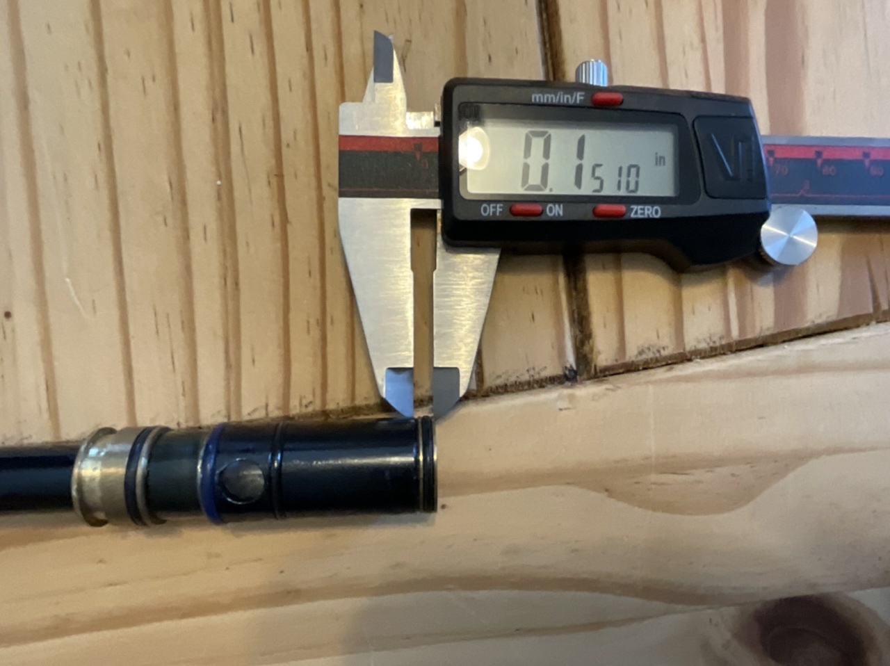

            Using my state of the art digital calipers from amazon made in China for exacting machine work by Clockwise tools…
            So breech side thickness is between .028-.031”
            The od breach side is .75-.752”
            Length of shank from first thread to end of barrel. .3565.
            My aluminum freak insert .684
            .7400 OD
            so yeah freak insert seems a no go as I would have about .005 of a shank left around the insert. If my arithmetic ariths correctly.

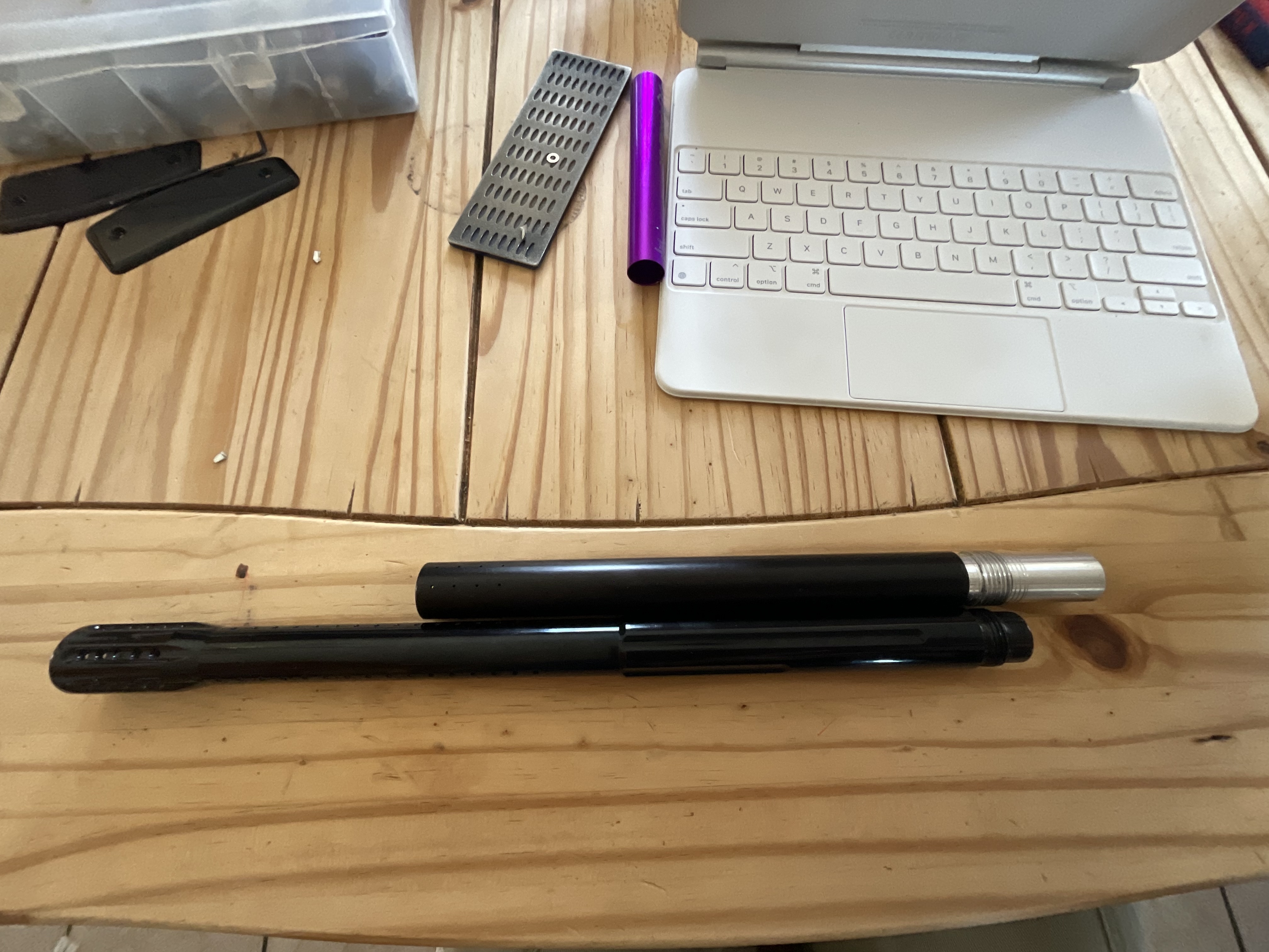

            More coming in the edit. I’m digging my sterling barrel out right now and getting pics
            So my rethreaded and freaked Sterling barrel (don’t remember who I got it from a few years back) is:
            .7800-.7820 od
            .0170-.0190. Shank thickness.

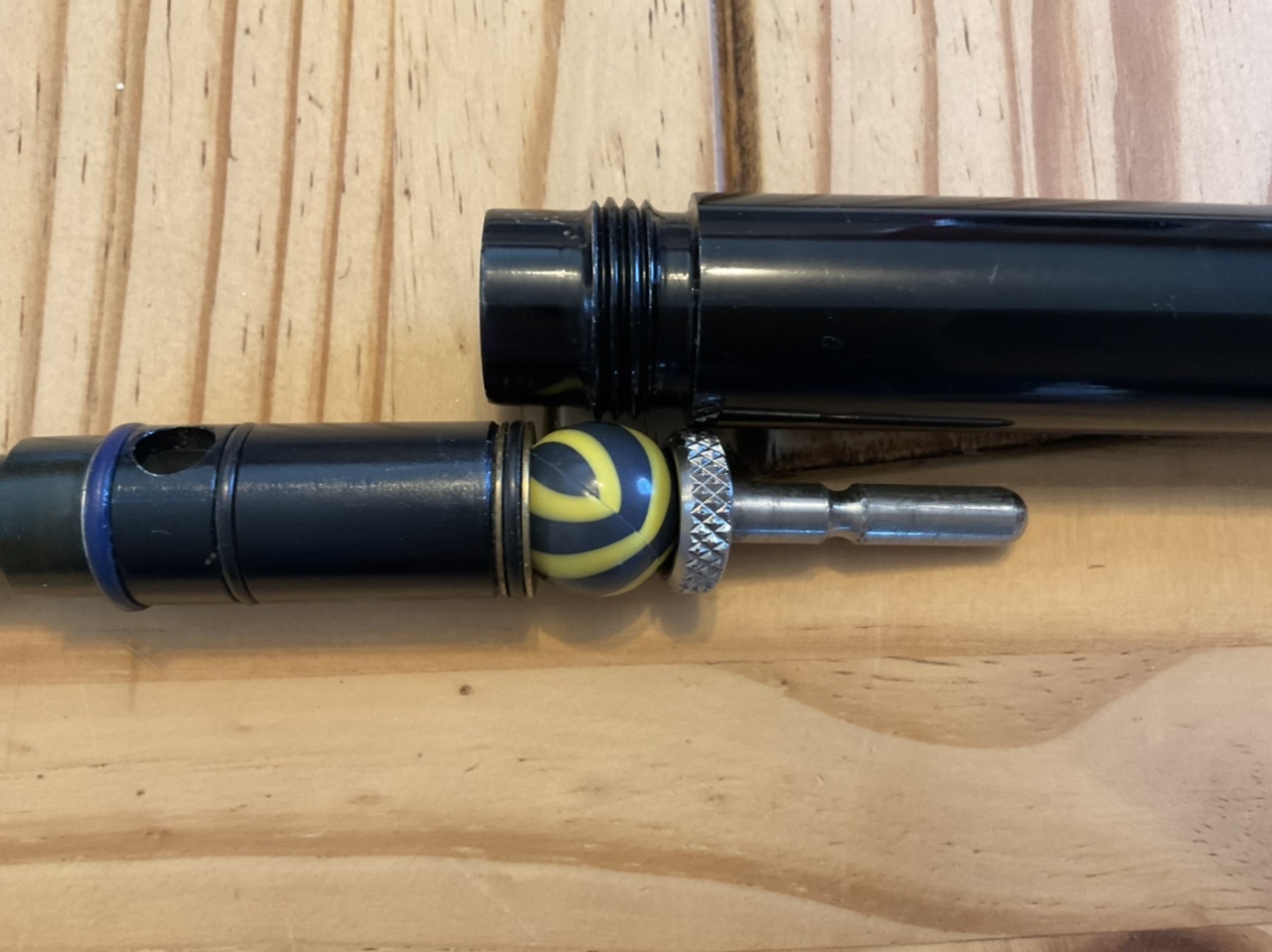

              Also it appears about this much of the bolt enters the barrel. The brass tip is .6815”od aluminum bolt behind it is .682-683 mostly .6825. It’s a tight fit into the 684 freak insert. Not sure of todays paint but a couple years ago I had to use the .679 insert to avoid rollouts on anything closed bolt. So a new barrel would require the bolt to be sanded/turned down a few thou or the bore to be chamfered or step slightly at the breach side.
              Also the ball sits just about right under the threads so wedgits are out. Oring mod or even like a thin wire oring might work. Is that how phantom rings work or are they fitted between the end of the barrel and the gun body? Shot one never owned a phantom myself.

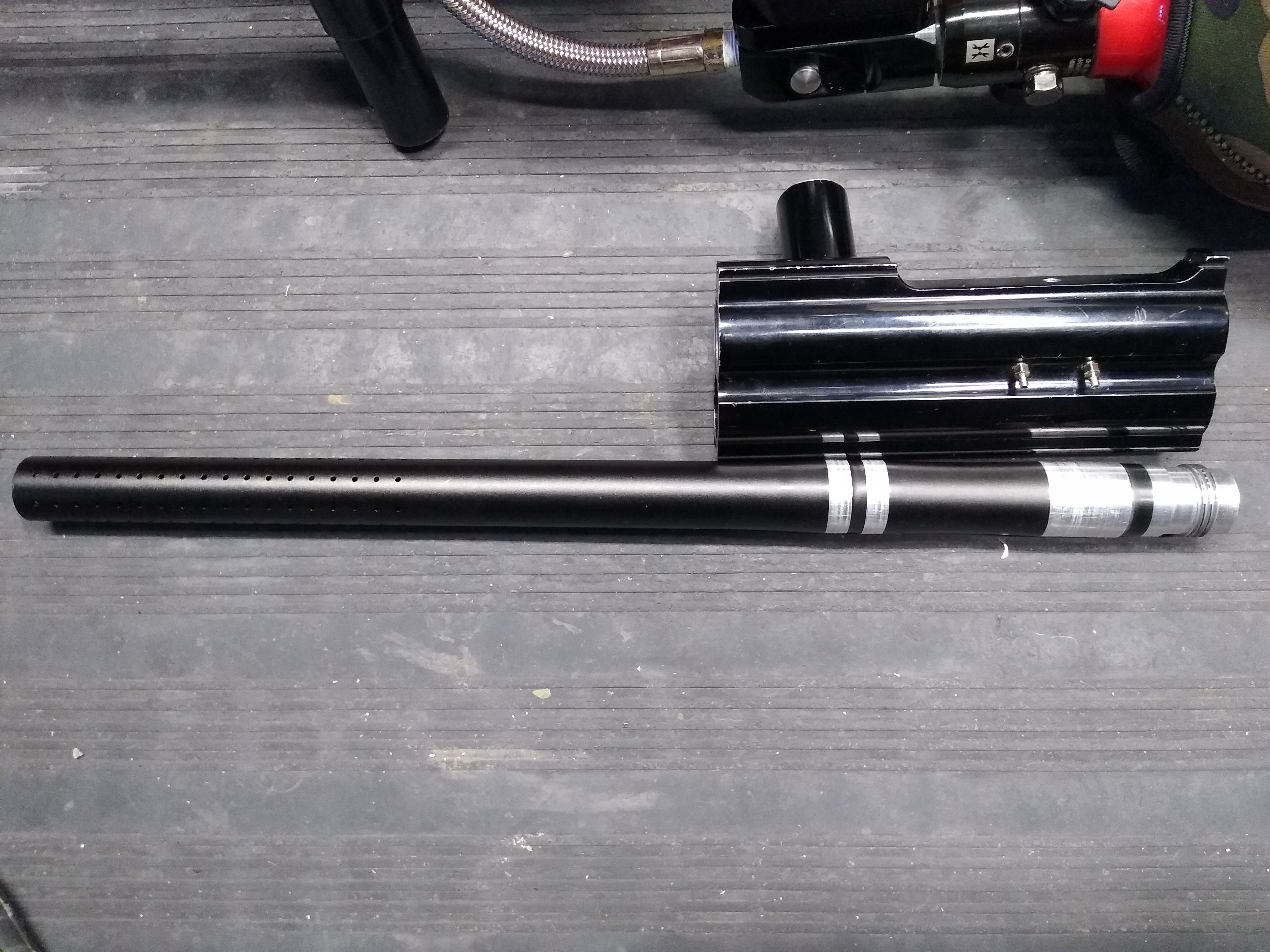

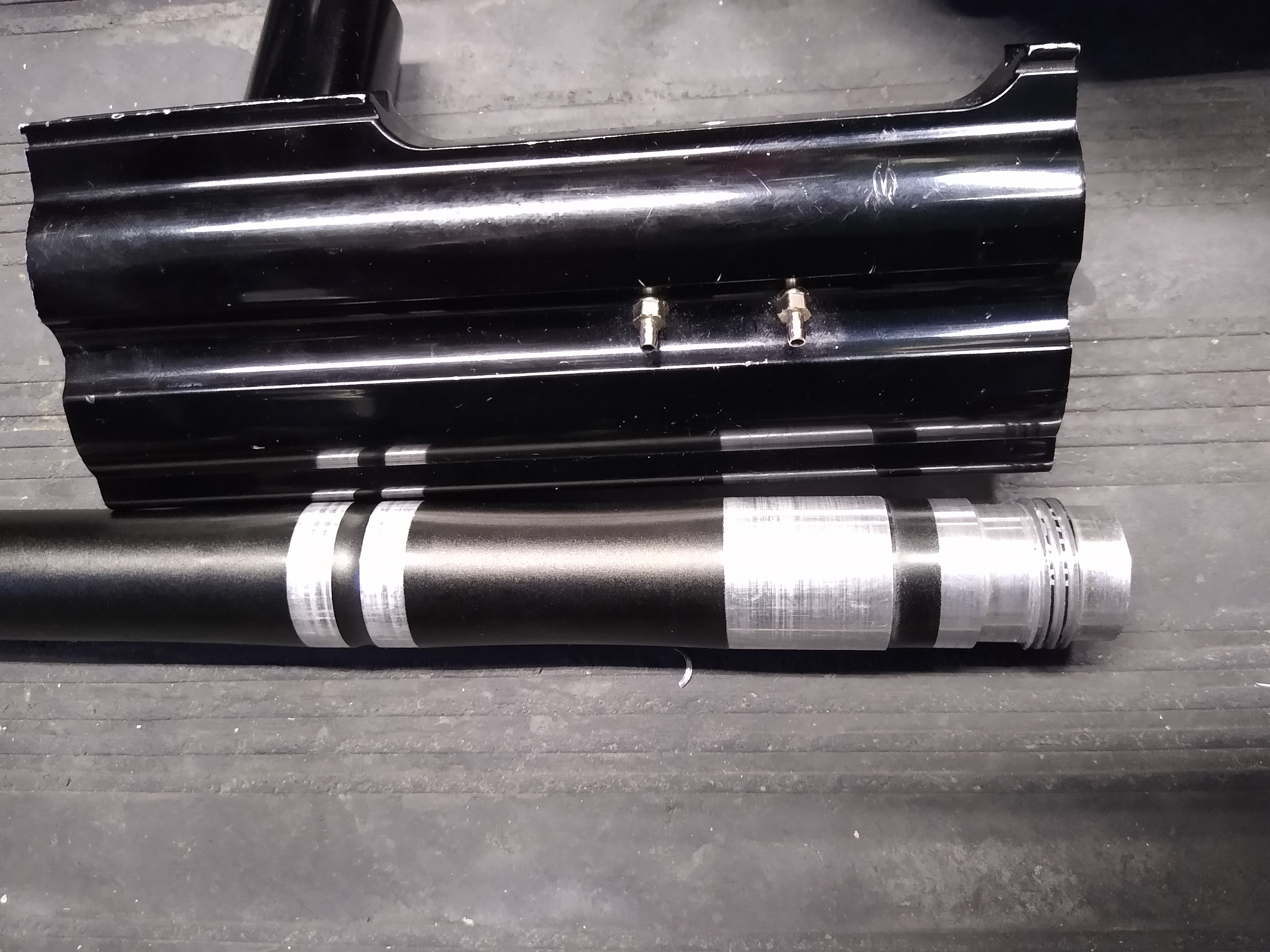

                Years ago. I bought a few lurker barrels when they were blowing them out. They were shocker thread? I rethreaded one for my phantom but later machined it for my sovereign. And yes, you do have to mod the bolt for it to enter the barrel.
                I have my sovereign apart to machine for wire detent.IMG_20231015_150141555.jpg IMG_20231015_150136997.jpg

                Would you be interested in the one pictured?
                It would be easier to modify the bolt.
