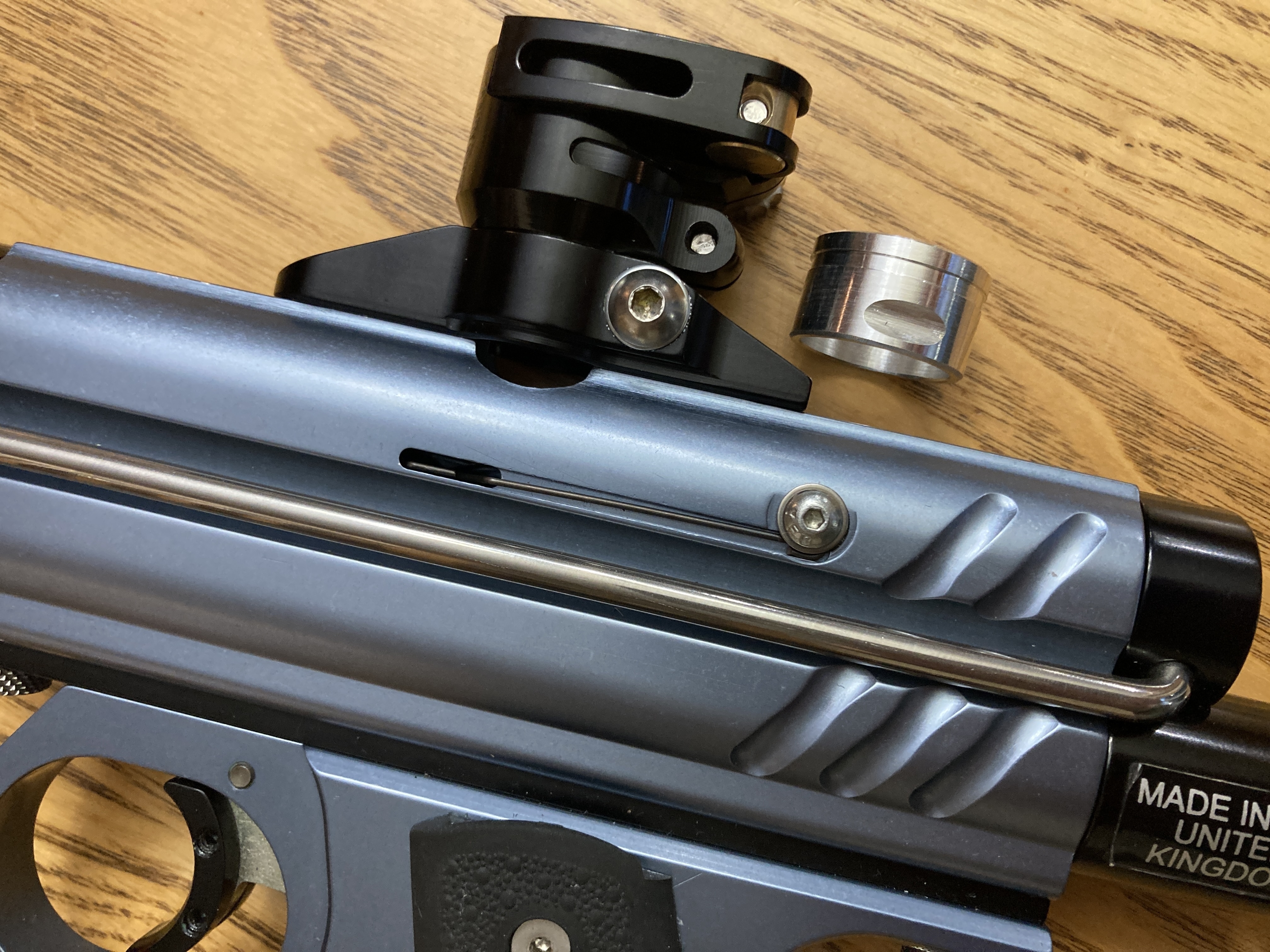

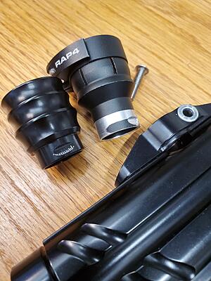

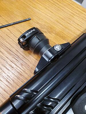

    I took a Rap4 Spyder 2-tab feedneck and turned off the tabs.
    It was already 22mm diameter, so it was a perfect swap.
    I used a die grinder to notch the tube for the clamping screw, and now my Sterling has a clamping neck!
