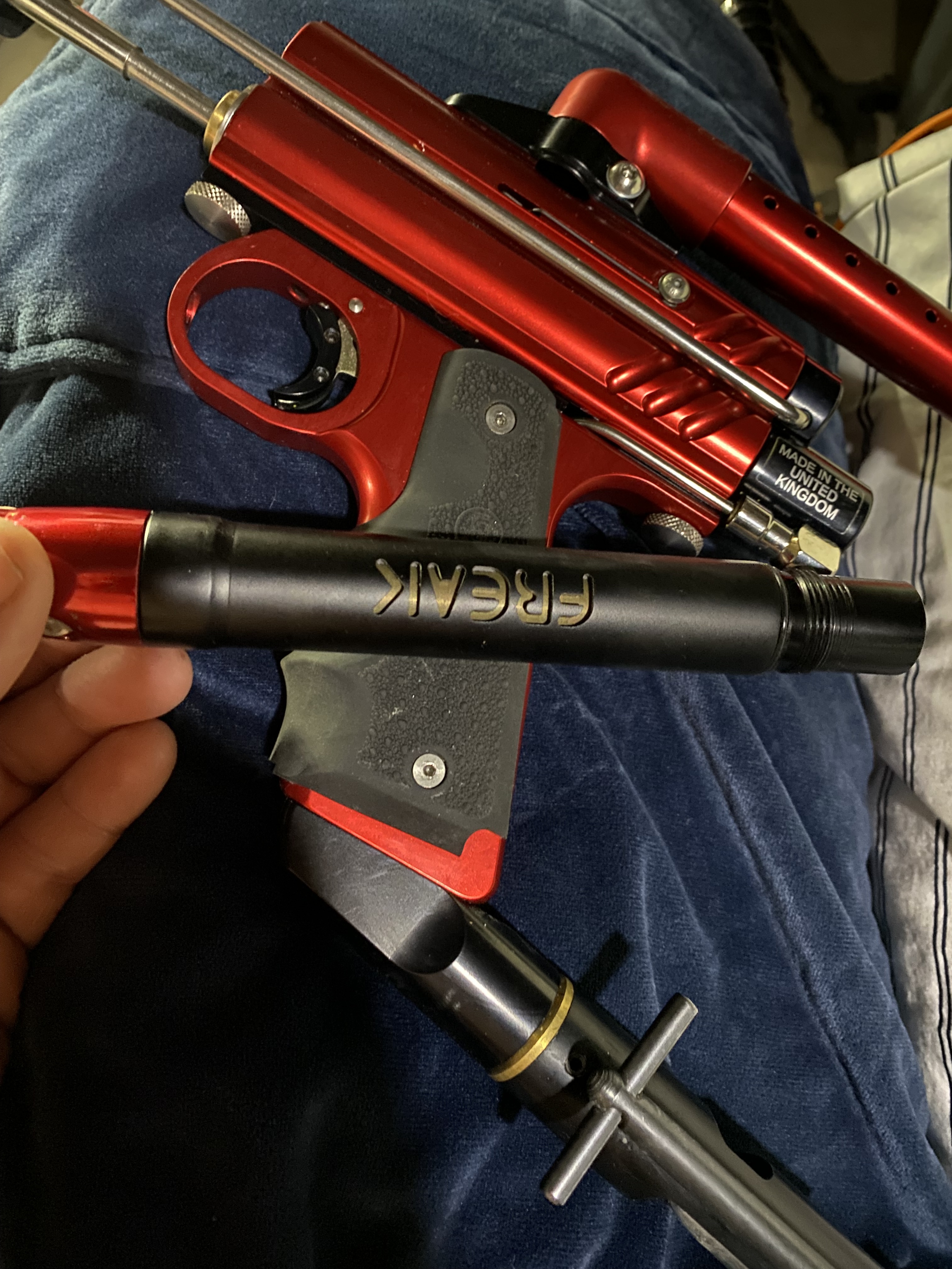

    I'm trying to find a barrel that will take smaller paint. I get rollouts with the stock barrel and an All American one I have, and it appears both of my freak backs OD is too wide for the pump handle.

        I'm not sure what Freak back I have, one has "windows" the other has the word FREAK cut out. Neither of them fit the pump handle however.

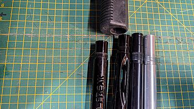

        If it’s an STP it will take the Spyder freak barrels with no mods.
          • 6332
          Doc has some on eBay that may work for yah. Shoot him a message have him measure the OD. But I be this will work.
          You want one that has smooth consistent size OD so the over the barrel handle slides smooth. I’m pretty sure it a 1” OD stock barrel.

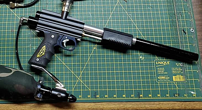

                You can bore a stock STP barrel Pb shop offers the option with a new purchase. I bet you could order one separately. Or have BMC do your stock one as long as it’s the newer STP spyder threaded barrels they can be done. I found the stock barrel to be too short for my liking. I use the barrel tip to aim and you can’t see it with the handle behind the marker with the stock one.
                This is the one I use that works 100% perfectly. But any 1” round barrel that’s Spyder threads will fit the stock handle.
                My barrel is .9975” and the handle is 1.1297” a true 1” barrel will fit perfectly and have a slight overbore to slide nicely. My handle basically rides on a the flared half inch section over the barrel tip back and freak back front section. It’s smoother than the stock because it’s got less drag and zero wobble.
                I bet that Doc back I posted will work nicely. I bet that will be even smoother with the polished finish. Mines more of a slight dust. I would have purchased the Doc back if it was available at the time. Shoot him an email. See what the OD is on it.

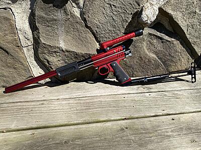

                  I do like the idea of a new style pump handle, are they sold by themselves anywhere? FYI here is a picture of the sterling on question.
