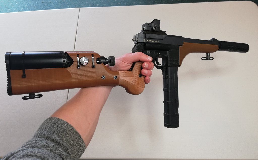

      It's working!!
      I think the problem was just that it was super-gunky on the inside. I spent several minutes with a toothbrush, some alcohol, and a box of Q-tips and it's now shooting just fine.
      Interesting bit about my magazines, though the two that I have which have the toolless cartridge changing definitely are not shaped for First Strikes.
      I'm probably just going to use it once or twice and flip the gun, but it's a little disappointing if there truly is no way to put a rear air port on an original T8, because I was considering buying one of the ridiculous Mauser conversion kits from Sellswords.
      https://sellswordspaintball.com/products/c96-standard/
      Is there not somewhere on the back of the gun near the regulator that I couldn't drill and tap for an NPT port, as well as plug off the magwell's port?

      There is a way to mod the back for constant air on the original T8s and SA8s. I have seen it done on the old MCB. Let me look if I can find it.....

        #19
        Best,
        Smiley
        Thanks.
        I assume the solution would be to tap into the front/side of the regulator housing, since the input would necessarily have to be upstream of the reg.

          To be honest, I am not sure. I need to research if this can be done.

            #21
            So, if using 12 grams, then what is the point of the pressure relief valve on the Tac 8. Right? Constant air would be the problem then.
            Could it be that the engineers were following the AGD design of the automag?
            Best,
            Smiley
            You hit the nail on the head. Tyler Tiberius did follow the AGD design of the automag in alot of ways but miniaturized it. When the Tac8 came out. Tyler gave an interview to SpecOps Paintball and Paintball 2Extreme magazines about the design and how it did follow the Automag design in operating principle, but he had to make some changes in order to miniaturize down to what it became.
