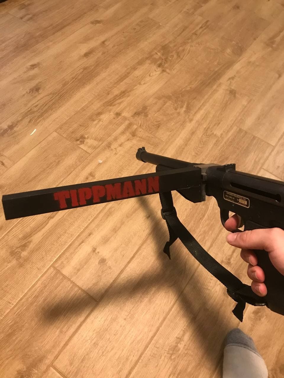

    I've been trying to figure out a solution to the stock aluminum magazine of the SMG 68 deforming after sustained use.
    Has anyone had success in addressing this problem? I've seen photos of people flipping the magazine around and remaking the holes on the unused end, but has anyone made a more permanent solution?

    I messed around with the idea of making some sort of an adapter of a stronger material. I don't have anywhere near the machining capabilities to do something like this myself though, and it looks like it would be pretty expensive if I wanted someone else to do it. The unique cross section of the magazine is throwing me for a loop. Every other aspect of the marker runs flawlessly, and it's an absolute thrill to use when the magazine opening is actually functioning.

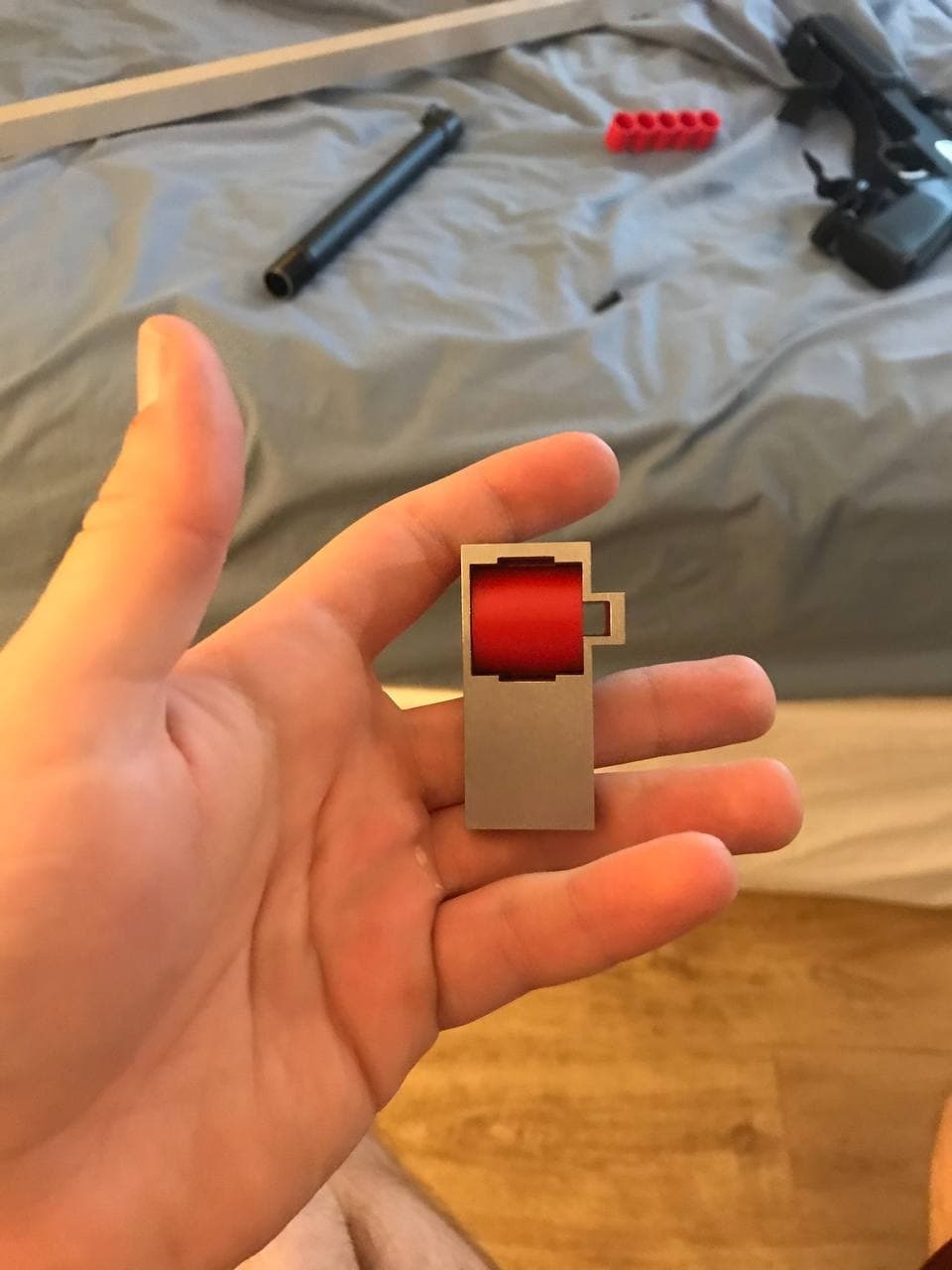

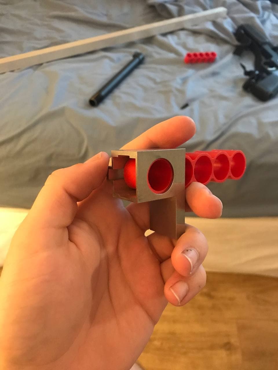

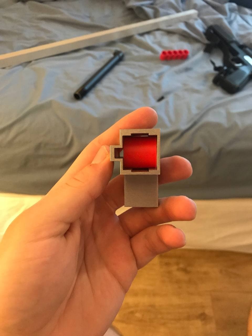

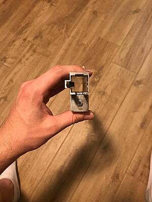

        Alright folks, I went ahead with the adapter idea. Gonna make the rest of the magazine out of some aluminum square tubing and drill the rest of the needed holes into the adapter. I've been simultaneously modifying the valve for HPA, and I'm getting close to what I need. I will report back with either incredible success or epic failure.

          Did you bite the financial bullet and have it machined from billet?
          • Tominator
            Tominator commented
            William The Third recommended a website called Fictiv, which is what I ended up using. I removed a lot of the features I could do myself so the cost came down to about $120.

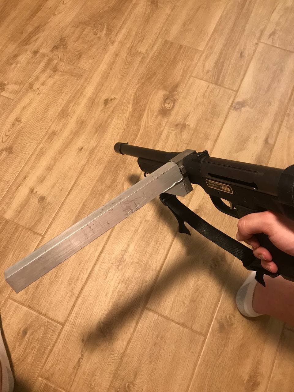

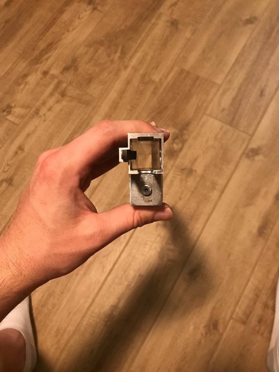

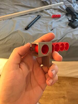

          It's in a pretty rough state aesthetically, but the whole feed mechanism is working properly. Picked up a 1" x 1" aluminum square tube and some brazing rods from Home Depot to craft the magazine. First time trying that so the joints were a little rough. I have plenty left though so I might mess around and make a 10-rounder or cut a nice big slot on the side so you can watch the clips advance.

          • AOD14-Marcos
            AOD14-Marcos commented
            If you don’t mind me asking, what’s the thickness of the 1’’x1” square tube?
          • Tominator
            Tominator commented
            The thickness was 0.06" It's slightly larger than the opening of the original magazine, so I had to angle the inner faces of the adapter I made with a file so the clips would slide in.

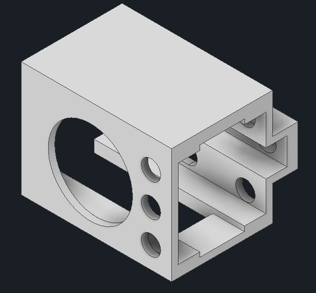

          Here's a link to the files I used for the adapter: https://drive.google.com/drive/folde...Ah?usp=sharing
          The "Simple" one was what I sent to Fictiv. The other has every feature as measured from the aluminum magazine that came with my SMG68.

            My suggestion if you are getting an laser-sintered part made...don't keep the full length pocket that the pawl sits in, and add wings that add some rigidity. Tippmann made it full length so it could be extruded, and it contributes more to the weakness in the part than anything else, and gets directly smacked by the valve.
            • Tominator
              Tominator commented
              Absolutely. Another thing is the giant slot cut out for the magazine spring and its screw. It could be possible to cut a hole instead of that giant slot to avoid removing all that material. Only problem with that is you would have to put the spring and screw in after the magazine. If you designed an adapter to more closely mimic the SMG60 instead, you could have the spring attach to the side instead of inside, which would remove the necessity to have any sort of cut there at all.

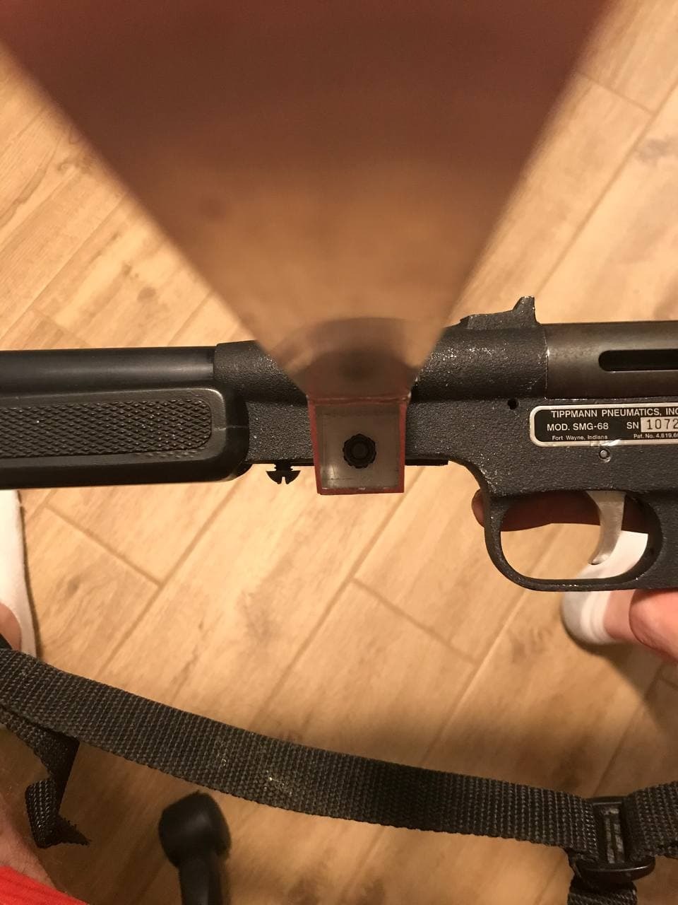

            Had a little fun with it. The aluminum looks much better under a quick coat of spray paint.
