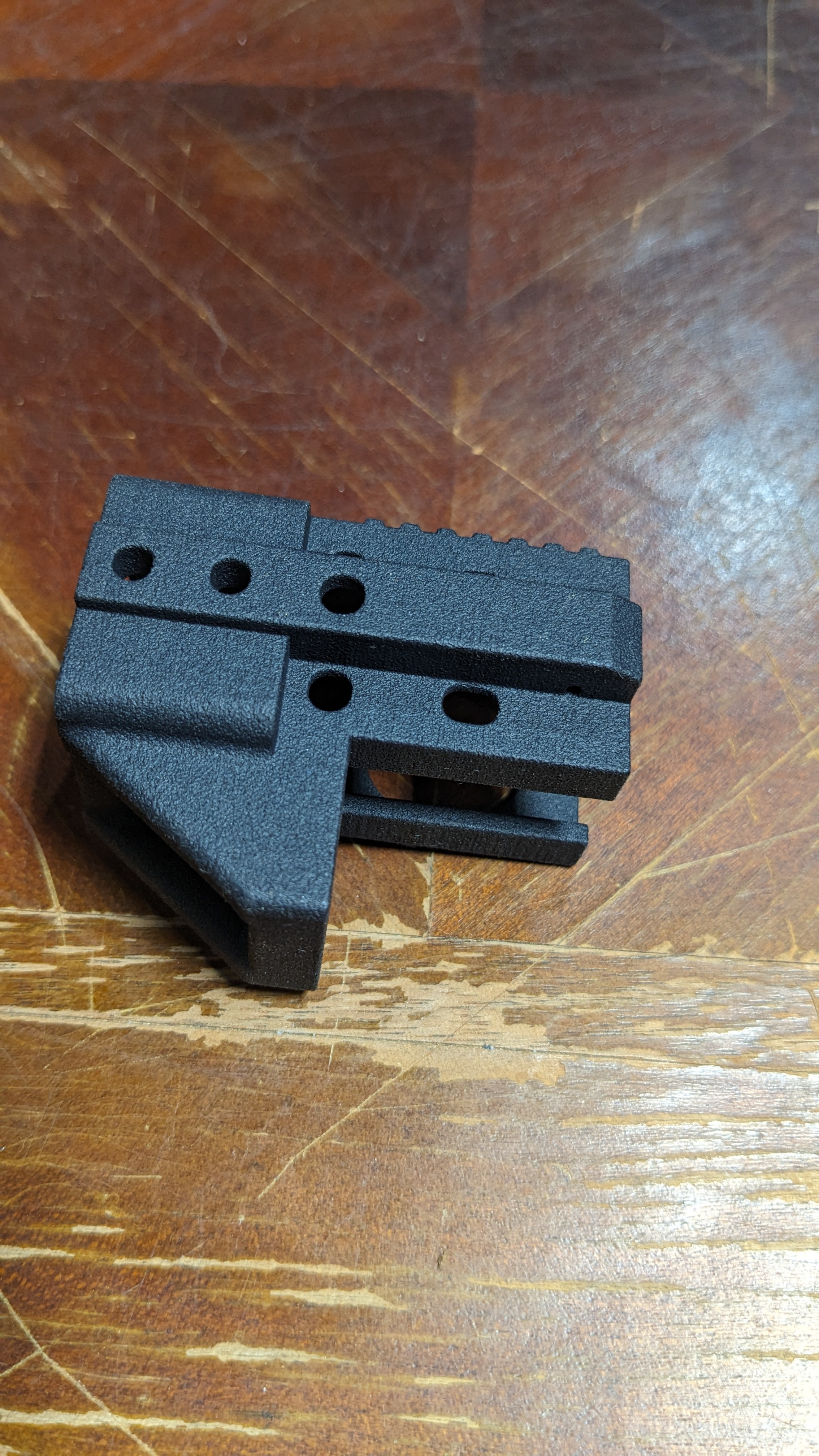

            In case anyone was curious heres the nylon/carbon fiber infill proto.
            I sold the smg68 before I got to do any testing

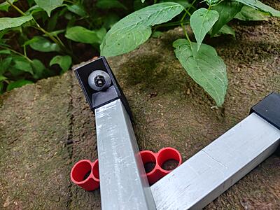

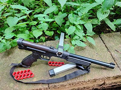

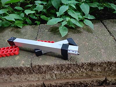

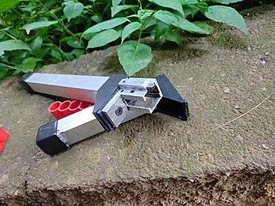

            this is where I'm at with mine. I've made a 10 and 15 round magazine. I tried my hand at brazing the aluminum and just couldn't keep everything square so I just 3d printed a bracket in nylon. It seems like my magazine latch isn't quite the same as the one measured to make the files so I had to drill a second hole. I'm happy with how everything has turned out. I just need to track down an airline, mine popped about 50 rounds into testing.
