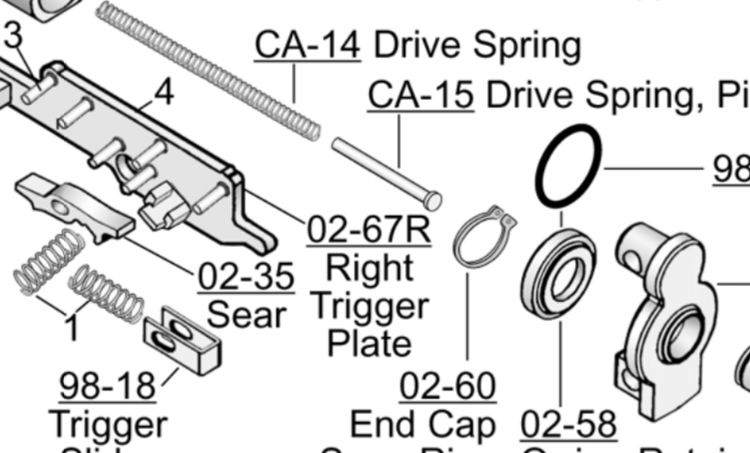

            Here's the configuration of what I'm working with
            Sent from my Pixel 5 using Tapatalk

              Does the hammer move back fully and not catch? Or does it just not go back far enough to catch? Try cocking it without the back cap on and see what happens.
              • Chachi
                aka WildcardPhantom
                • 16
                • Dayton, OH
                not 100% sure, though I'm leaning towards it not going far enough back
