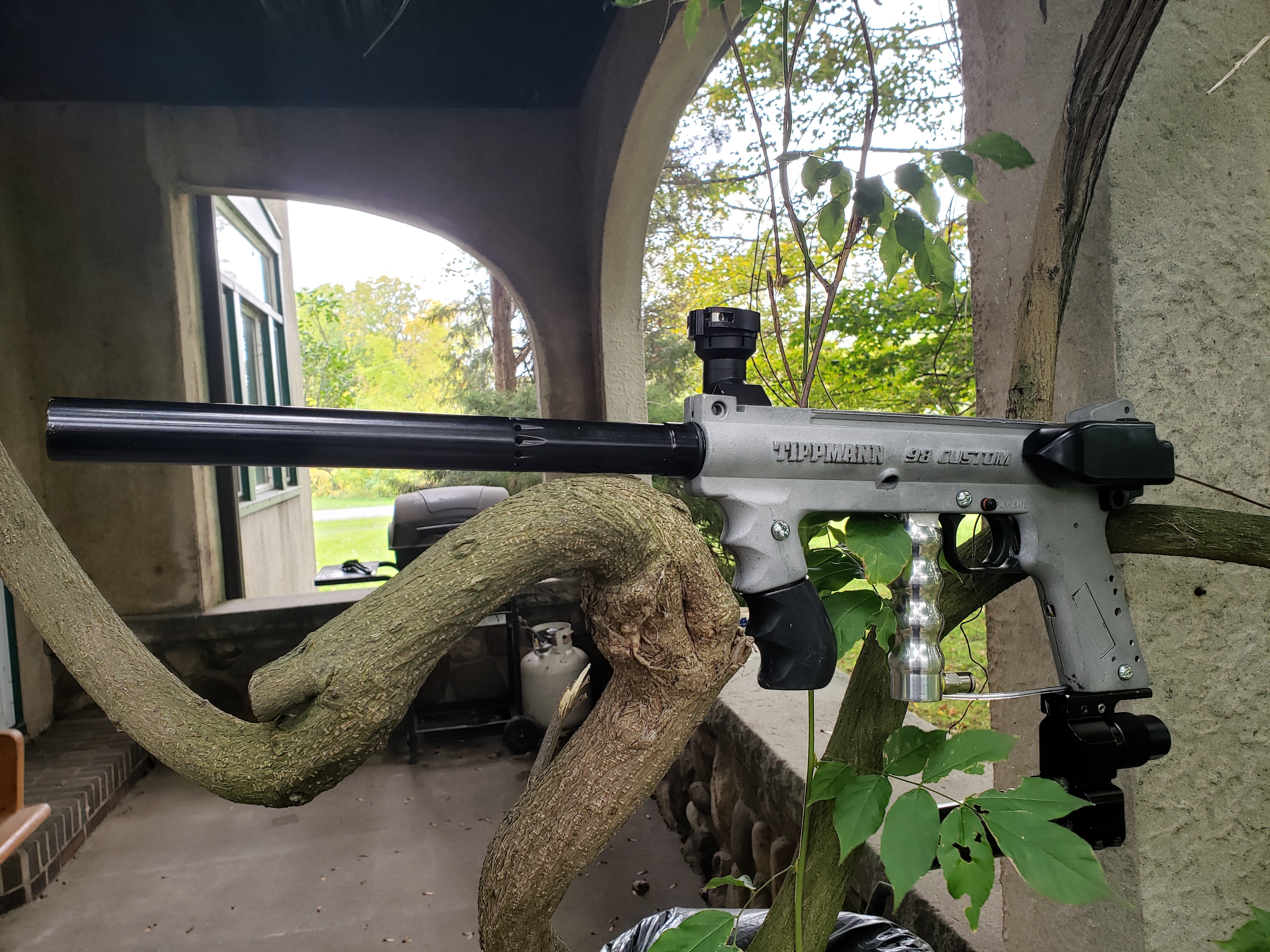

              I glass-beaded my receivers, turned out pretty decent. The paint was bubbled in some spots and totally gone in others - I took it down to bare metal.
              I don't know if I took pictures.
              Edit: found one in my ebolt thread. I could have gone a bit further with the blasting but got it "good enough" for what I planned to do.
              Click image for larger version  Name:	image_20352.jpg Views:	0 Size:	4.08 MB ID:	256128
