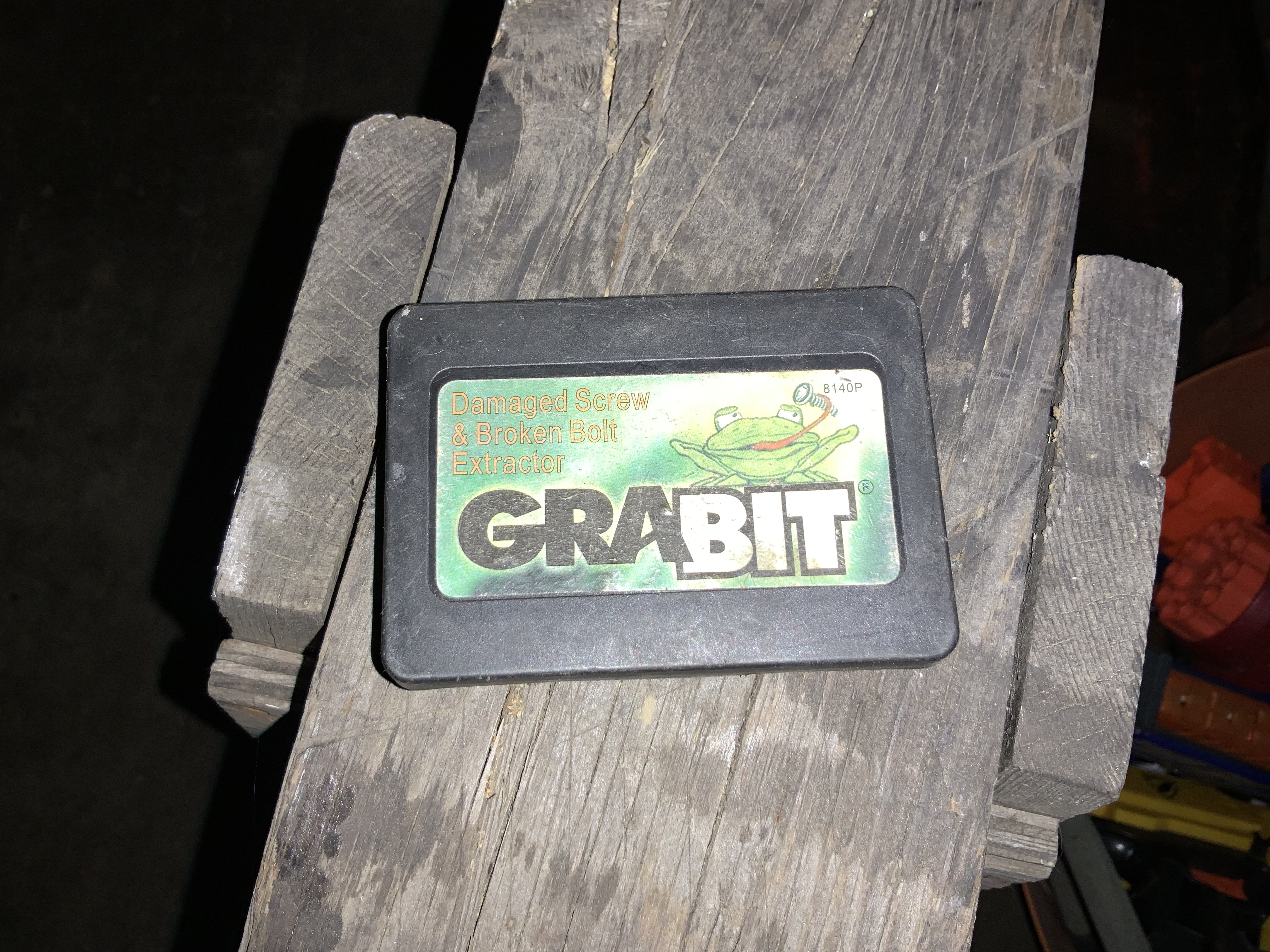

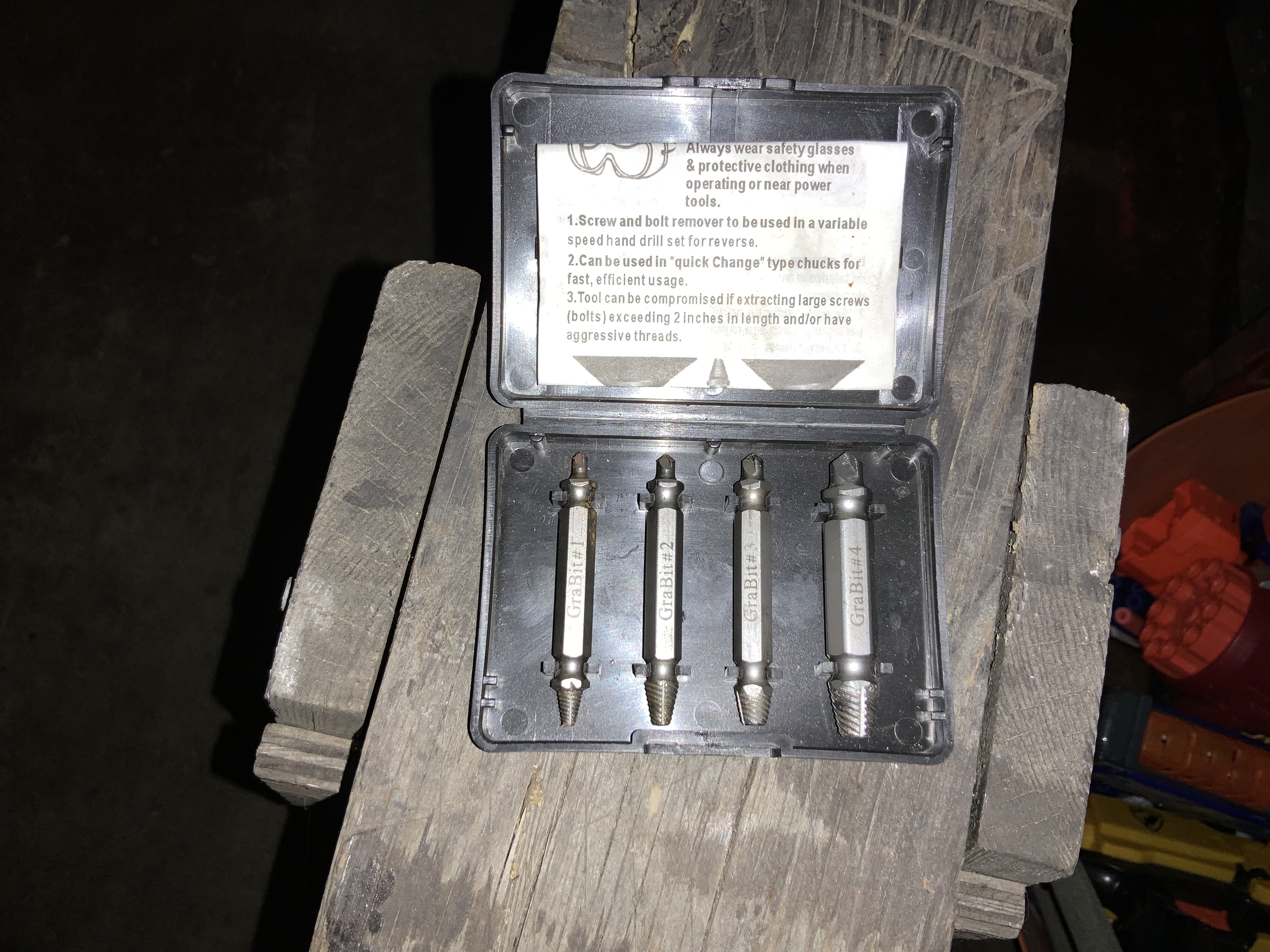

                    • 1153
                    Here’s my extractor set. Love it!
                    My Feedback Thread
                      Cdn_Cuda commented
                      I did try to use a set, not sure if I used them properly though. The material has just too soft and stripped.
