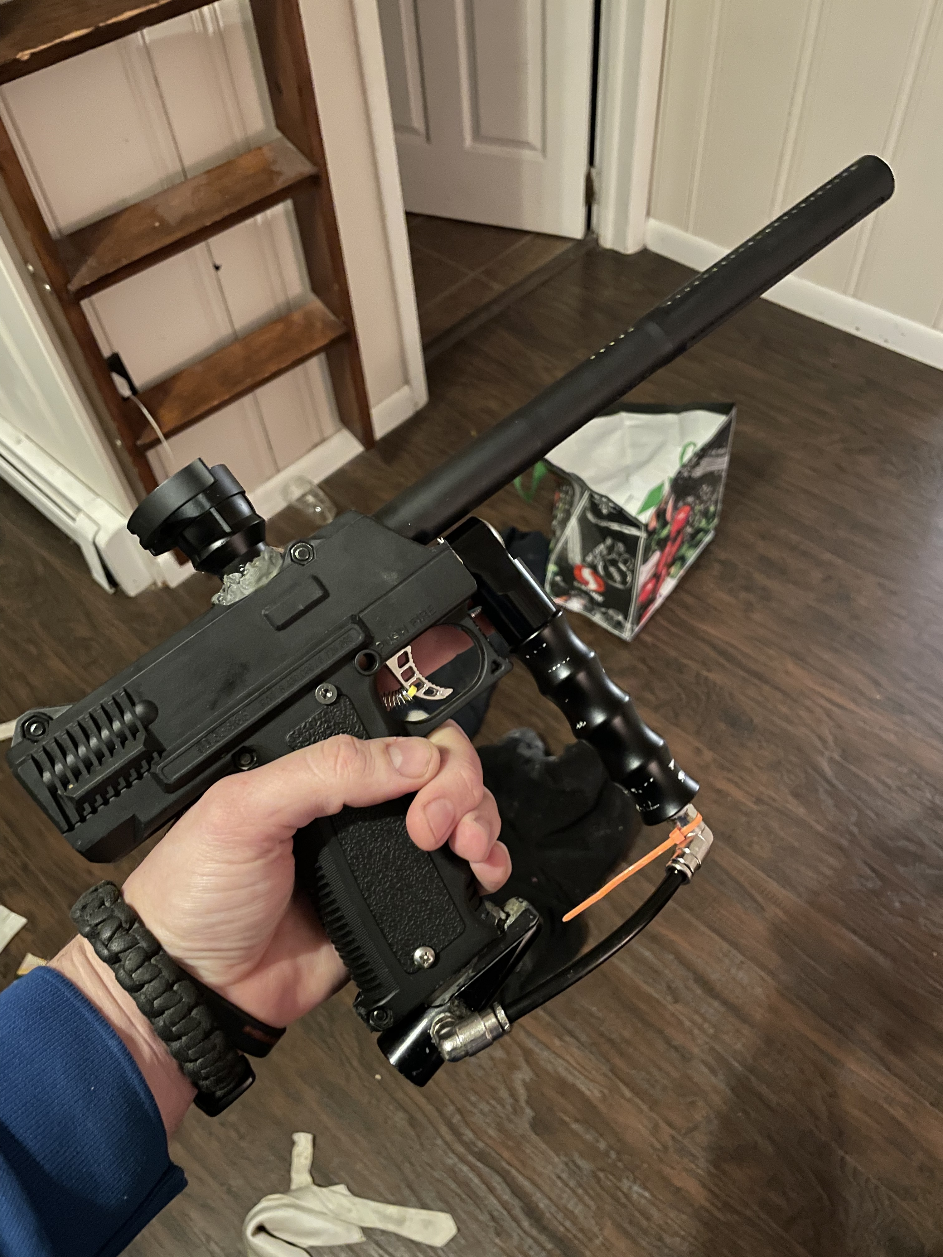

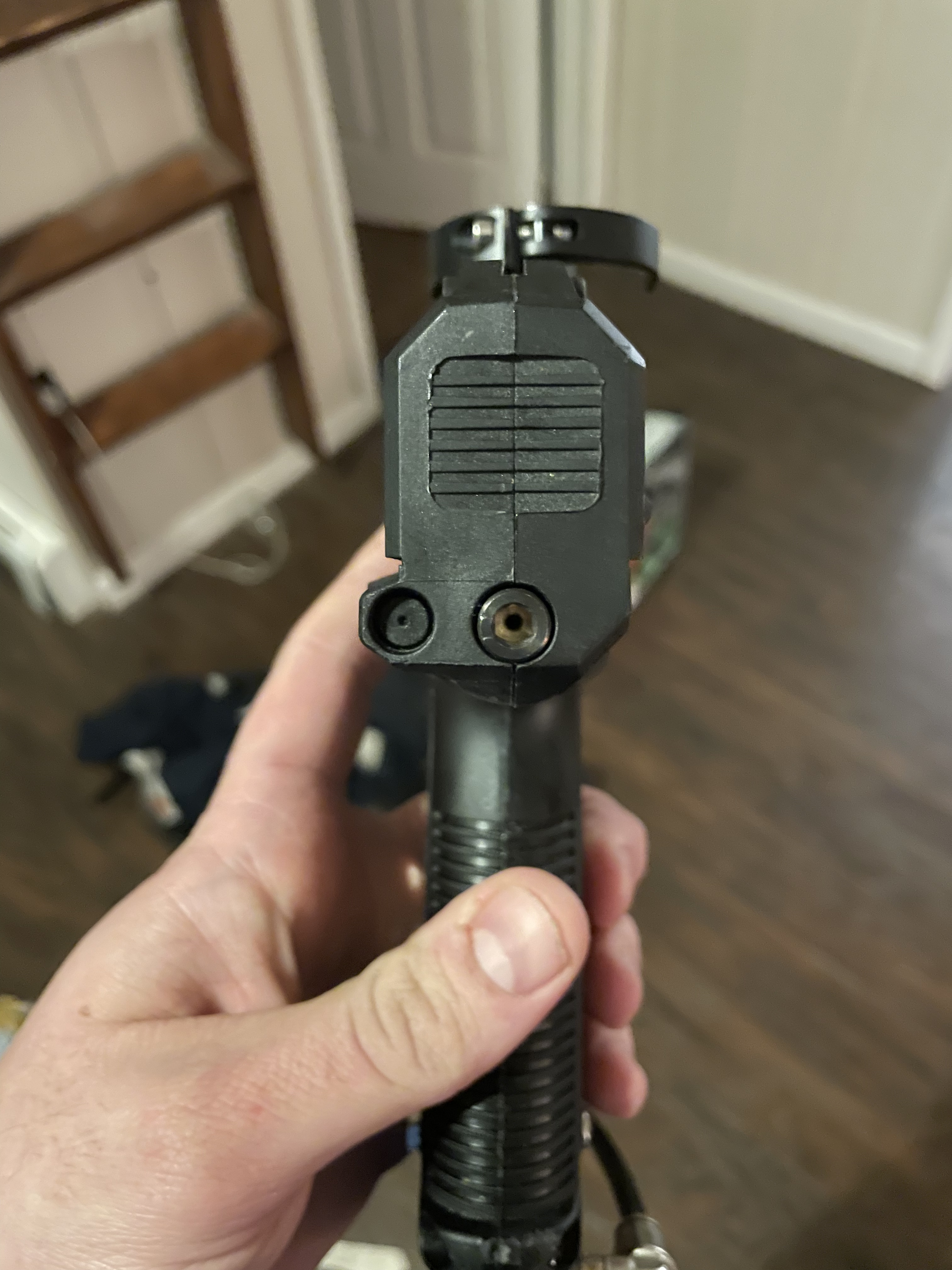

    Leak when the tigger is held from the velocity adjustment. Normal ? Very slight leak.
    • 4472
    I never hold down the trigger on mine when shooting. I can give it a try next chance I getting, if someone doesn’t get back to you before then.

      I couldn't tell you why that's happening, but it would either be coming from the piston oring or the overpressure seal.

        Well yes there will be a little leak on a trigger pull and is only a problem if it doesn’t go away. It not really meant to be held down.
        that velocity adjustment is not a only doing that, it a relief valve using a dual stage set screw(1/8 for the inner one) meant to bleed pressure in excess of 350psi.
        ‘’Insert a 1/8” wrench through the Velocity Adjuster Set Screw (S) and into the Regulator Relief Set Screw (V) and turn it slowly counterclockwise only until air/CO2 begins to escape through the Relief Valve. Then turn the set screw slowly back clockwise only until air/CO2 stops escaping, setting the relief pressure. NOTE: Do not turn any further clockwise which would set it higher than 350 psi.’’

          What did you do to that Tipx!?
            Nice right ?

              Try turning your velocity down and see if it does the same thing. I'm thinking it's that's over-pressure system as well

                Just turning the velocity screw down did that, but is it also normal that there’s a slight puff of air that comes out of that area with every shot? There’s no leaking, but every time I pull the trigger, there’s like a tiny tiny little puff of air that comes out of that screw. So much that I can smell the nitro.
                  Yes it mentioned in the manual that there will be a ‘leak’ at every shot in that area.
                  And yes you did build it for quite compact, I do find it a little ‘weird’ removing it ‘magfed’ option lol.
                    I really did it just to see if it was possible. To drill the reach block add a feed neck and close up the bottom hole. It was more of a challenge to to make it work with a hopper.
