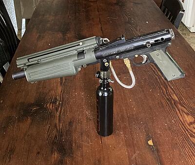

    so snagged a pro-carbine cheap on ebay. recommendations for upgrade that will make it an ok gun to hand to friends.

    All my loaner procarbs are stock. Their reliability is their greatest asset. Does it shoot to velocity?

      Don't know yet, got in today. Have no way to check velocity at home

    A VASA is the only thing I can think of that makes it an easier gun to handle. Maybe a barrel if you want it to be more pointable. Otherwise it's perfectly fine as is.

      Barrel interior definitely looks like it needs a cleaning or replacement.

    A12 or 14 “ barrel makes them easy to point, and makes them quieter from down range. . Can’t argue with a vasa for a foregrip, that’s how I run mine. You can lighten the trigger with springs and modifying the sera and hammer but they won’t last nearly as long. You can find lots of upgrades if you look hard enough but they are pretty rare these days. Rva’s, lightened hammers, Venturi bolts. Not necessary but can be fun to tune.

      So cleaned the barrel with some 99% rubbing alcohol I had on hand. Much much cleaner now.

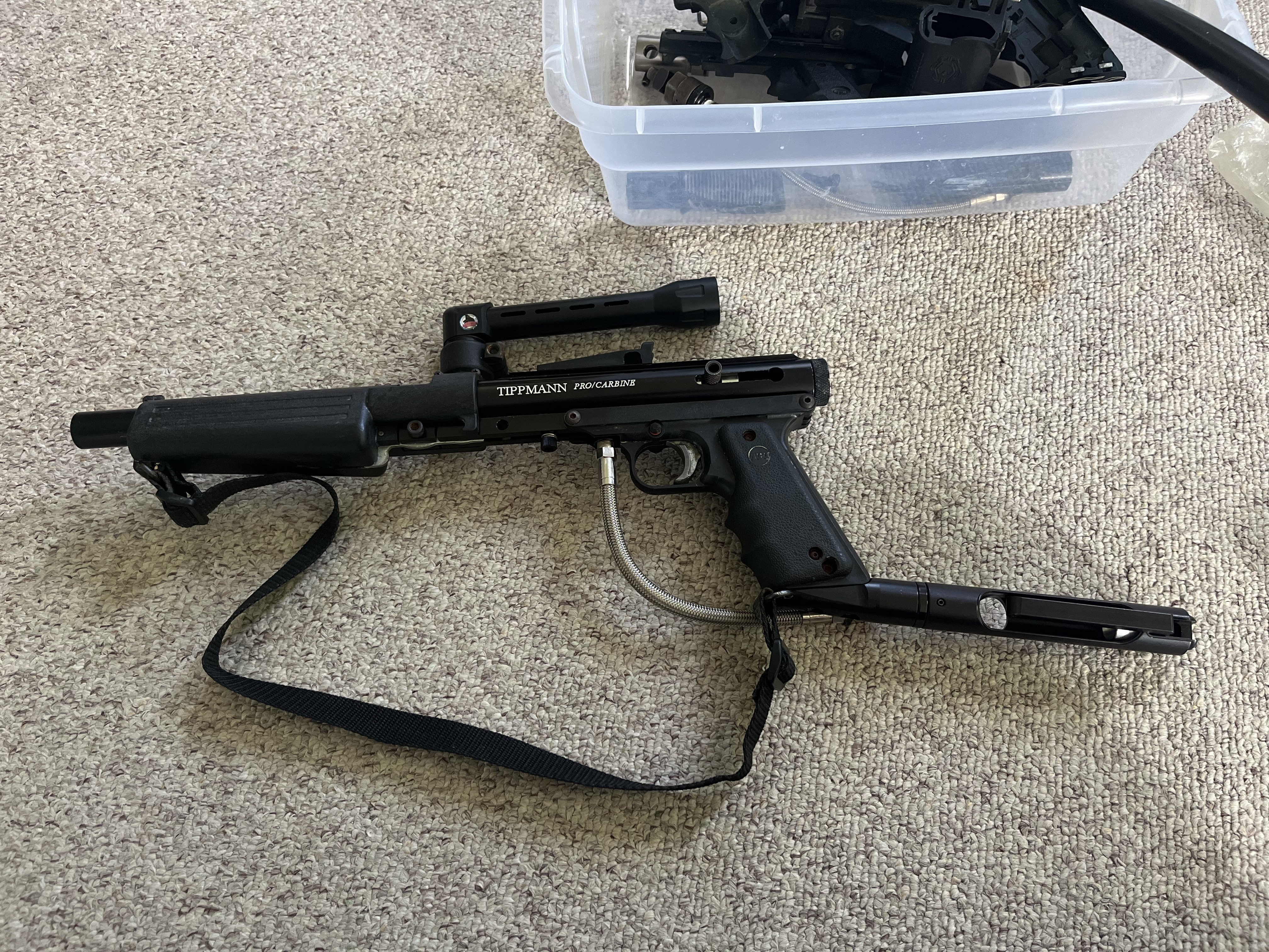

                I put a stock a5 barrel and an ICD lever changer, AC.com stock feed adapter.
                this thing is fun
                280 fps +/- 5
                shoots great and is light

                  How many shots are you getting off a 12ie? I’d guess it’s pretty low

                  I’m getting 19 good shots. Which is fine for recball.
                  I am used to playing stock class or pump with a small hopper. So I don’t feel outgunned.

                    I use a spring feed and a 13/3k, but it’s a prolite so it gets half that on a 12ie lol.

                      Did something similar to this as my introduction to limited paint a few years back. Man I need to get mine back on the field and take a break from pump ha ha
