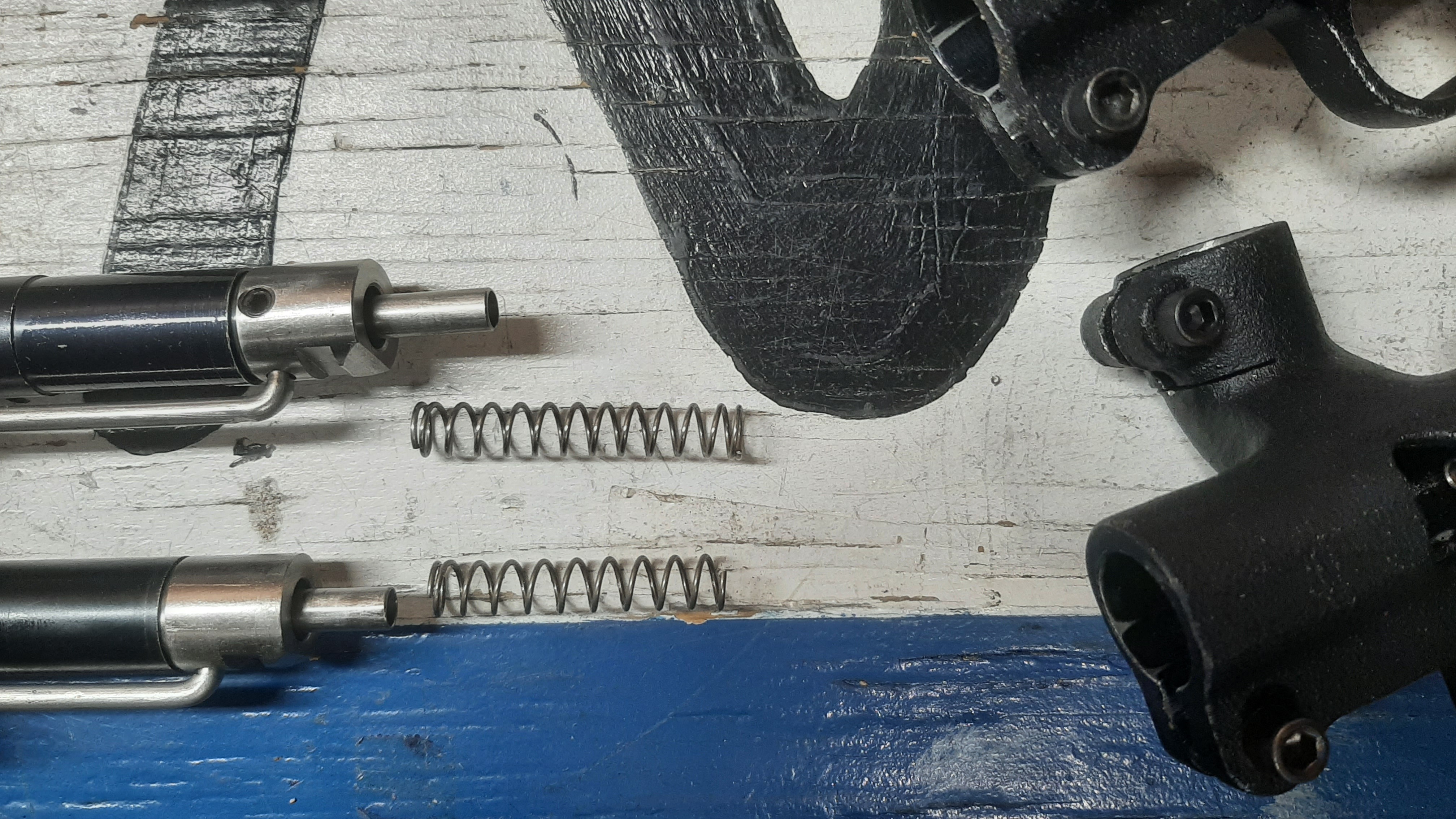

            Got me curious. The springs in these 2 are the same but someone cut the SL1 spring to adjust velocity Click image for larger version

              Hmm, now I’m gonna have to tear down both before I sell off the SL and take pics to prove I’m not going crazy.

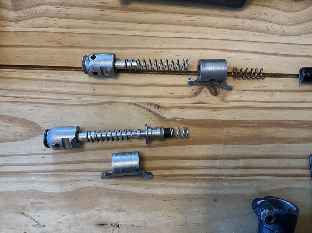

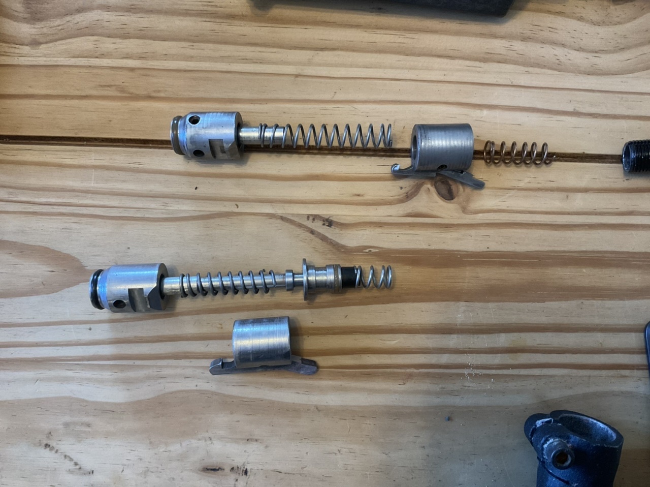

                II internals top: valve spring appears same diameter, but long on the II. Main spring looks longer(I is cut) and slightly bigger diameter.
                I internals bottom.
                Now I’ve got to get this SL68 packed up and shipped.

                  I have a rerelease 2 and the valve spring is much shorter than what you have pictured. Probably similar to the one you have pictured in your 1.
