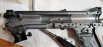

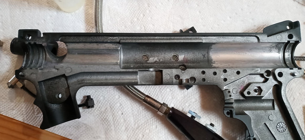

    I have an older 98 Custom that I just outfitted with a response trigger. It is the first Tippmann I have ever owned or had opened-up. I cleaned, polished, and lubed everything while it was apart. It has the old power tube with no provision for an RT or Cyclone banjo screw; I drilled and tapped that post on the PT and milled just a hair off the face at the same time so the threads and banjo sealing surface are perpendicular. There are no leaks. Tank is an HK 48/3000. Marker worked normally before the RT install.
    When I got it back together, it would just burp like the tank was low, which it wasn't. I had to turn the velocity screw out several turns to get it to cycle properly.
    Is that normal/common or is something not right?​

          1) did you oil it when you put it all back together?
          2) you mentioned polishing, describe what you did
          3) shove a barrel swab down the barrel, will it recock with that in the barrel?
            4) did you happen to install a flatline when putting it back together?
            I doubt the problem is in the RT itself, the one thing I could see is something happened when you drilled the tube. If there's too much air leaving the system it can have issues recocking.
            Turning the velocity screw out and it working better is odd. Typically it's the other way around. If the velocity screw is too far out it allows too much air to leave the system and doesn't have enough back pressure to recock. I've had a few times where turning it in was needed to make the marker recock
            5) Have you chronoed it yet?
            1.) Yes.
            2.) Click image for larger version
ID:	485928 Just enough 600 grit wet sanding to take the overspray off where the bolt and hammer slide, then polished with 2000.
            3.) I did not try that. Increasing velocity got it to cock and the RT working and that's where I stopped messing with things. It technically works now, just didn't seem right having to wind the velocity screw out so much.
            4.) Not a Flatline, but an Apex.
            5.) Not yet.​

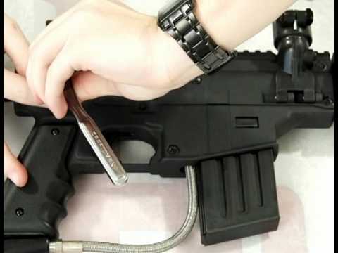

                    Here is a video showing how to tune a RT on a Project Salvo, essentially a T98C in BDUs. At about 3:36 it talks about tuning it.
