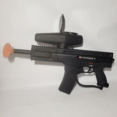

        These were the same as the a5. BNIB. .
        NEVER USED. SEMI-AUTOMATIC. 68 CALIBER. THIS IS NEW AND IN THE BOX. MADE IN USA! TRYING TO DOWNSIZE!
