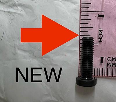

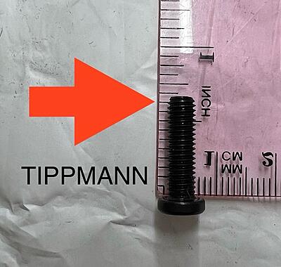

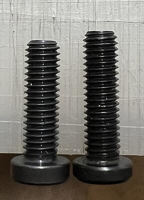

            OK, so the screws I ordered at 5/8" aren't a full 5/8". The original Tippmann screws are slightly OVER 5/8" (basically 11/16"). Also, the new screw is 3/32" drive vs the 1/8" for Tippmann. The arrow in the pics is pointing to the 5/8" mark.
            At this point, not to sure which way to go at this point?! Thoughts?

              • 4422
              Go the next size up and trim? Or buy Tippmann OEM stuff?
              Also worth mentioning some industry trade screws go off entire length of bolt not length of threads
