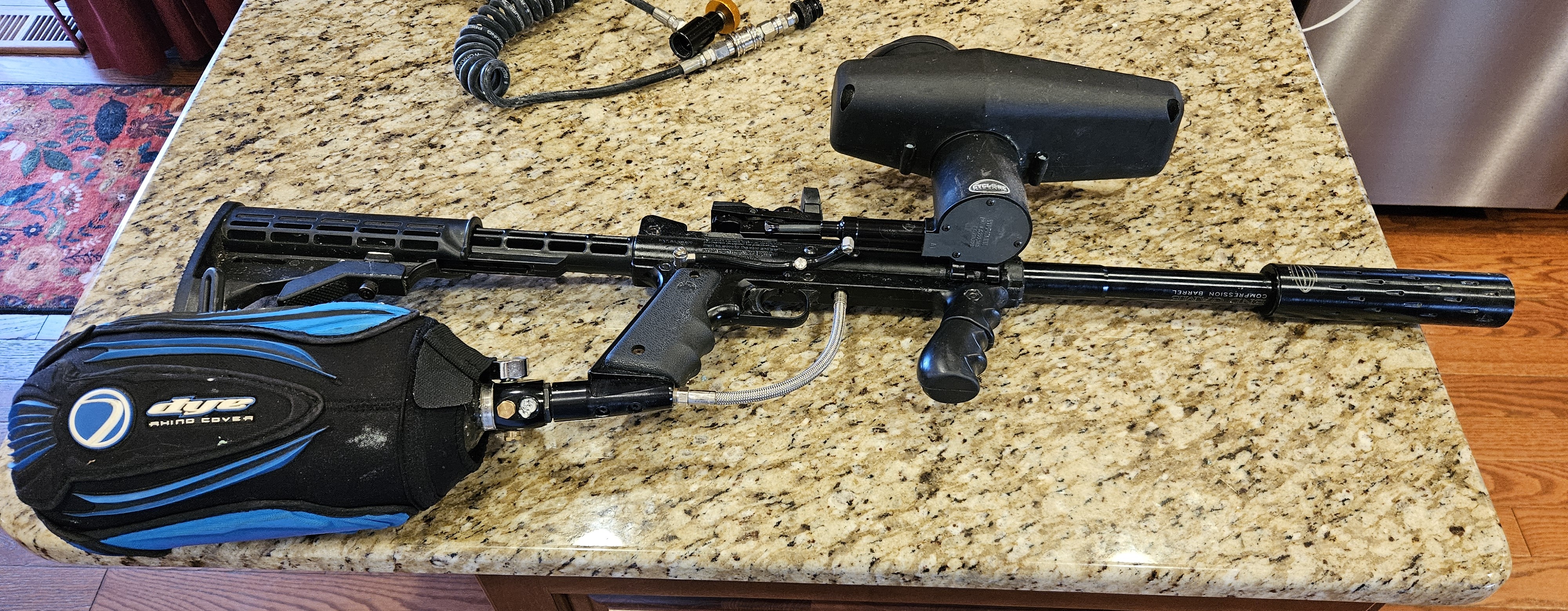

    Tippmann 98C rebuild kit
    Last time it was used was when my son was 10...he is 25 now.
    Actually, my son went to use it when he was 18 but needed to get a rental as he said pbs just fell out of the front.
    I understand there are just o-rings in it... But is there a kit or listing of what is needed for a full rebuild? Will follow up once working again with upgrade tike..if any are recommended.

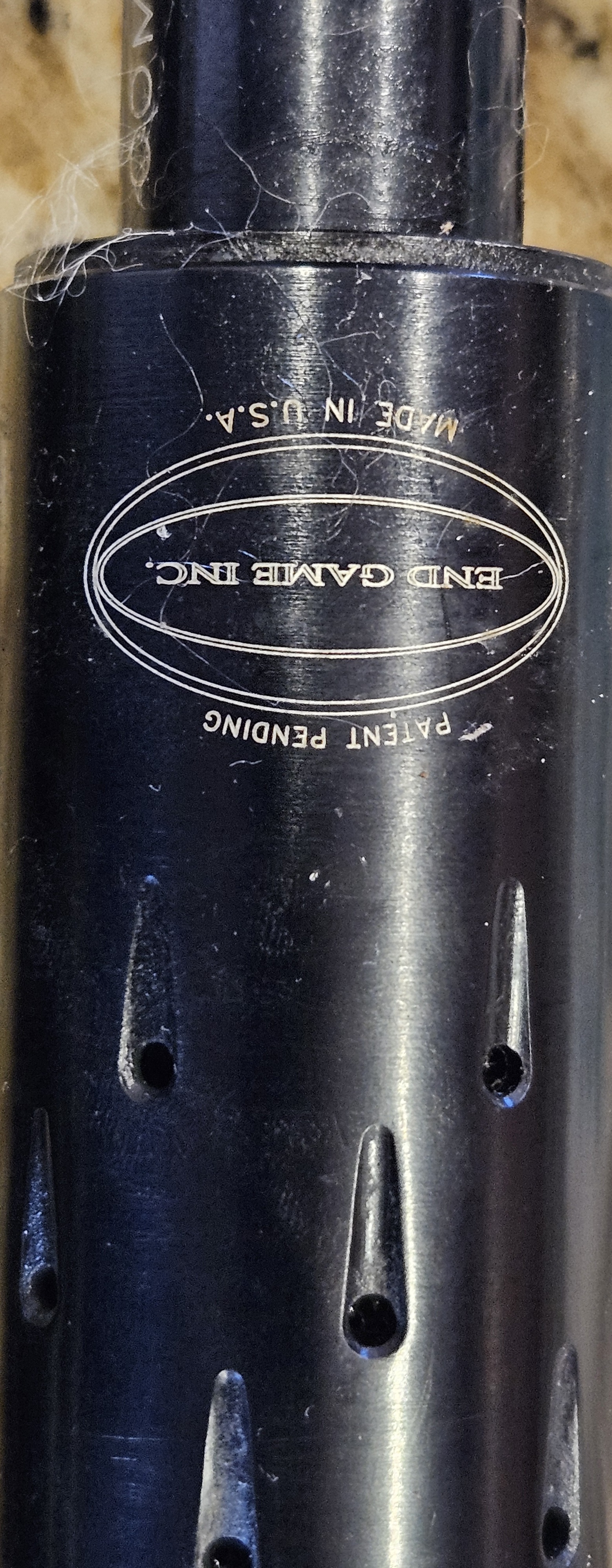

    98 custom End Game Compression barrel - awesome upgrade

    Quite honestly. I bet a new ball detent, and a good cleaning gets it shooting again.
      • 6380
      Yeah there really isn’t much to them. Good cleaning is probably all it needs. Might even get away with putting a few drops of oil in the Asa and cycling it through with some air. It likely just needs a new detent they are easy to find.
      That tank is likely going to need to be hydro tested or might need to be replaced depending on its age.

        ok so is this what I need then?
        I bet a good cleaning is all it needs and yes I didnt know what holds the pb in as my son said they rolled out... so yes.. "detent".. cool. didnt know the name.
        so this?
        Amazon.com : Captain O-Ring – Replacement Ball Detent Latch for Tippmann 98, A5, X7 FA-18 Ball Keeper (6 Pack) : Sports & Outdoors​
          • 6380
          Yup. Likely your getting ball being forced down past the missing or stuck down detent. If it was stored for a long time without the hammer locked back it pushes the detent down and it loses its ability to hold balls back before firing you will get rollouts especially with a large bore barrel. Today’s paint is small (.681 small) lots of Tippman barrels have larger .689 barrel bores. So if your detent is shot they will just roll right out.
          Replacing the detent give it a good cleaning is likely all it needs. Few drops of marker oil in the ASA after cleaning put air to it and cycle it through. I bet that thing shoots great for you again. If you can find a smaller bore barrel or barrel back that works on your current barrel you have you might see even better performance. The barrel you have is a cool barrel I would try and find like a .682 to .681 adapter that fits in between your marker and barrel.
          But start with the detent it’s likely all you need.

            I concur. Clean thoroughly(ish) and replace detent before doing anything else. Make sure you place the detent in the correct position (the finger sticking up should match the contour of a ball in the chamber)

              Hell I can put you together a rebuild kit if you want. I have all the o rings and the detents as well

                Clean, oil, then shoot the gun. Only replace orings it if needs something. Nothing wrong with procuring a rebuild kit though.
