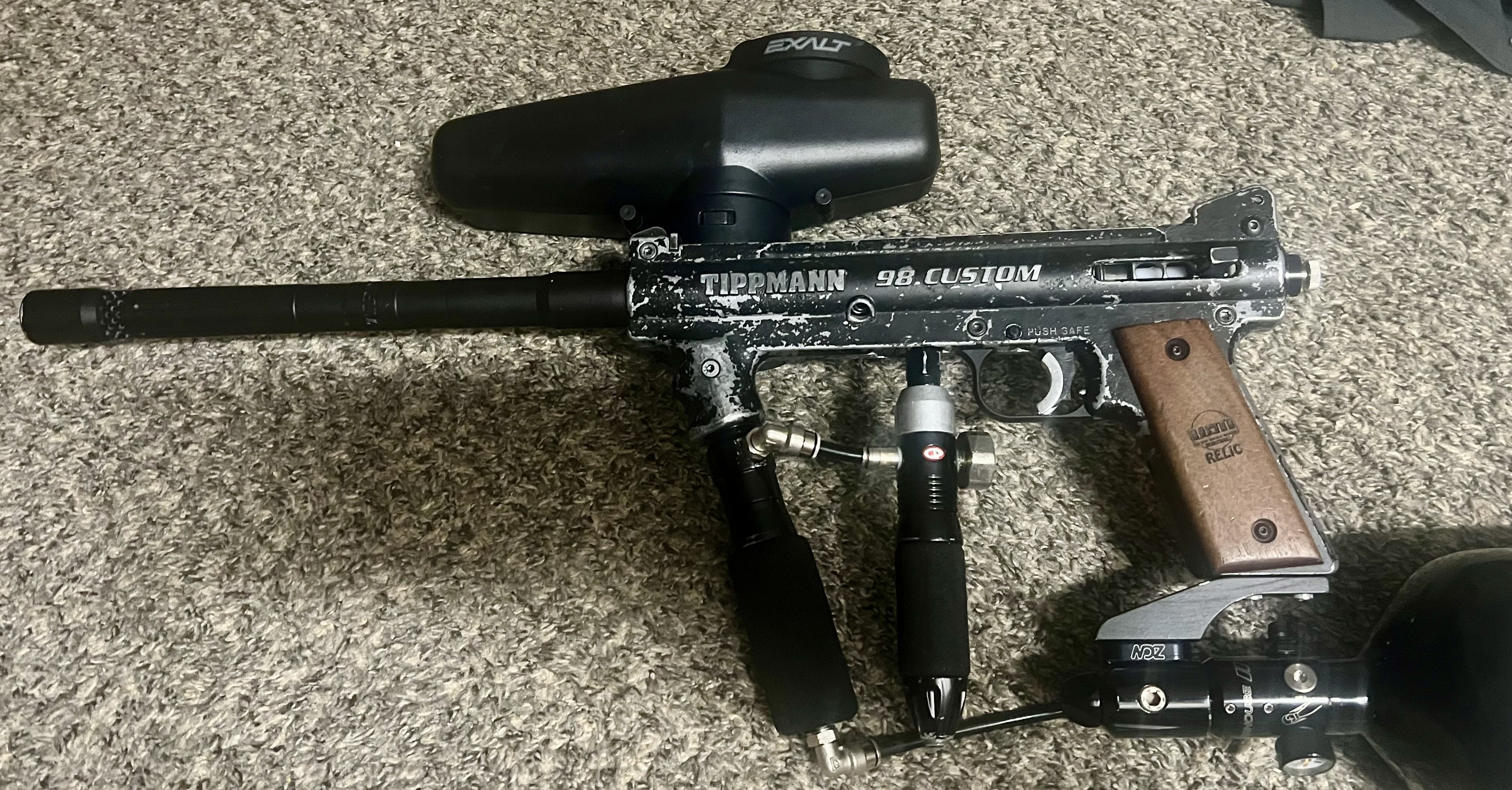

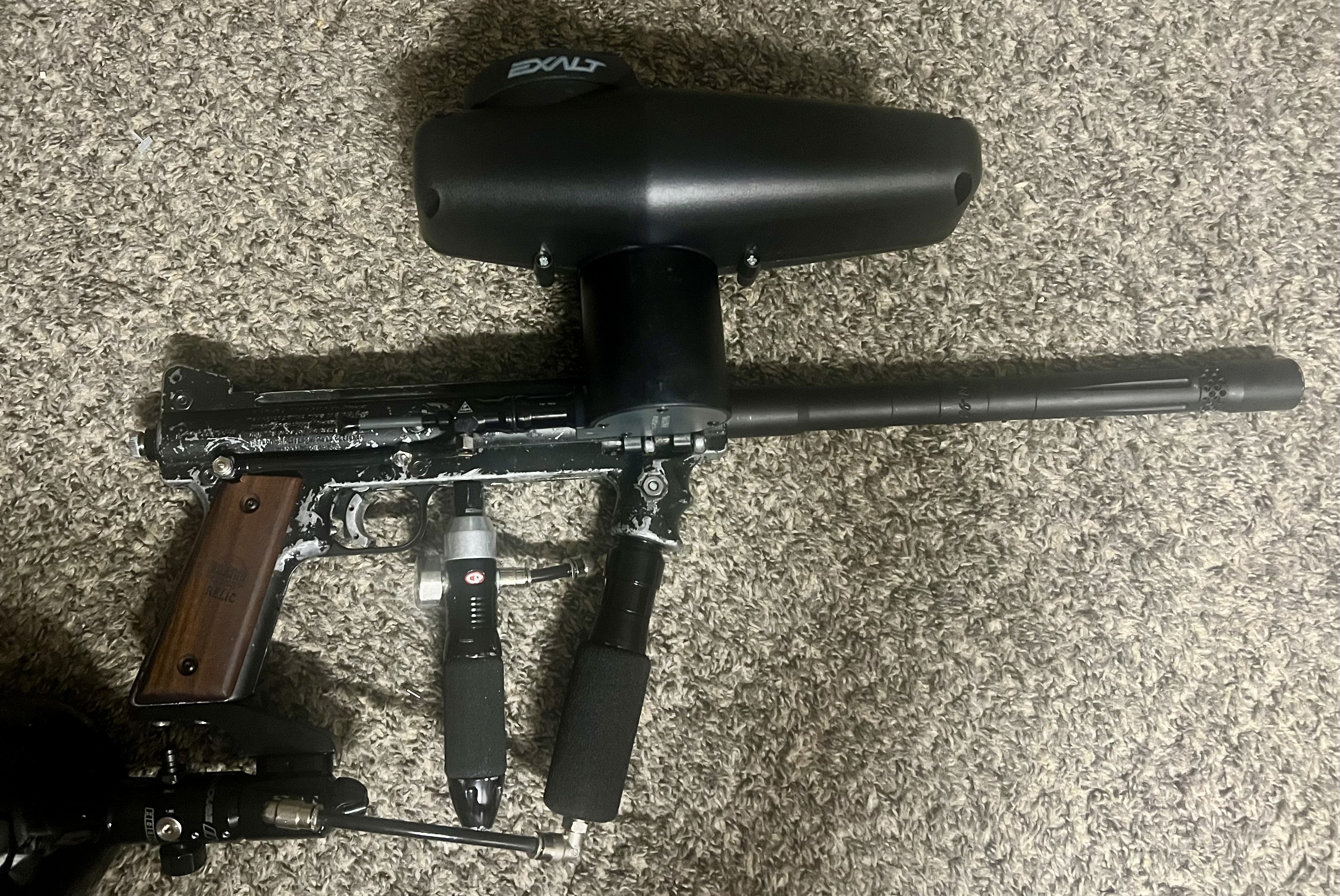

    So I made some changes to my 98 and I found out some interesting things. In the pics I’m running x2 gas thru but initially I was running a V3 Custom Products reg. When I aired it up I found out quick that there is a limit to the amount of volume the 98 can take. At 500psi (CP reg wide open and a Ninja UL) and a stiff spring I blew the O ring right off the hammer. I do have the stock VA turned in flush with the powertube and loctite’d in. I did this to increase blowback so I wouldn’t be battling it while I experimented. Also, I had to turn the RT flow control down a considerable amount to get it to function. It was getting way too much air and the piston was harder than a witch’s titty in a brass bra in an snowstorm.
    Eventually I had to drop down to the lightest main spring I have to get it to cycle. I also had to drop the pressure using the CP to around 300. It’s now getting fed with a Powerhouse Hook @ 450psi. I tried a Ninja SLP (gauge was reading 270-280ish) and while it would cycle the RT was having issues with shoot down. 300 seems to be the sweet spot. With the RT off and no Cyclone it was shooting very well around 200-250psi.
    I was happy with the results but not the look. I took off the CP reg and I’m thinking I’m just going to try and use the Hook solo. I really like the look with the AGD and Dye gas thru grips. If I have problems with shooting hot I can use the RVA to take some tension out of the mainspring and that should fix it (I hope)
    If that doesn’t work, does anybody know if there is a lighter mainspring than a blue RAP4 (or Warrior, I forget which)? Also, that 90 feeding the straight fitting, how restrictive is that? Would it be worth it to go to a 45?
    Also, my Crossover needs a gas thru and eventually I do want to put an inline on the 98. I want a Sidewinder long with finger grooves but I also have an opportunity to get a Gladiator Gen 2. Which do y’all think would be better? How long is a Gladiator? I don’t want anything shorter than my volume chamber set up.

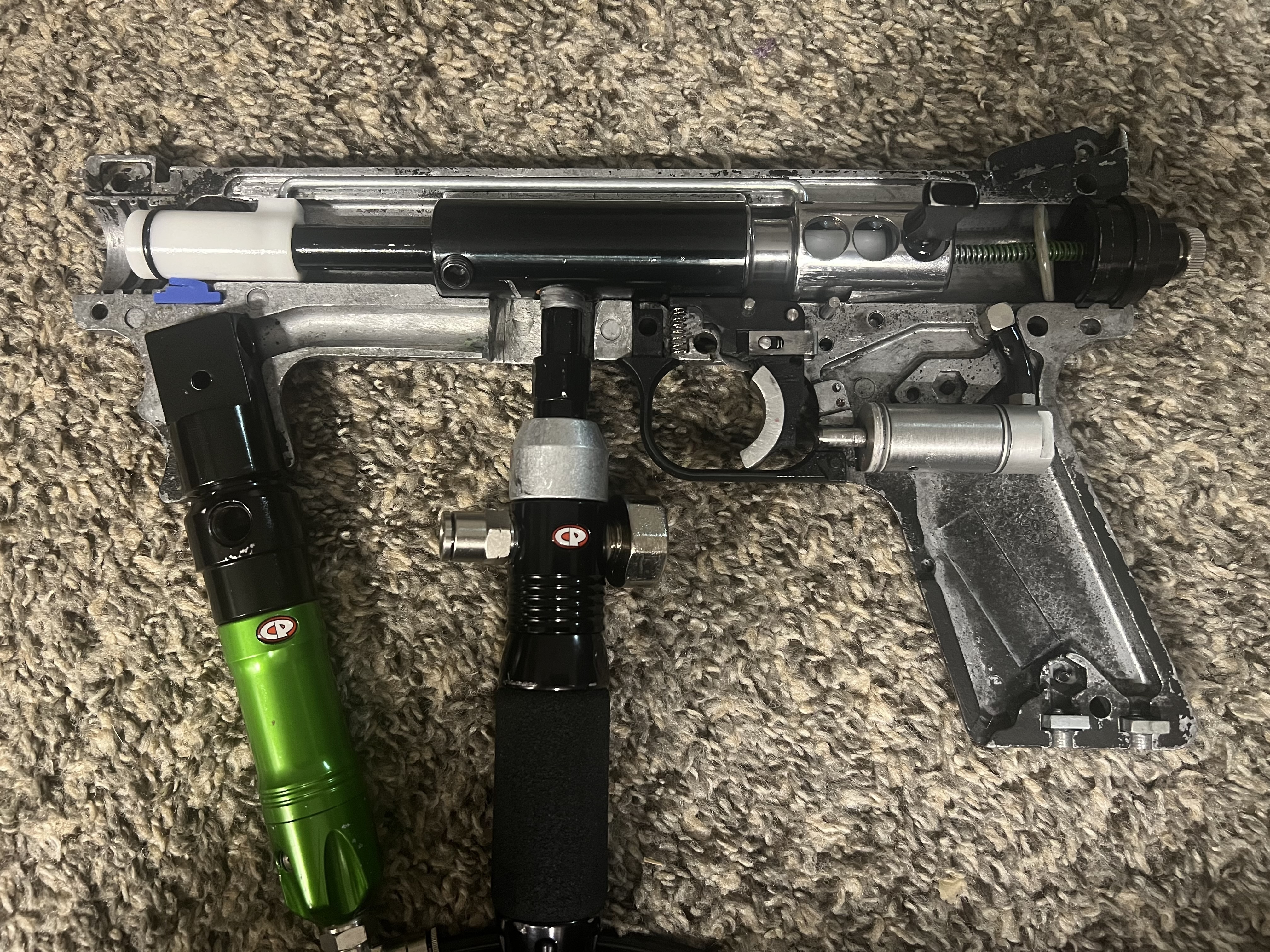

      I thought about drilling but I’m not sure I want to yet. Instead I’m going to try to create a “blowback assist” using the stock VA port. Basically run a flow control knob and needle valve to a drilled and tapped section in the power tube where the hammer meets the valve stem.
      Everything I’ve done so far
      polished internals (I also filed and polished a lot of little sharp/rough edges on the feed port on the marker itself and the cyclone. Also the tip of the neck of the aluminum power tube. I noticed the power tubes in general are pretty rough and that’s why some people may have problems with inner O ring front bolts. Sanding down seams and filing away rough edges and then polishing the neck corrects this.)
      Shocktech Superfly front bolt
      RAP4 aluminum power tube
      Warrior valve with TechT valve spring
      TechT Zero Kick hammer with inner weight removed
      Lapco cocking knob (half the weight of the stock knob and added a smidge of weight to balance the hammer)
      Blue main spring (lightest spring)
      RVA
      TechT trigger and sear pin (1 and 0)
      clicky pen trigger spring
      1 trigger washer (removed trigger wobble)
      filed down stock trigger with an aluminum trigger shoe
      RT and Cyclone with 1/8 hoses and fittings
      All Cyclone stuff (QEPH, squishes, etc)
      Powerhouse Hook tank reg
      AGD gas thru
      Optimus gauge adapter (Repurposed to air delivery. Removed stock gas thru screw and put in a shorter solid screw)
      BT vertical adapter (Only vasa used. Tube and 90 fitting not used. Sealed with JB weld)
      CP gauge adapter (Repurposed for air delivery)
      Mastersconi mini cocker vasa
      Aeroflow 1/8npt thread extender
      Dye GT gas thru (Volume chamber. Sealed with 1/8npt plug)

        A pic of the inside. I think this is the most up to date. I’m not using the CP reg currently

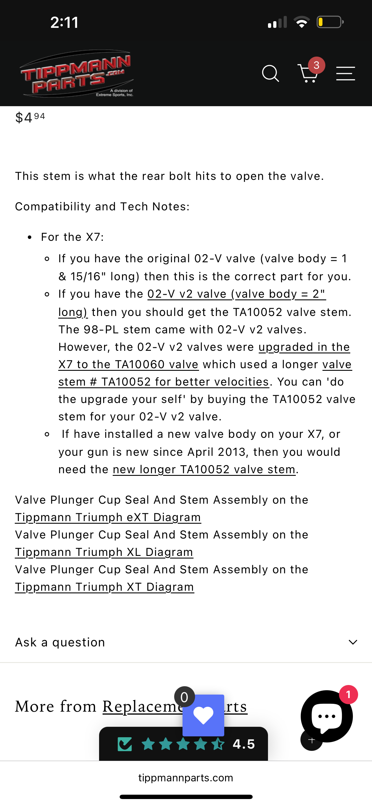

                            Ah, so that makes sense about the X7 and the Phenom. The Phenom operates on 300 psi NOT the X7. Good to know.
                            So this is the stem I’m talking about. TA10052. So now I’m thinking that the Warrior valve I put in is a 2” valve right? And it came with the TA10052? The stem is noticeably longer than my stock stem.
                            So the 2” valves offer better velocity according to Tippmann, if I’m processing this correctly.
                            • FlightMedic938
                              • Feb 2023
                              • 440
                              Here’s the description
