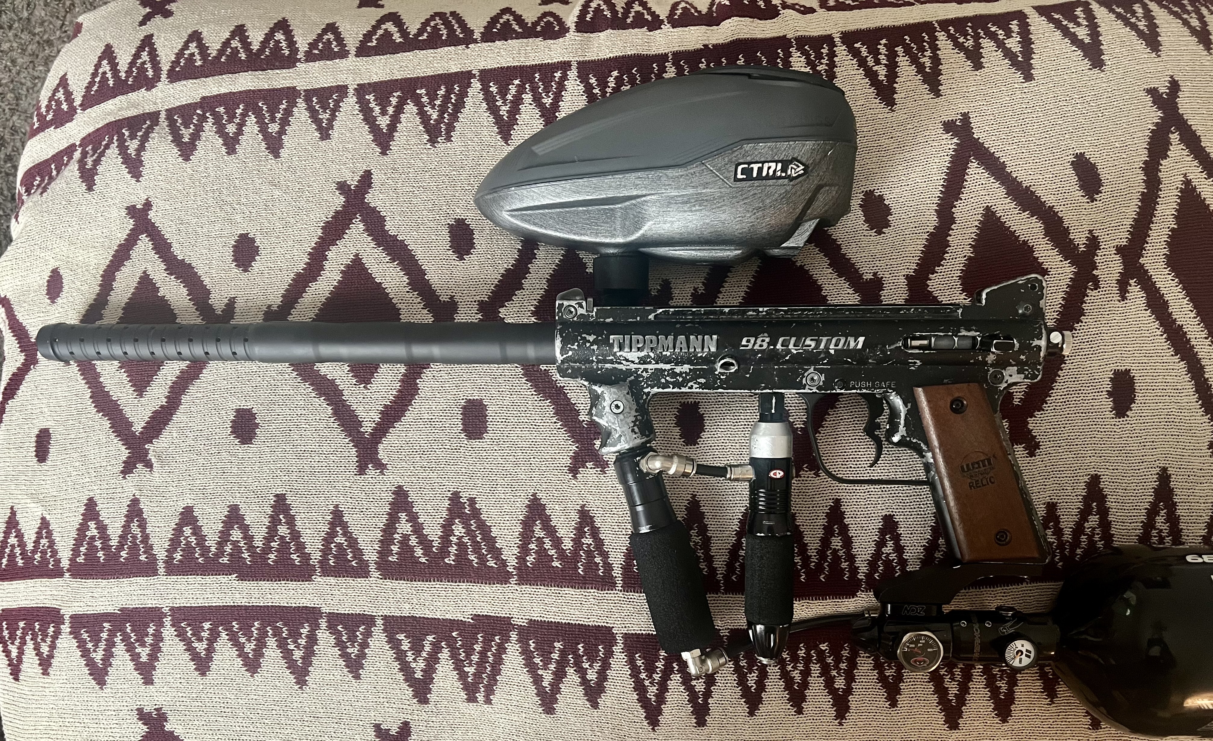

            Here’s a pic of it. I have a centerfeed I need to put on. Last thing I need is an aluminum double trigger guard. If anybody has one FS please DM me.
            I might paint it or may leave it as is since I’ve had this for 26 years now. Undecided on that.

              Did you mod the LP kit to run that reg directly? I’m pretty sure that’s a detriment. An air reservoir directly connected to the valve will be more responsive and better flowing than a reg valve. That’s why paintball manufacturers never put a reg right up against the bolt and, why there’s something like the firechamber behind the bolt (even in the automag).
              What’s the deal with that Warrior Valve? The only description I found (via ANS Gear) is that it’s a standard drop-in replacement (meaning meant to run at 850ish PSI). The picture looks to me that it uses the standard depth and width grooves (I can’t tell about the valve pin and valve spring).
              If you run an HP valve (incl. spring and pin), with all of the other LP kit components, while feeding the gun 400FPS:
              • Velocity will be lower due to not enough 400PSI air making it around the outside of the valve and out the powertube fast enough.
              • The stronger valve spring may further reduce the valve dwell and further reduce velocity, while also not likely opening up enough to properly cycle the cyclone or, response (they don’t rely on the LP channels or the blowback aperture but, the dwell might not be enough).
              Running an HP valve and the rest of the low pressure kit components at high pressure (800ish) should work but, the response kit and the cyclone may be too violent due to the higher flow rate accompanied with higher pressure. Velocity should be fine but, blowback may be excessive.
              The hammer looks to be the correct design but, the original did not allow for any adjustment of the re-cocking spring. I’m not certain but, I think the LP kit spring was lighter since the hammer is lighter and the valve spring is lighter compared to stock. If you're running the hammer spring tighter, and the blowback pressure is high enough, that might present too much resistance and, cause the hammer o-ring to get blown.
              This is all based on my experience of starting with a stock 98C, switching to the Low Pressure kit and, the E-bolt and then settling on the LPK and, the response trigger. In that time, I even modified a low pressure valve to disable blowback (not needed for E-bolt). However, it's been a long time since I've had the Tippmann (I sold it to another forum member before the forum takedown).
              • FlightMedic938
                FlightMedic938 commented
                There are 2 air reservoirs. Pre-valve and directly in to the valve. The pre-valve feeds the direct valve.
                I’m really not sure. I bought it because it looked nice. It does have a TA10052 stem though, I confirmed that. It performs great. Inside the valve I have a lightened valve spring and a smaller valve plug. I got it on a chrono the other day and was shooting hot @ 290-305. That’s with the lightest spring I have turned all the way in with the RVA. I was able to back out the RVA and get it to 270-290. Most shots were within my target range of 270-280 but I’d get hot first shots. So consistency is the goal now. I’m sure the answer in an inline with lots of volume but I’m going to try and find and even lighter main spring to see if that’ll do it first. Another possibility is using a heavier front bolt like a RAP4 aluminum. It weighs x3 more than the stock front bolt. I’m going to try that as well.
                The hammer I’m using is a lightened hammer. A TechT Zero Kick hammer. The Tippmann LPK hammer spring is very light so if I can find a similar tension that would be great.
                Thanks for the feedback. Did you like the Ebolt? I’ve occasionally bounced around the idea of getting one in my brain

                That's a CP reg mounted in the vertical (non-foregrip section) adapter right?
                I can't remember for certain but, I think the LP Valve pin had a different profile than the stock (narrower in the open position, IIRC). I don't remember the length or weight being different.
                The setup you have now seems to be entirely on how you have your spring/RVA setup (increasing your dwell), which isn't ideal- your reg should be more consistent.
                Honestly, I loved and hated the E-bolt. I wasn't able to get the official Tippmann model and, I got the psychoballistics model. The included piston wasn't really built well, and was a bit of a challenge until the piston (the tail end of the shaft where the o-rings inteface with the cylinder). It was also only really a partial solution. There's no reason why an E-bolt should have a main valve with blowback. The piston (hammer end) was non-sealing so, a bit of air is wasted on every shot. I had it running at around 300PSI (after modding the valve) and I loved the reaction I would get from the other walk-ons. In the end though, I loved the response trigger more- it just works and, tuned properly is effectively full auto (for fields where that is appropriate).

              uv_halo I understand the confusion now. The CP part you are seeing is not a reg. It’s a hollow extender that CP made so you could add a gauge if you wanted. It’s like the old Lapco dual air source adapter.
              The CP gauge adapter is attached to a DYE gas thru grip on the bottom and a Shocktech mini cocker VASA on top. All of its hollow.

                I get it now. That would explain things. What are you using for a reg then?

              #23
              uv_halo Just the Powerhouse Hook tank reg @ 400 psi

                I might be missing something but I'd consider swapping the factory bolt back in. That o-ring placement isn't inspiring confidence. The factory one was perfection.
