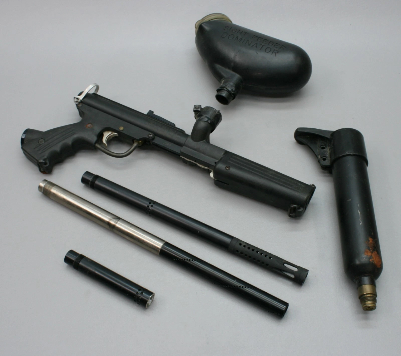

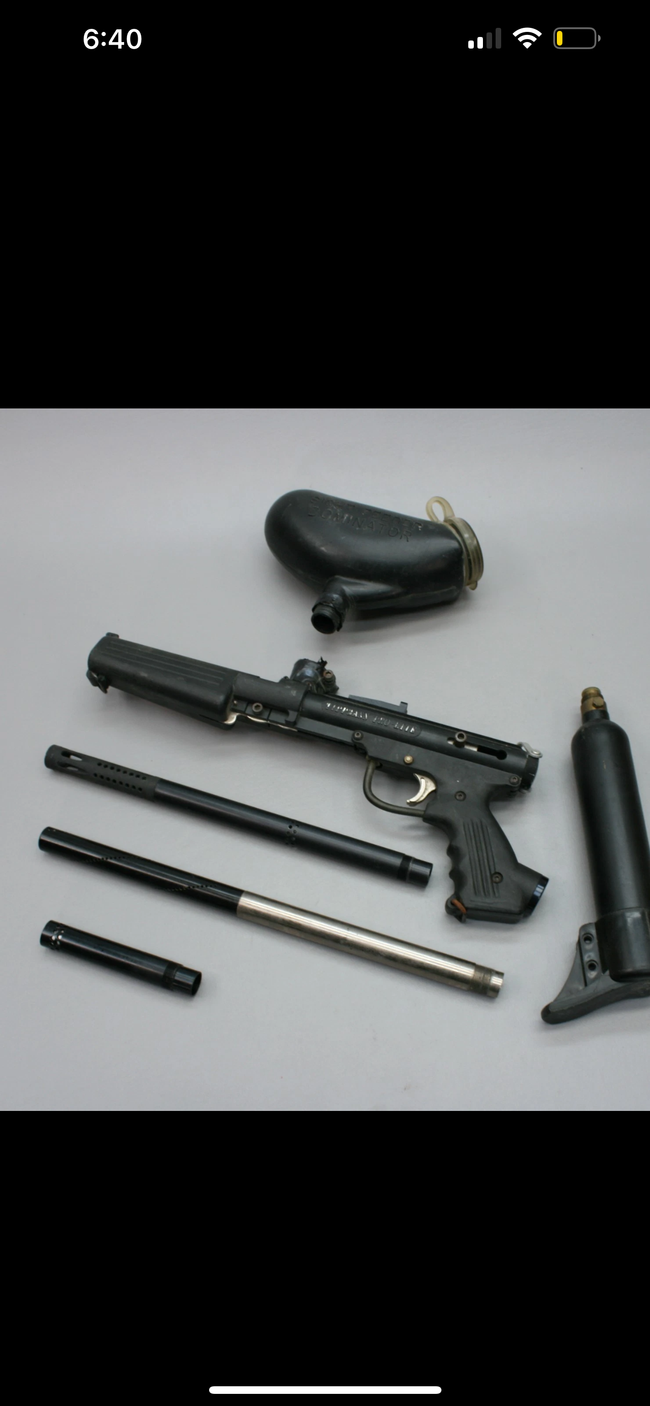

    I just bought this off EBay because I’ve never owned a Pro Lite. I was waiting for a mini lite to pop up but this one looks different. It doesn’t have that little “valve window” cut out on the body. Serial number is 2366 so it looks like it’s an early version maybe? I’m unfamiliar with the barrels. Is that super long one even threaded for Pro Lite?

    Long one looks like it's been on the prolite due to the shroud marks on it.
    The prolite uses a5 threading so they all fit technically but some go too far into the breach and the bolt can get stuck. That long one may be one of those barrels, the threading looks deep.
    I cant comment on the window thing. Mine has one. I want to say mine is numbered in the 9000s.
    Plan on a new detent at the very least.
    Be sure to cock it before you air it up. It's a thing.
    My breach is seriously worn from what I can only assume was years of rental abuse. Still fires fine.

      The shorter barrel is the Tippmann Sniper Barrel. I'm pretty sure the other will fit it will just take longer to thread.
      I'm not sure I've ever seen a Prolite without the window, but they might not have added that unlit they started making minilights.
      Looks pretty clean.I think it is possible for the early prolites to have the proam valve and powertube, which were slightly different lengths. I seem to remember some early ones came with it, but were also swapped out by tippmann if you sent it in. I could be misremembering tho.

        Thanks! Now when I hit the field I can say I’m playing Sniper? It’s gonna be funny shooting midget paint through what is probably like a .695 barrel. Any idea on the really small barrel? I was looking at stock pro lite barrels and they don’t seem to have porting like that at the end.

        My stock prolite barrel has the middle porting like your sniper and is about 6inches shorter. That stubby one doesn't look like it will even clear the shroud. It might be some two piece barrel missing a part. I do think it's probably the stock barrel that's been cut down most likely. The polished lip is a giveaway.

        Ya I’d agree it’s an older stock cut down. Hard tot elk for sure tho

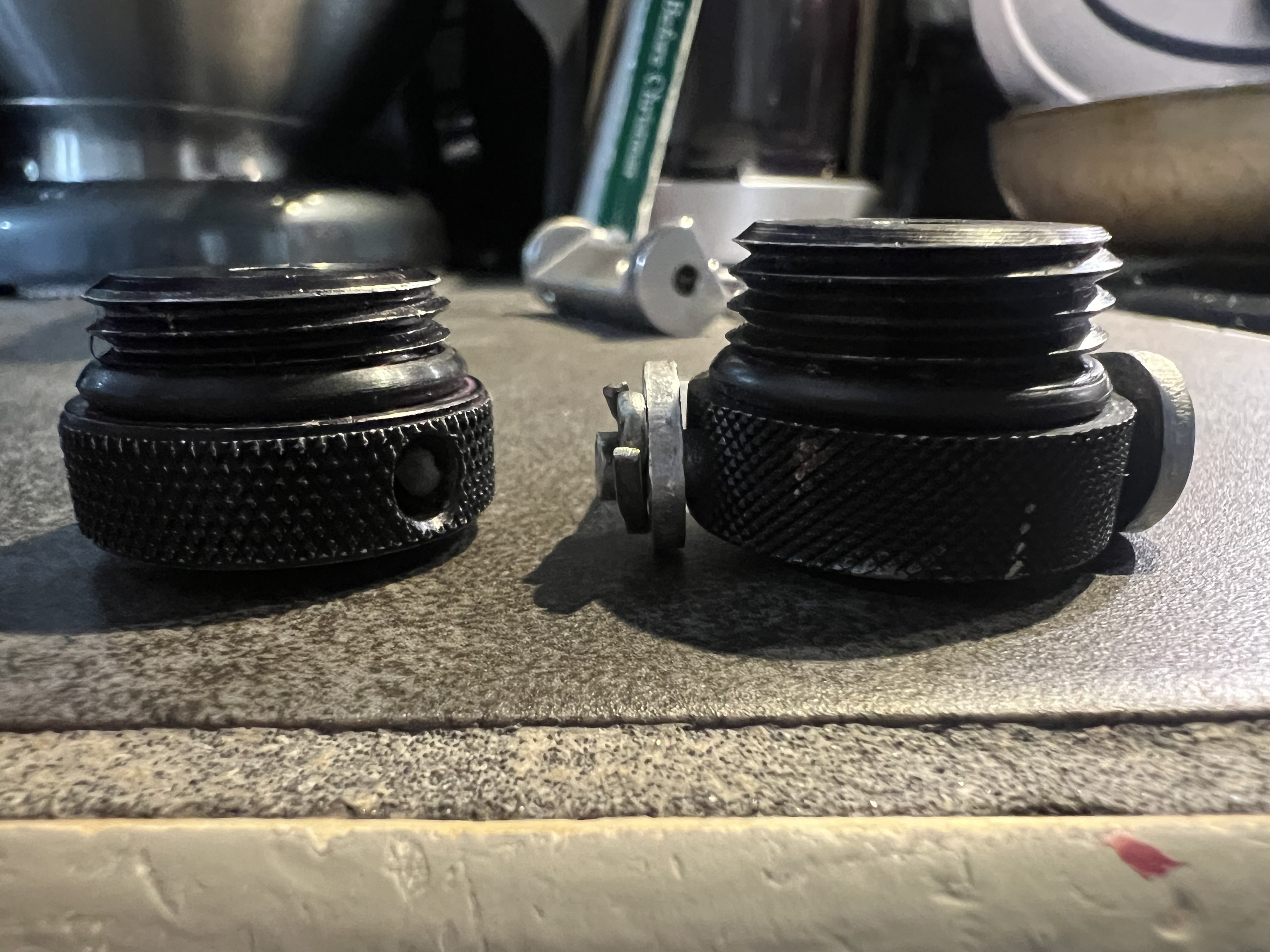

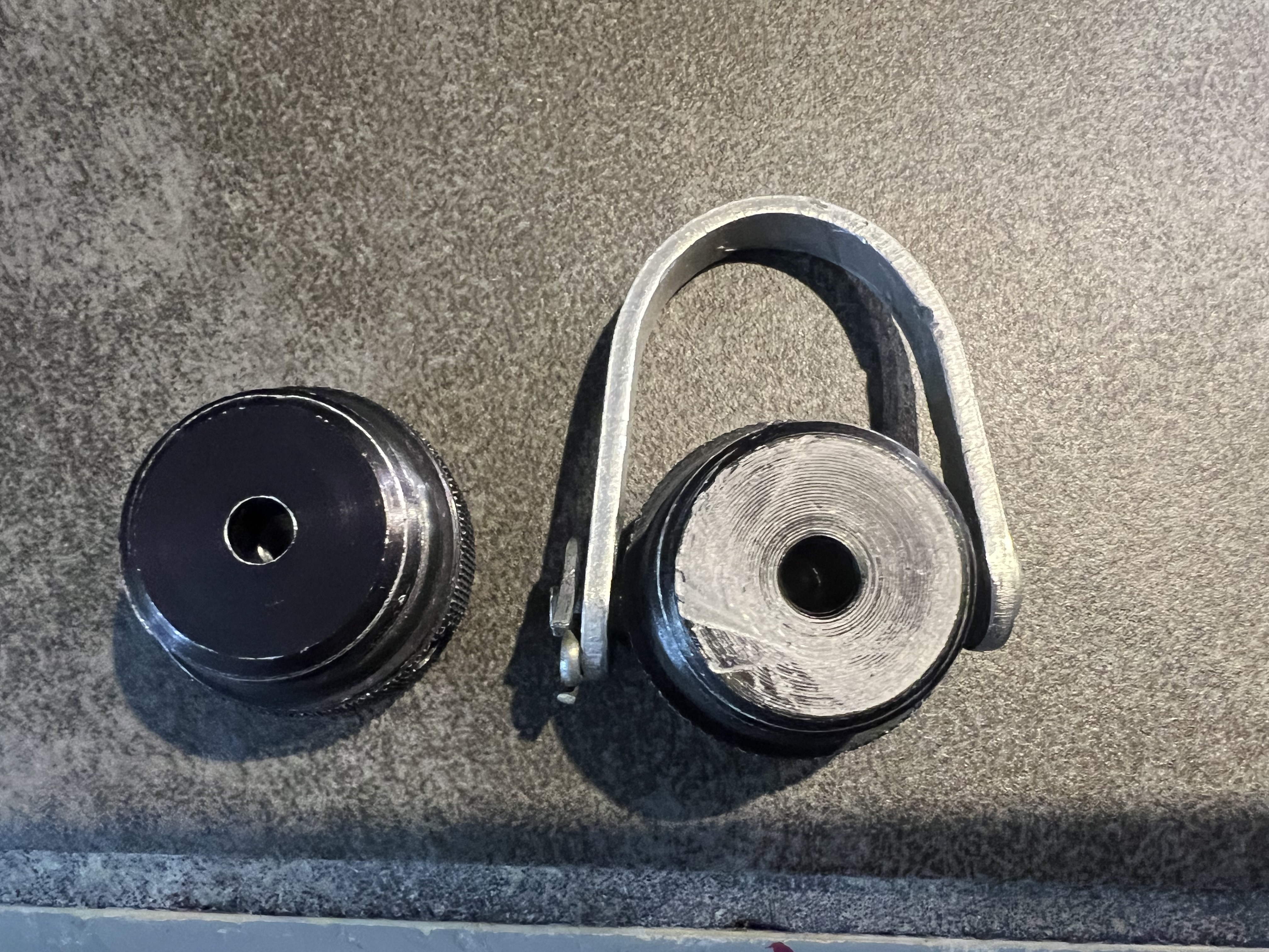

                You can notice in the picture of the end caps that the Pro Lite is larger. It threads in completely but if I tried to use a 98C/A5 main spring it was not working correctly. The spring cavity in the Pro Lite end cap is too deep for the shorter 98C/A5 main spring. The Pro Carbine end cap is more shallow and works great.

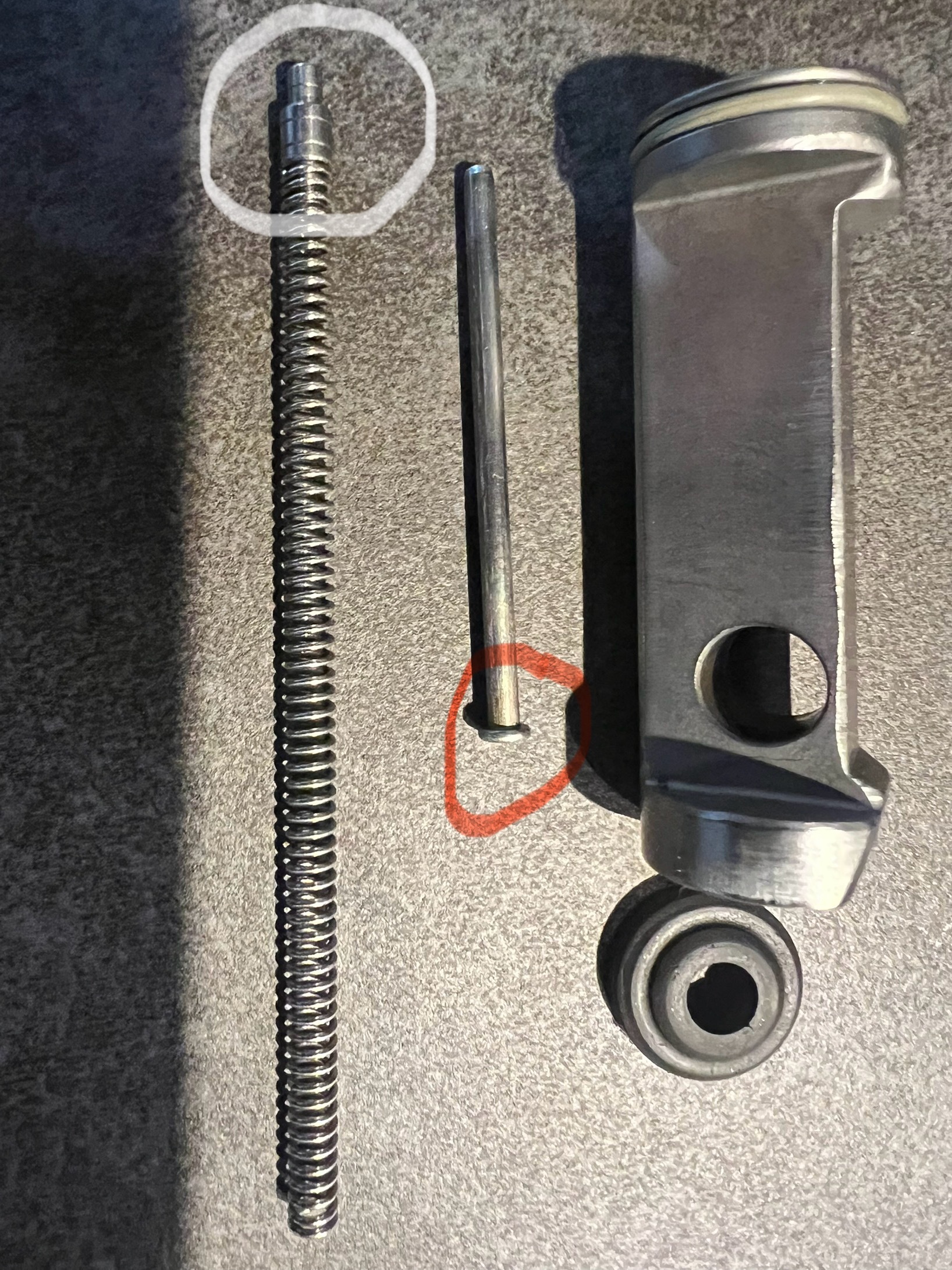

                In the spring picture you’ll see a TechT stainless steel heavy spring (which is shorter than stock and most aftermarket 98C/A5 springs) with a pin on the end. The pin is a TechT trigger pin for the 98C/A5. The problem with the Pro Lite hammer, just like the end cap, is that the spring cavity in the hammer was too long for a shorter spring. The trigger pin (circled in white) secured firmly inside the spring because the pin is thinner on the ends and fat in the middle. This acts as a mini guide. The spring is then slide into the hammer, pin down. The pin acts as a spring extender. The hammer makes full and forceful contact with the valve face and there are no complications with sear engagement or trigger pull. I have noticed that cocking the hammer back is much smoother using a 98C/A5 spring but my Pro Lite spring was pretty much busted so that was what I was comparing it to.
                The Pro Lite spring guide is thicker at the base and too long for a 98C/A5 spring. It prevents sear engagement completely. I circled the base of the Pro Carbine spring guide in red. It’s shorter and the base is thinner. I did put a small ball bearing in the Pro Carbine end cap to increase preload on the spring but it’s not necessary unless you want a heavier strike on the valve. I want to use the sling I have on it and unfortunately the Pro Carbine RVA lacks a sling mount. So if you have a Pro Carbine RVA it’ll probably work just fine although I haven’t tested that.
                So for a 98C/A5 and Pro Carbine main spring to work correctly, in a Pro Lite, a spring extender (TechT pin or something else you think will work), Pro Carbine end cap, Pro Carbine spring guide, and the spring will be needed. Alternatively, you could come up with an even longer spring extender and still use the Pro Lite end cap. It’ll just need to secure inside the spring, be one piece, and not allow the spring to slip over it. The spring guide, though, has to be shorter and thinner at the base. Probably even shorter than a Pro Carbine spring guide if the spring extender is lengthened.
