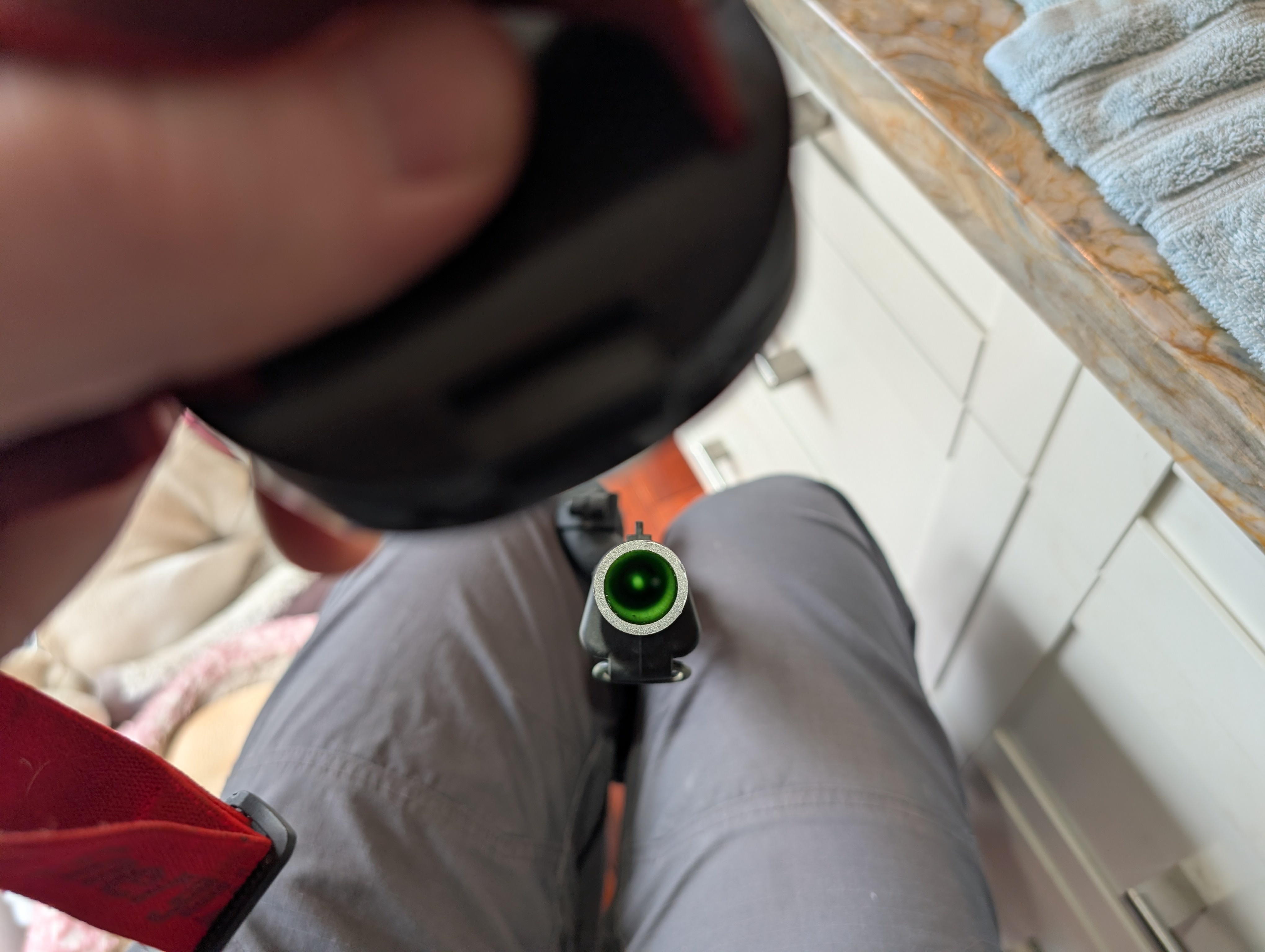

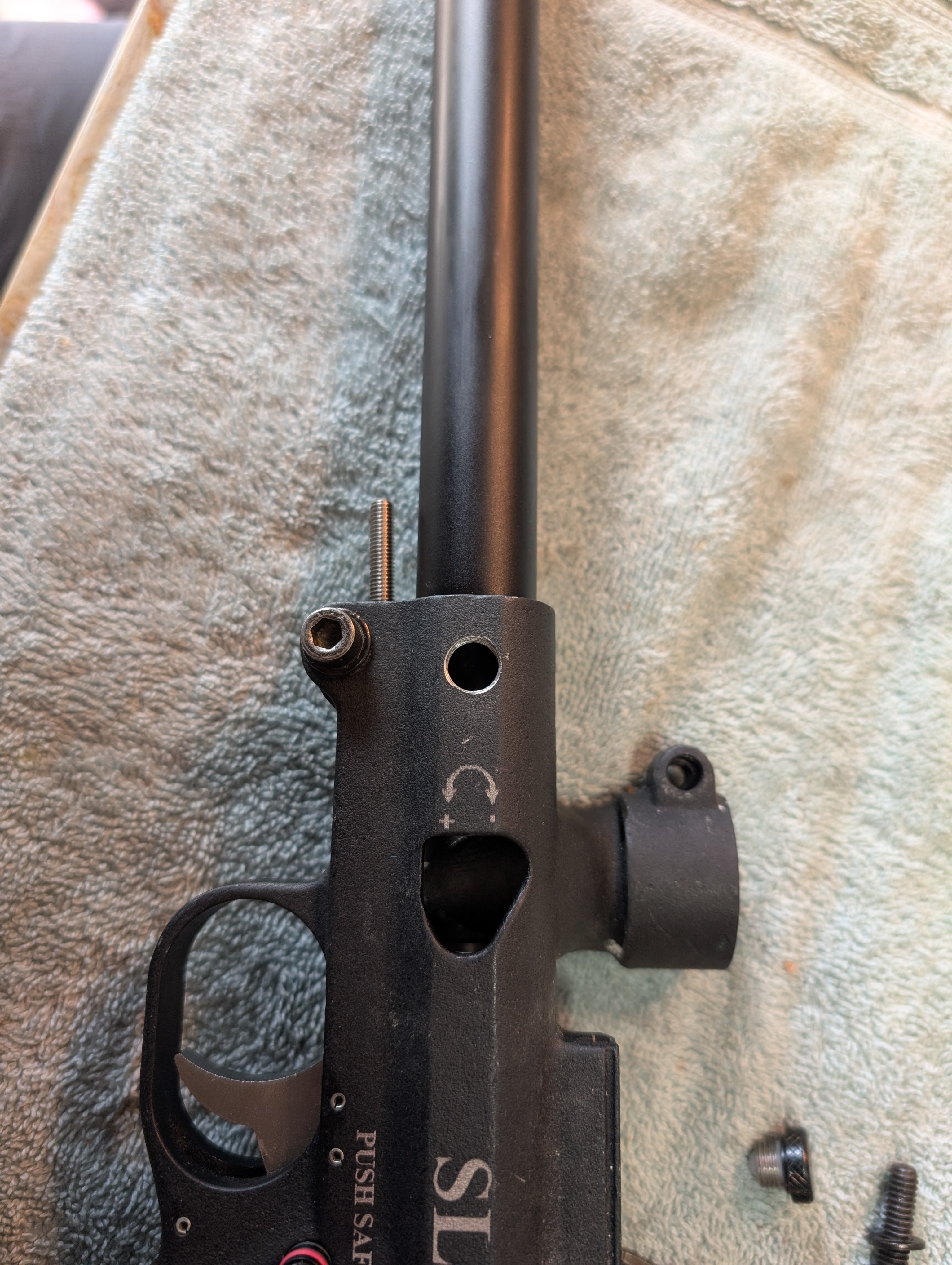

    So I picked up an SL-68II recently, got it locally and bought it for the small hpa tank that it came with. The gun is pretty neat and it was super clean, basically brand new, so figured I'd hang onto it. Of course the problem with these is they don't have any detents so that makes them unusable with modern paint, and the other issue is they like to double feed because there isn't an effective detent to prevent a second ball from forcing itself into the breech if you're not pumping quickly.

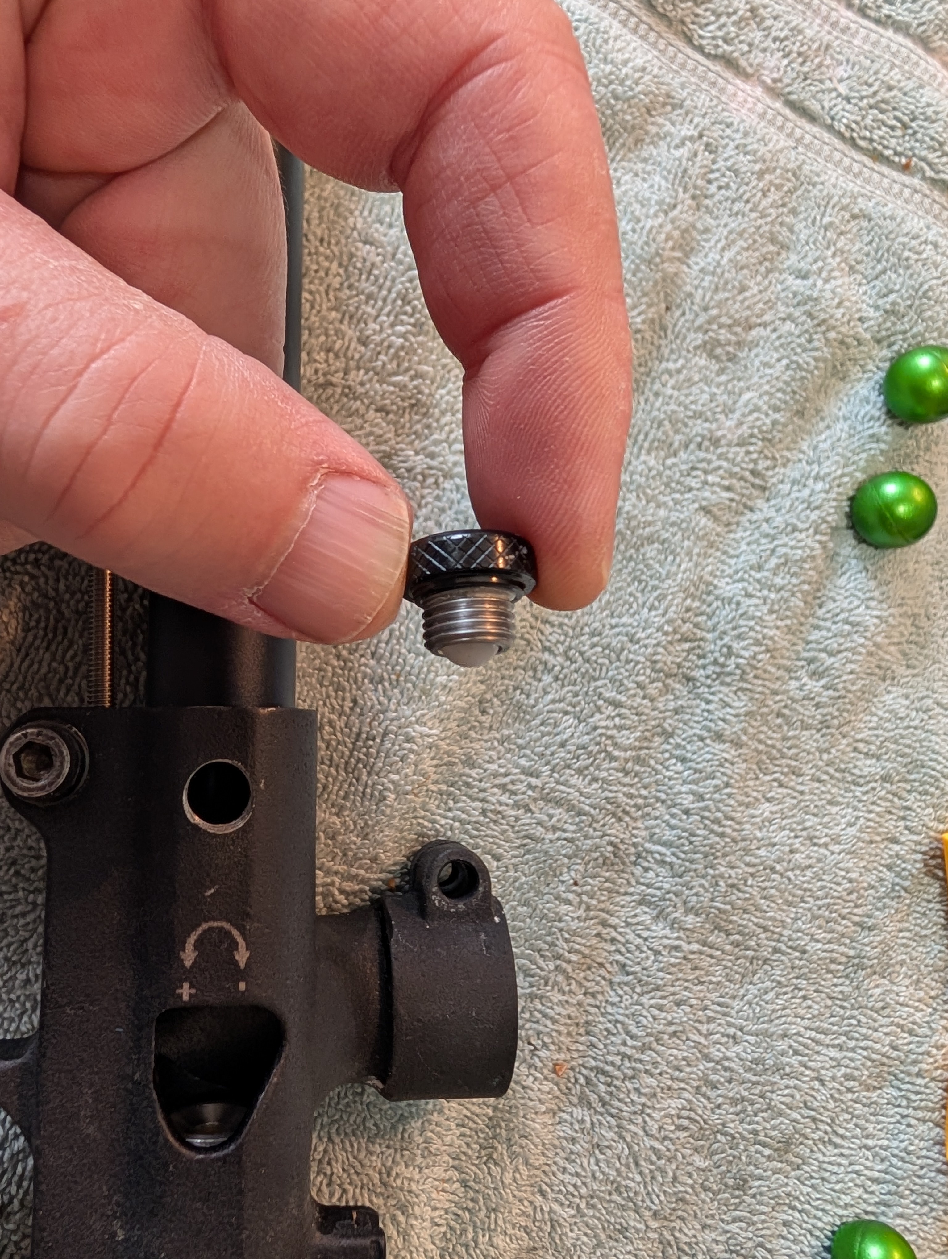

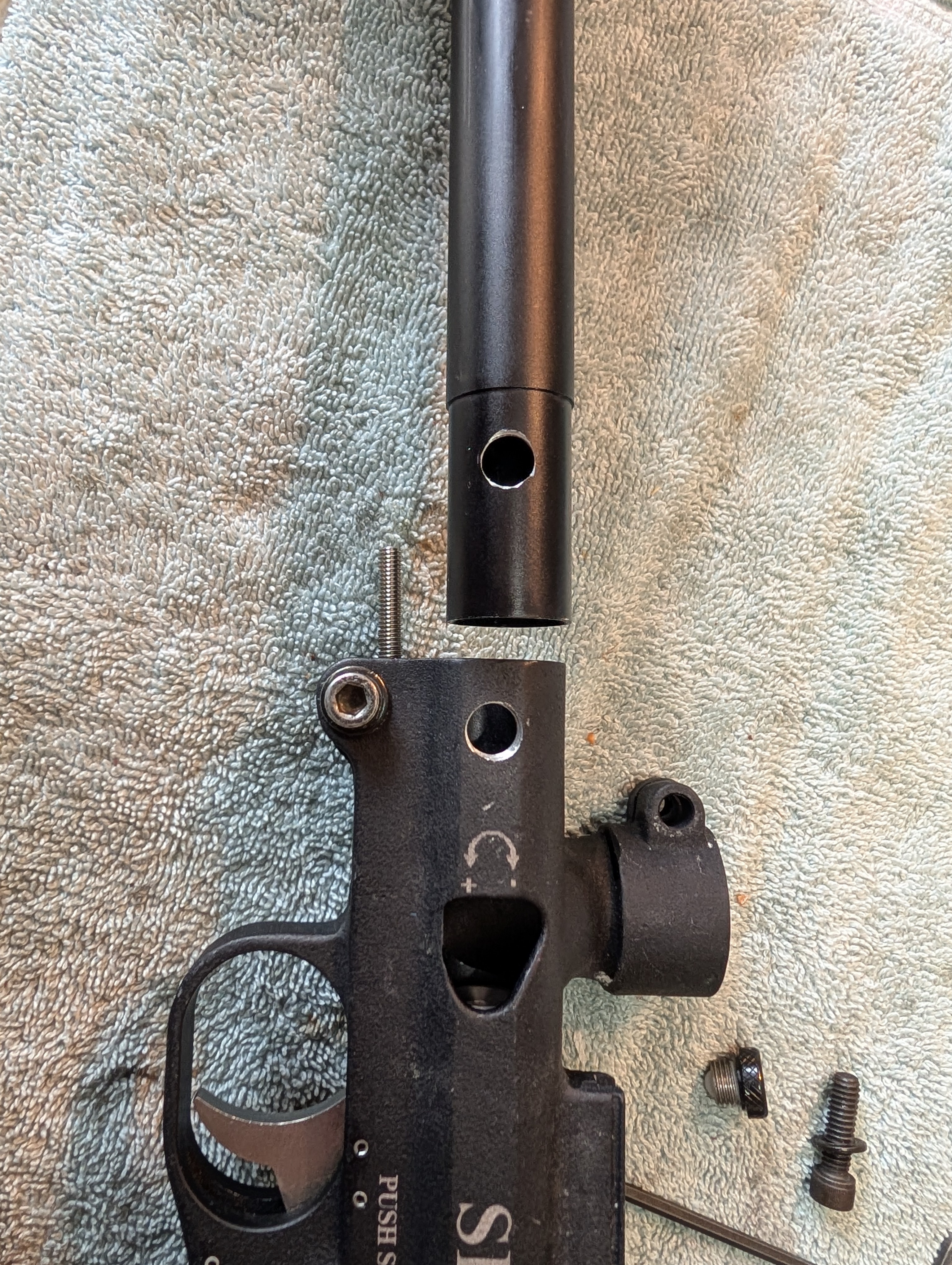

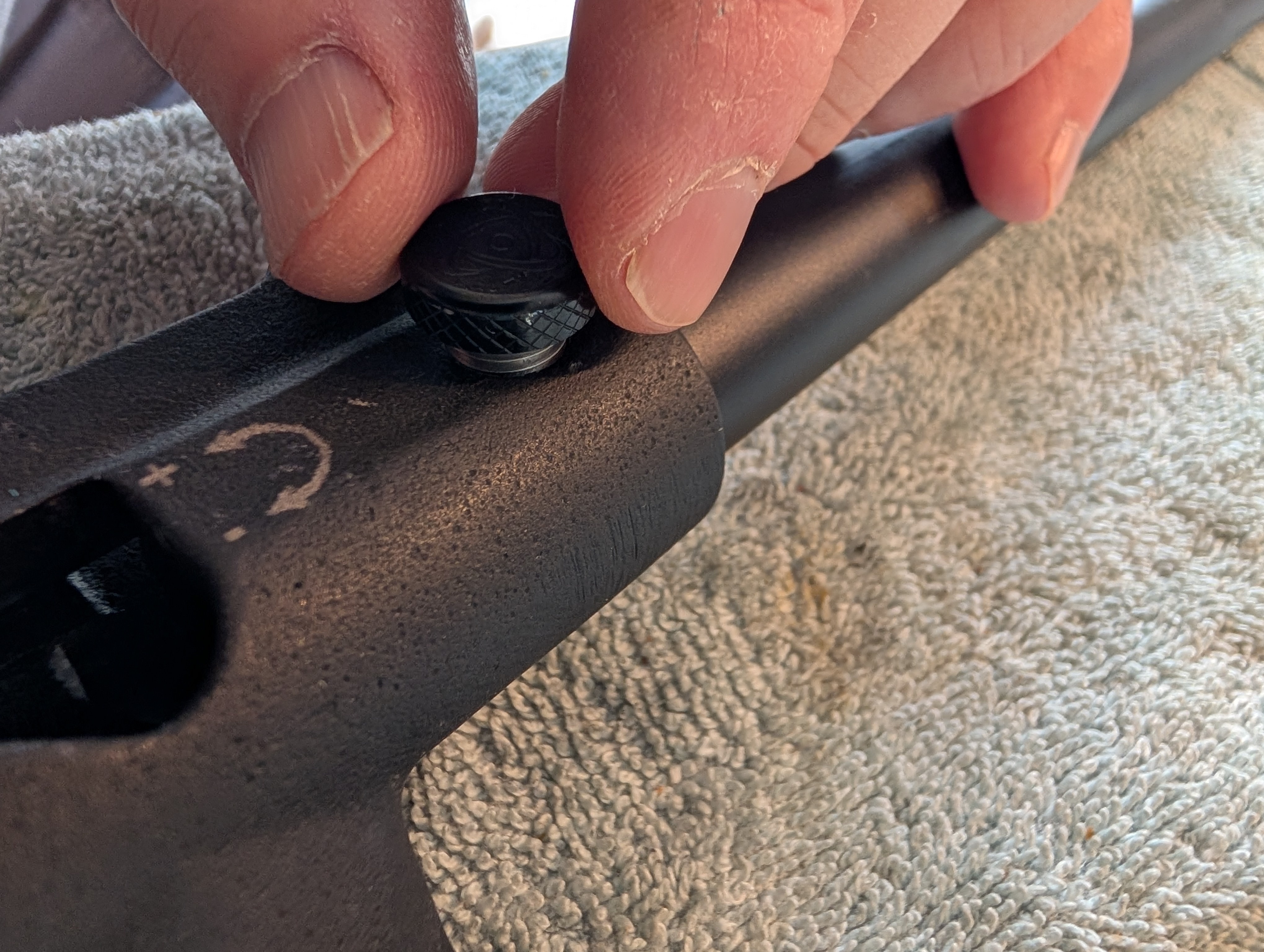

    For the first issue, I figured I could put a cocker detent in the body at a point where it would sit just in front of a chambered ball... the trick here is that a 'normal' cocker detent is too shallow and will not sit deep enough to get through the body and the barrel, you need to use something like an Inception style detent that has a longer body and can be 'dialed in' to the right depth. The springs on the inception detents are too soft so I had to augment with a cut spring from a ballpoint pen. The procedure was to mark the spot where I wanted the detent to sit, then insert the barrel and drill and tap through both the body and barrel. Dial in the depth so the detent is deep enough, add a bit of locktite on the end threads of the detent body so the cap stays attached, and that did the trick.

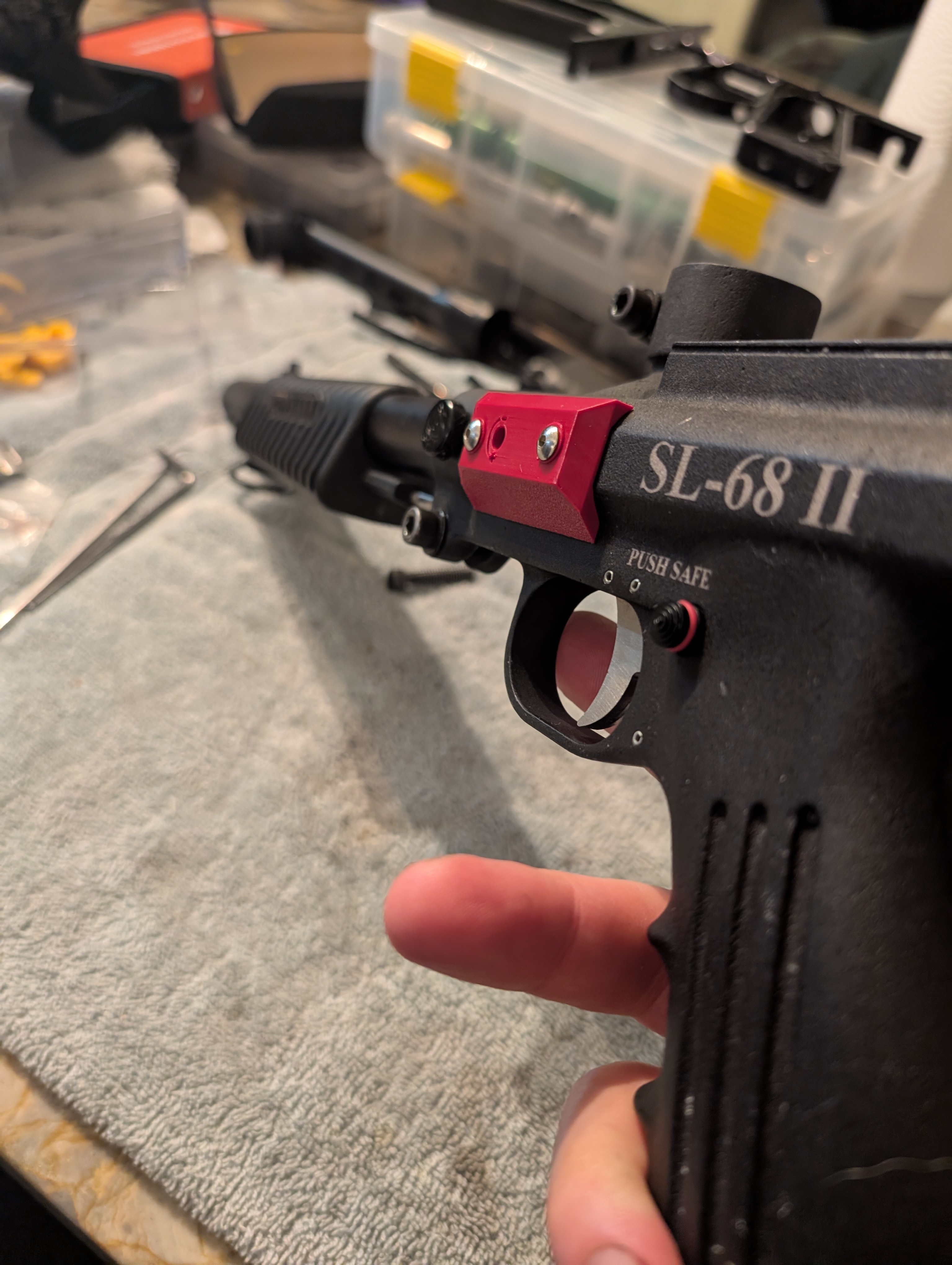

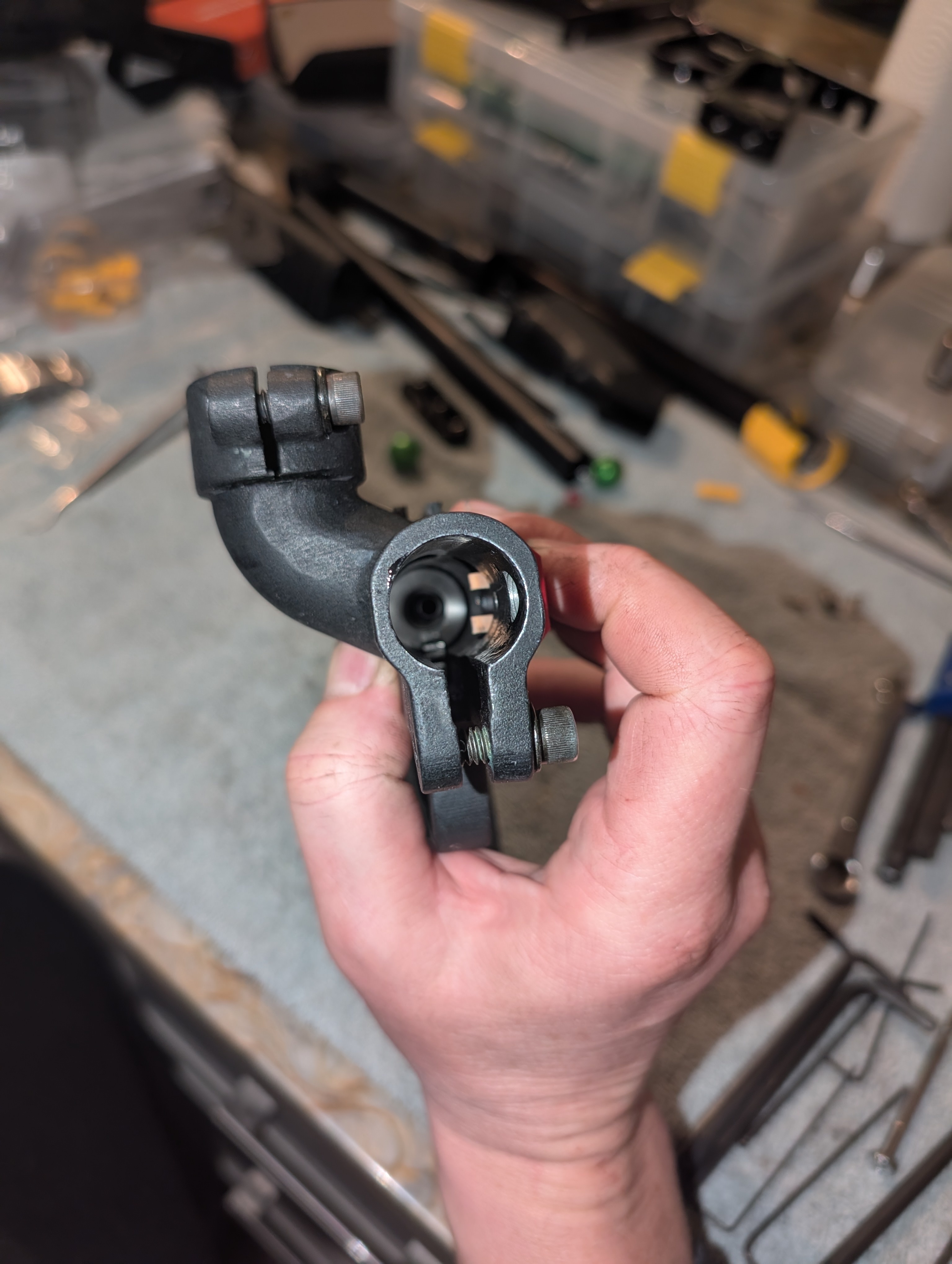

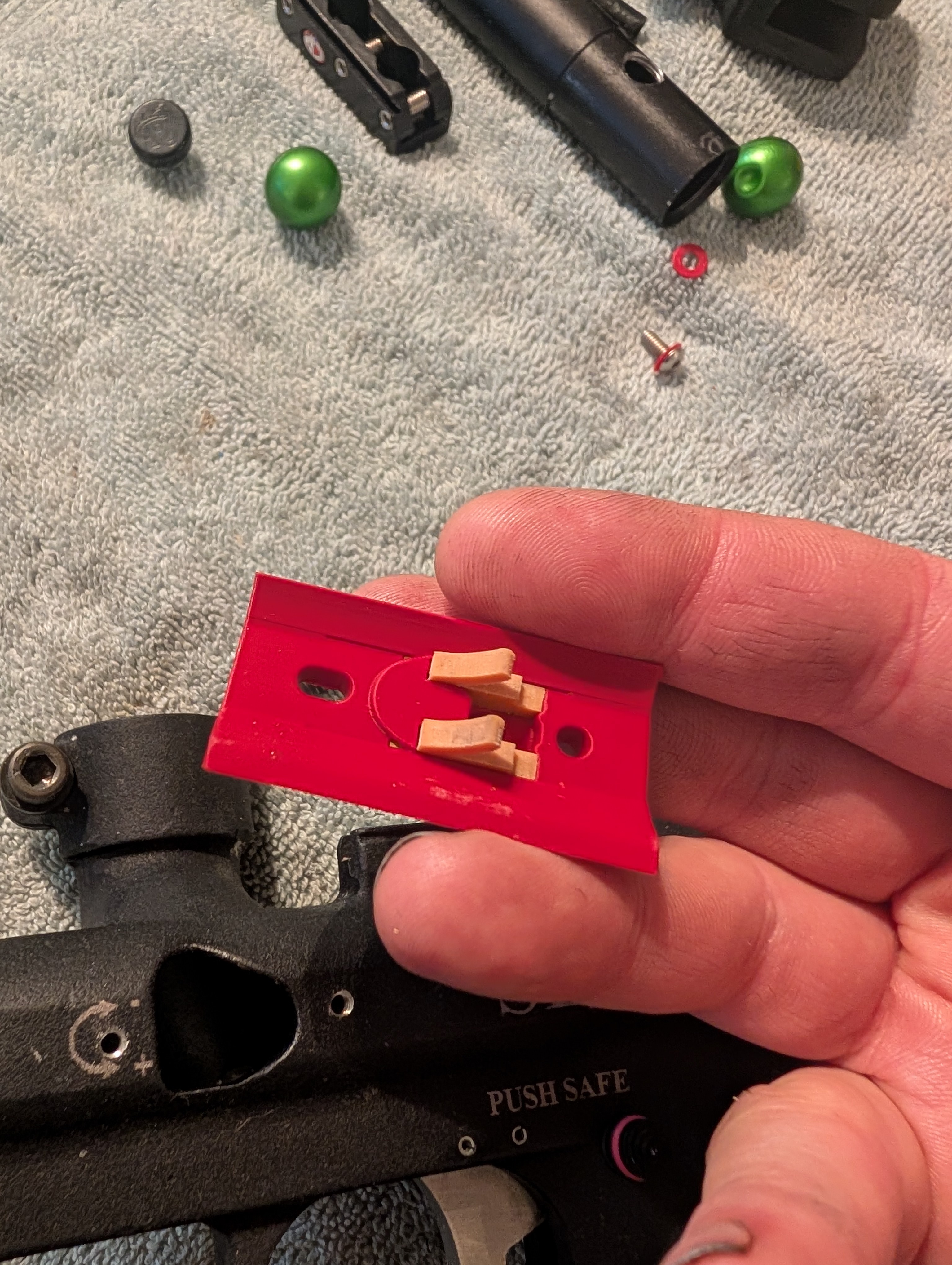

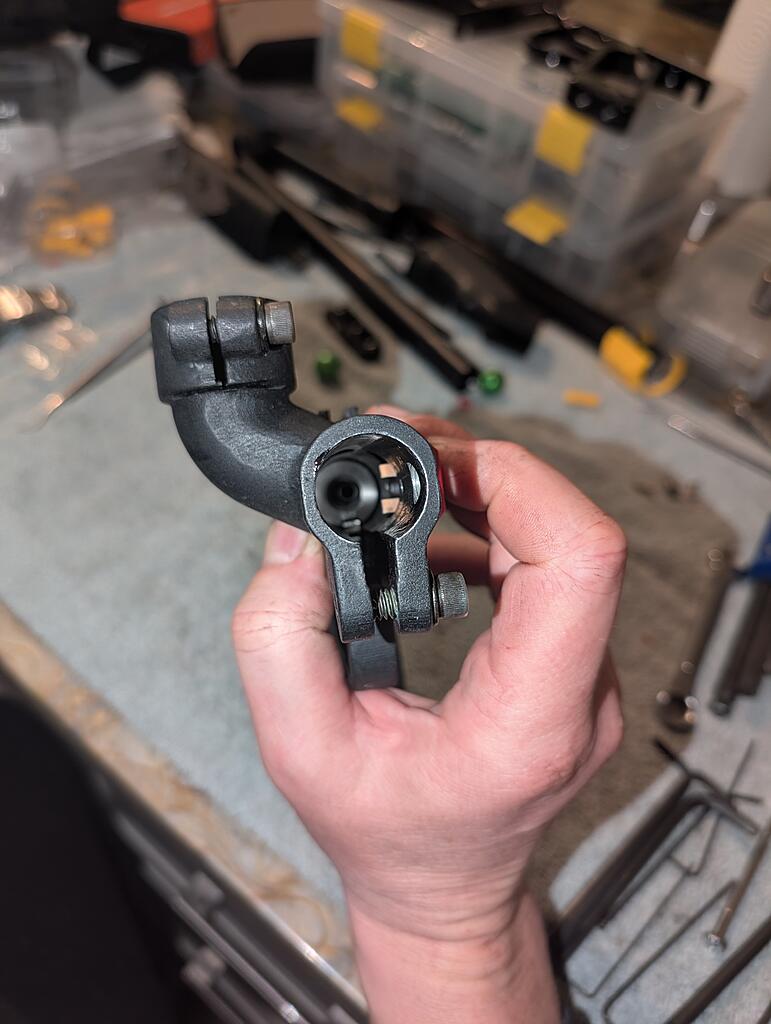

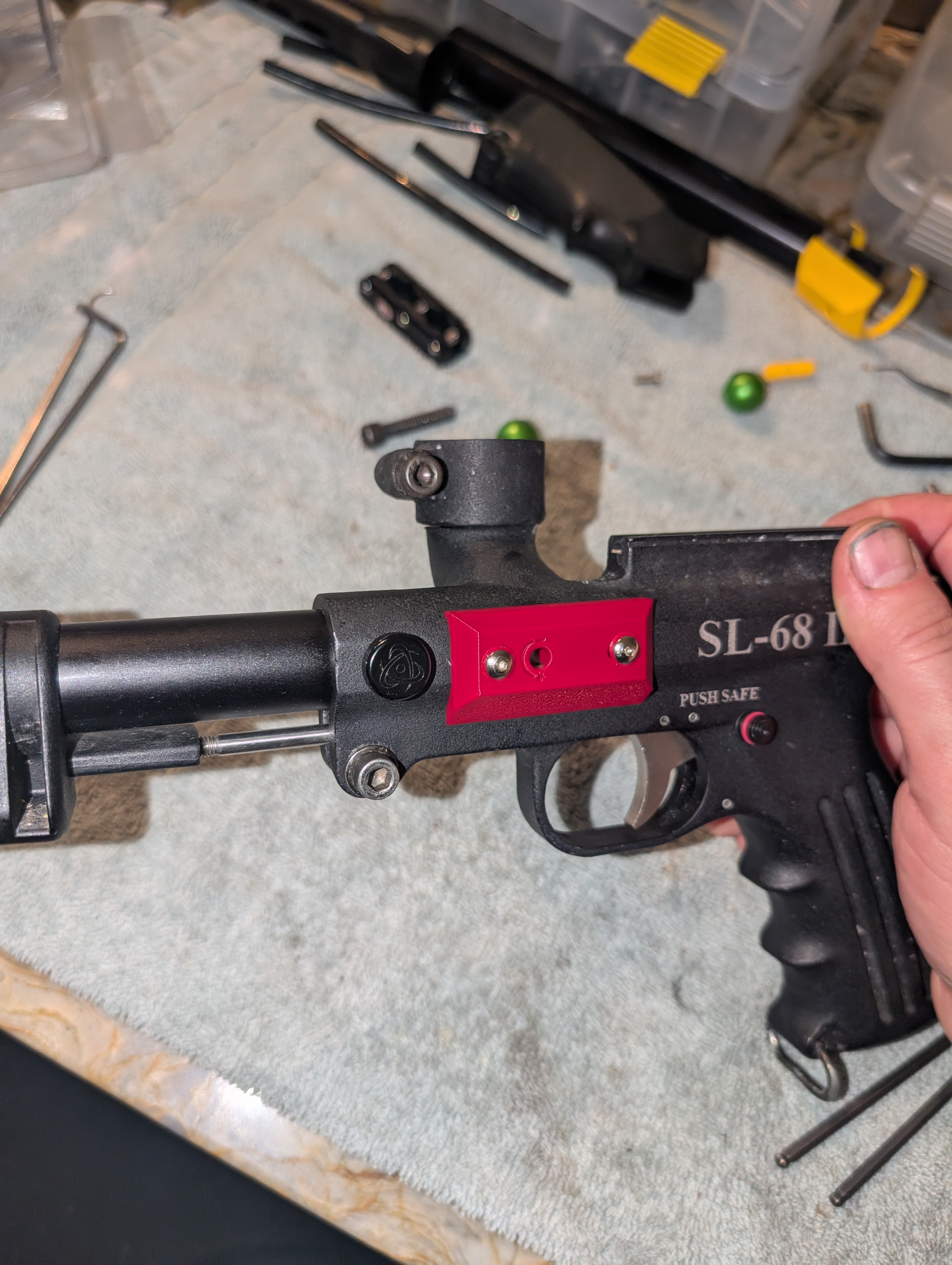

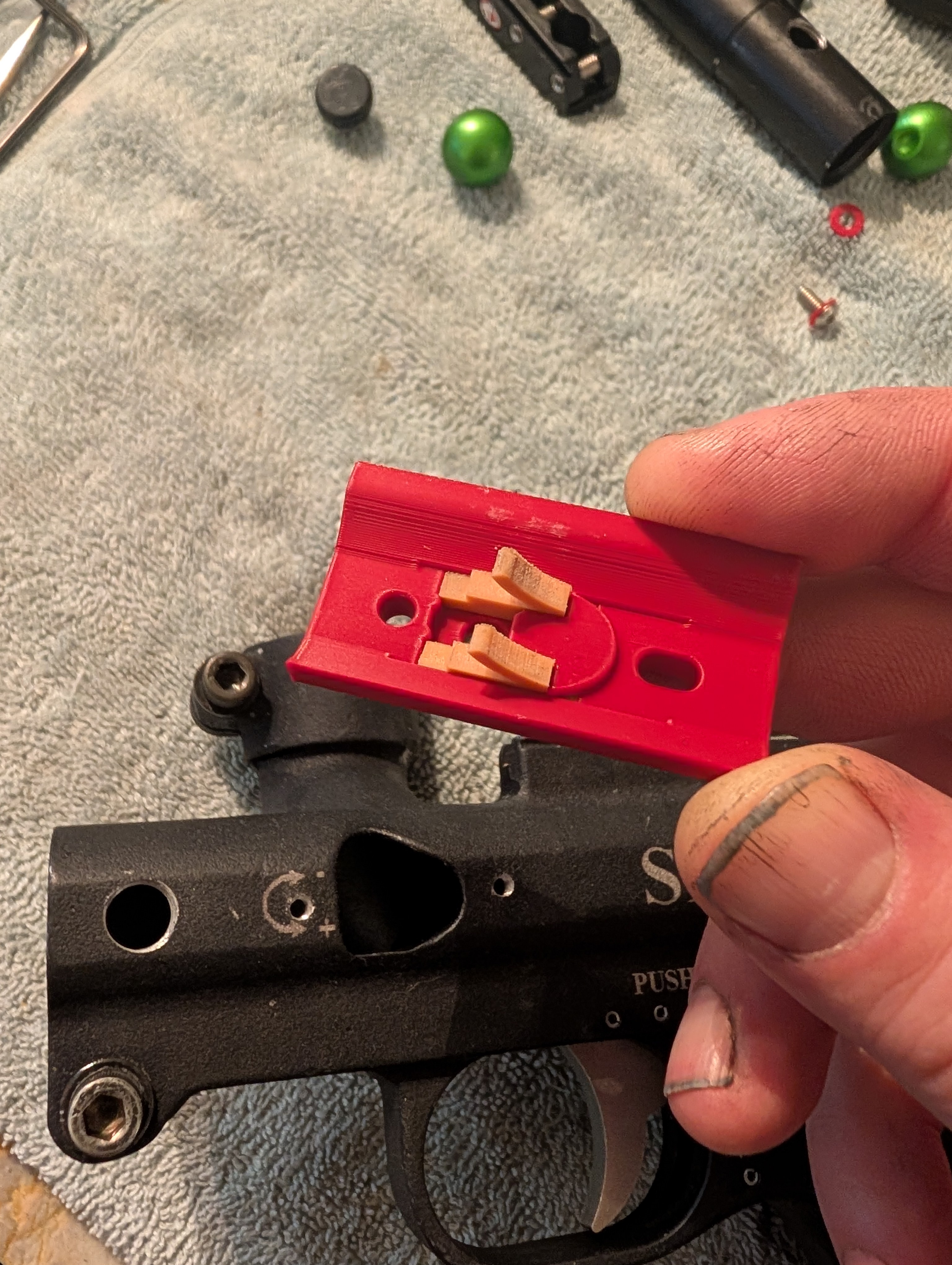

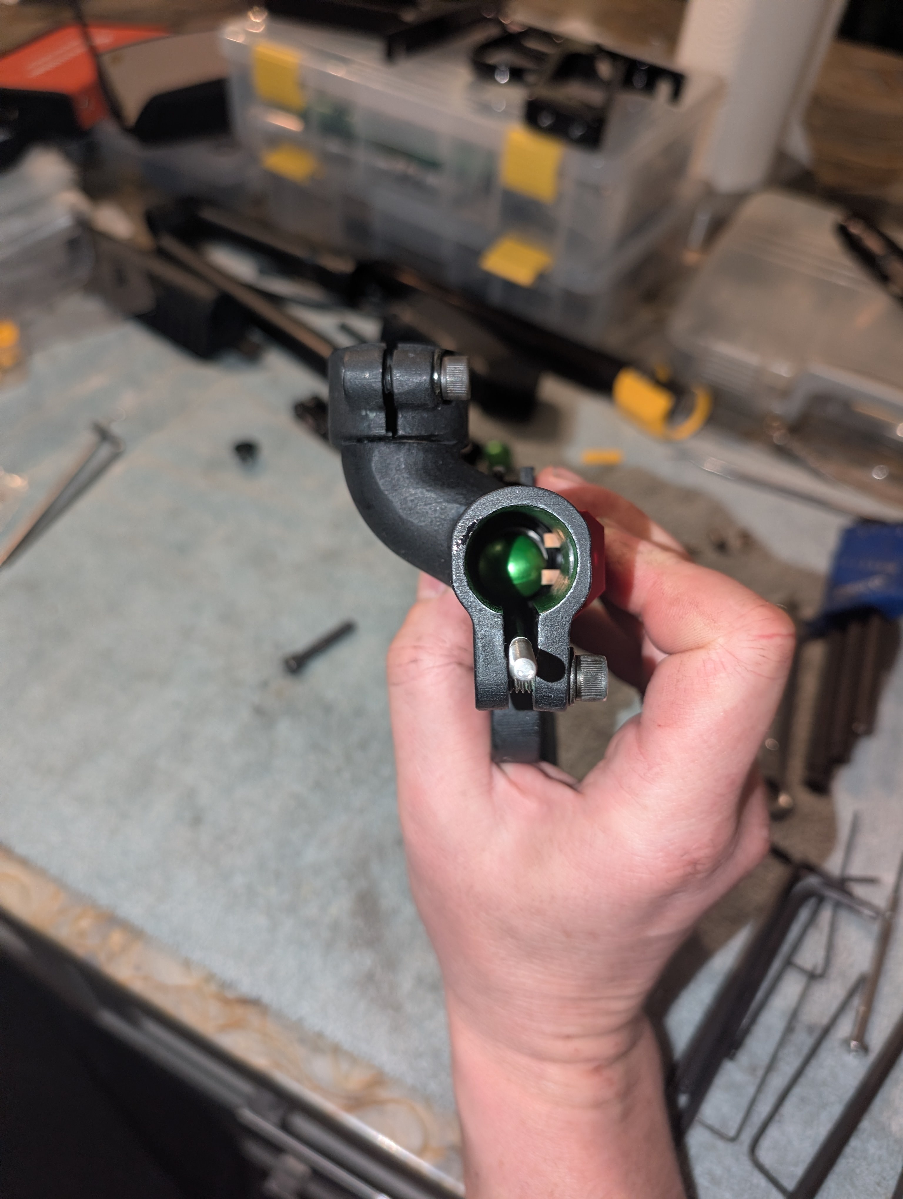

    The other detent was a bit tricker, I figured it might be possible to use a standard Tippmann detent in the breech opening but had to figure out how to place it... also the velocity adjustment screw is in the way so had to position it above or below. Thankfully a friend at work is into 3d printing and we figured out a design for a bracket that would hold one or two detents in the right spot. Here's a link to his files: Latch Detent Holder: Tippmann SL-68 Paintball Gun - Free 3D Print Model - MakerWorld​ , we went through 3 iterations and found that it worked best when screwed to the body. Drilled and tapped the body and she's ready for the field!​

        Very cool, the velo adjustment map is such a nice touch.
        • RichM
          RichM commented
          Yeah that worked out nicely, it was my friend that added it, he's a mechanical engineer and meticulous with details like that.

        Not sure what shooting past the barrel detent will do...
        • RichM
          RichM commented
          Shouldn't be an issue, it's not sprung too heavy and it's a delrin ball, should be a lot gentler on paint than wedgits and those work well.

        Hey man seriously Nice work! Between the deadly wind freak barrel and now Docs phantom barrel adaptor you don’t necessarily need the inception detent, but the breech detent was really the one needed to make it functional. Will be printing for sure and reporting back. I’ve got 2 SL’s with DW barrels that desperately need these.
        • RichM
          RichM commented
          Yeah I intend to pick up a freak barrel at some point, but wanted to see if the inception detent would work in the meantime. Let me know how the breech detent works out... I found that there's so much room in the breech that a single ball will find a way past them (up and over), but as soon as you have multiple balls in the feed it eliminates the room and it works well. You really just need the lower finger in the detent, it does most of the work.
