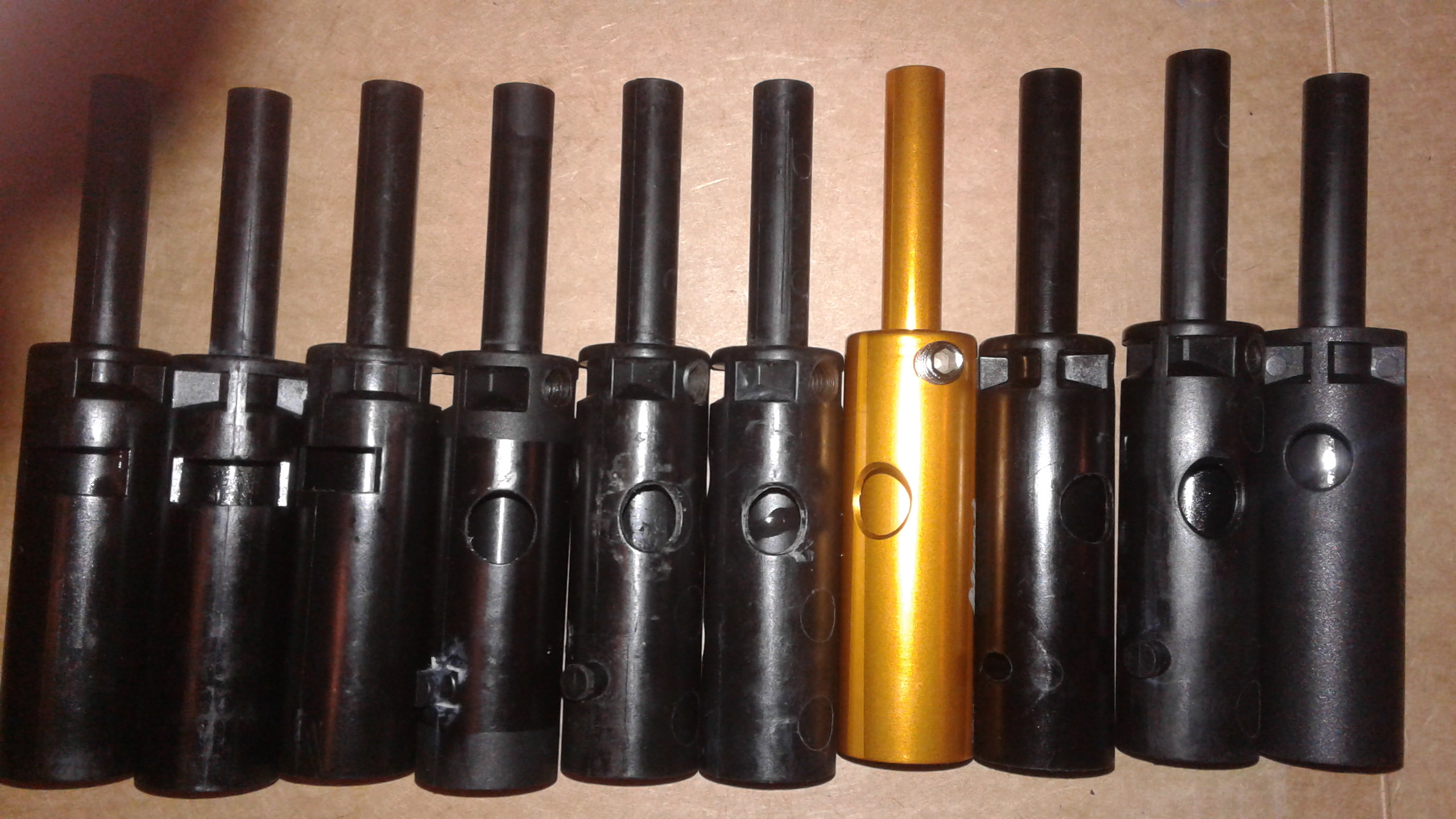

    there has been test over the years where to find them thow...i seen power tube test, upgrades are lp kit, ebolt kit but with the ripclip is better then the cyclone or a hopper adapter and a e hopper.
    centre feed mod was a big one to get it to shoot faster as well published internals. teflon coating tube was also an upgrade.
    there are different valves one with 3 channels and one with 4 some modified. adjusting with valve spring upgrades and lighter hammer/ spring.
    its posable i seen adjustable banjo think from rt kit could use for cyclone i think?
    i once was collecting 98/a5 clones to find the differences but stopped the project.
    simply put unless you really love the 98 there cheaper better markers out there.
    as for barrels cockerpunk / gerglmuff / PunkWorksPaintball on YouTube did a big test on it basically paint is more imported then the barrel. it was done a few years ago so better tech might help with a redo but ya.
    biggest thing is probably a good take reg, inline reg, the published internals and a slight under bore and no cyclone no rt. most upgrades don't help.
    but like nadrepadre ​said do to the valve its just poor to get any kind of consistency.

    the idea of the cones was to fine one that may have improved on or made changes as they are all slightly different.
