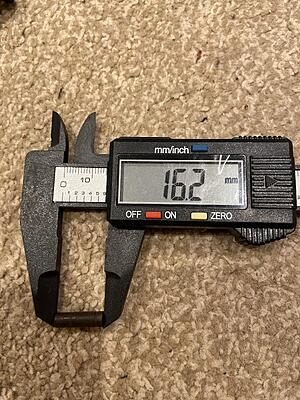

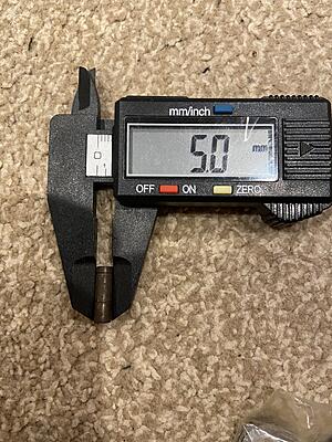

    I don’t really have the time to pull apart one of my Angels but this spare pin should cover Speeds as well.

      THANK YOU. is there a lip where it's turned down? I can't tell if mine have a lip, or if it's just corrosion.

        I zoomed in on yours. Looks like a 0.5 reduction on the top half. I can bring my LPR in and take some measurements. I replaced it with an SCM, so it's just sitting around. Thanks a bunch, man.

          small part of pin is .185, larger section is .193''. I've made a few pins for various angel projects and have always found that a consistent .190'' diameter pin works well. Not sure why WDP put a step in the pin.
