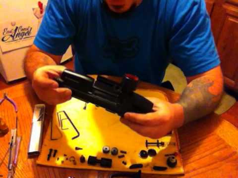

                          That would be cool. I've been chatting with Brad from ECA. According to him, the 05-06 Speeds are some of the most reliable and user-friendly Angels. The only inherent problem with Angels is the amount of parts they have, which obviously means that the chances of little things going wrong here and there is greater, (i.e. exhaust guide & valve assembly, reg seals, ram, etc.) especially after so many years, just the fact that these assemblies have a lot of little parts, means that people lose them and/or reinstall them incorrectly. I couldn't help but wonder if that is what caused the Angel used market valuations to plummet and why theyre starting to go back up slowly after more and more people are restoring their Angels. Cause after all these years, the chances of picking up an Angel that has not been restored (and converted to 9V) -- that is in full working order are slim due to the aforementioned reasons. Which obviously hurts their resale value. And hence why theyre going back up as more and more people restore them, as I mentioned. That being said, he says that the 05 Speeds are generally reliable even the eye system, he also mentions the reliability of the eye system on his tear down video of the 05 Speed. But either way-- I welcome a challenge, you know. I've mastered just about every other gun. So I welcome a change of pace.
                          Here's the video of the 5Speed teardown where he mentions that the eye systems tend to always work, and that the marker is generally reliable:
