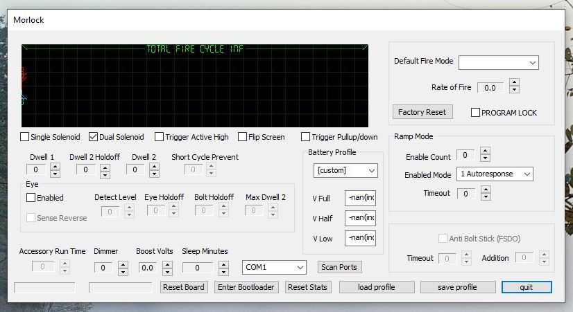

                      Current limits? Not a super meaningful one, it can switch more current than the wires can handle but I'm using a DMG4800LSD dual-channel MOSFET which by the specs will handle.. around 9 amps, so let 'er run all night.
                      Using the off-channel as intellifeed is something the Morlock boards did from the very beginning, this one is no exception, it's already built into the docs on the site.
                      You can adjust the timing of when you want it to kick in. Originally I also had it hold off for X time after a trigger and have all these adaptive algorithms but none of them seemed to really be better than just turning it on immediately.
                      Just look at the lower-left of the configuration utility, "accessory run time" is where you configure how long to run after the string ends, from 0 to whatever.

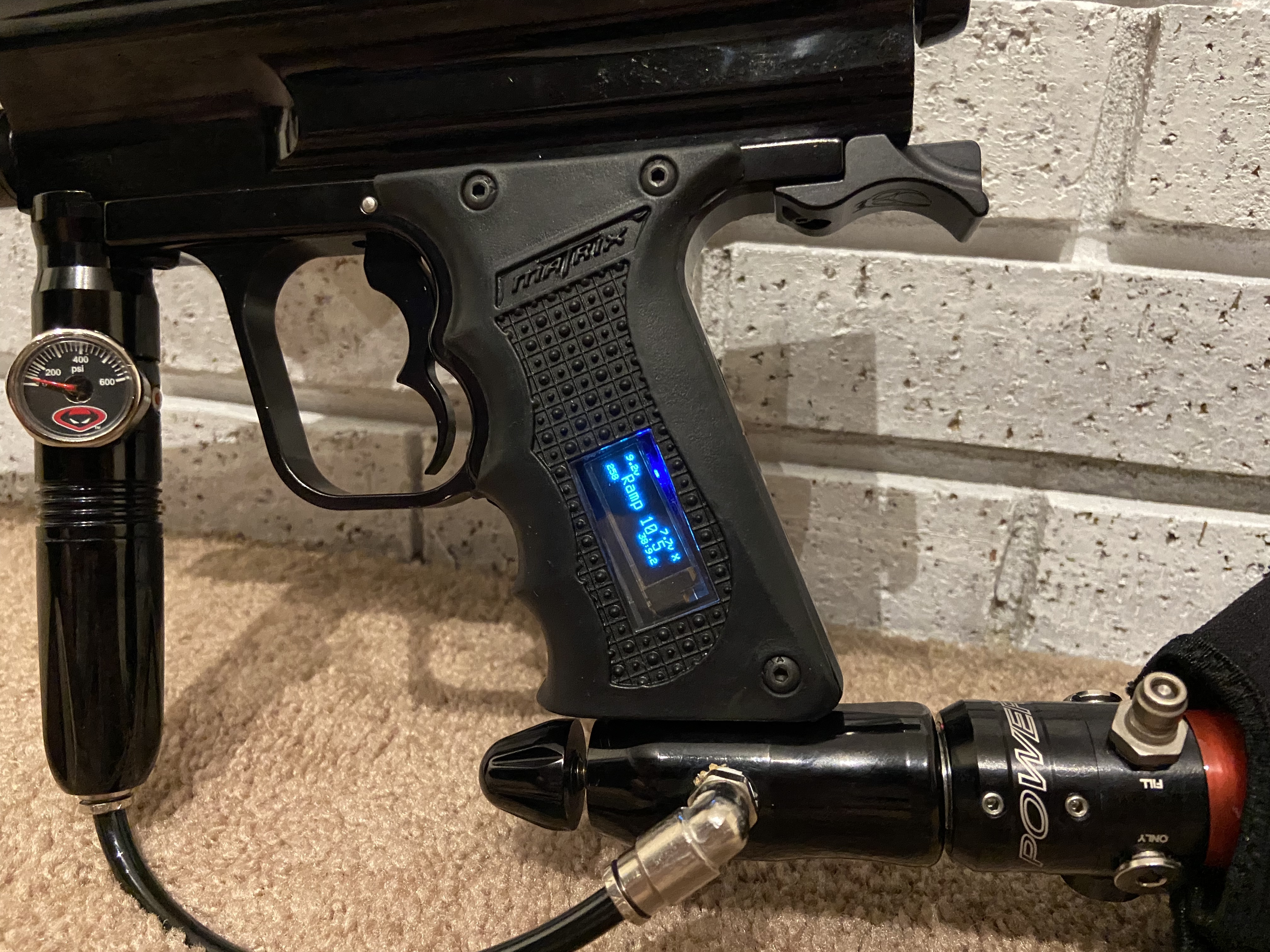

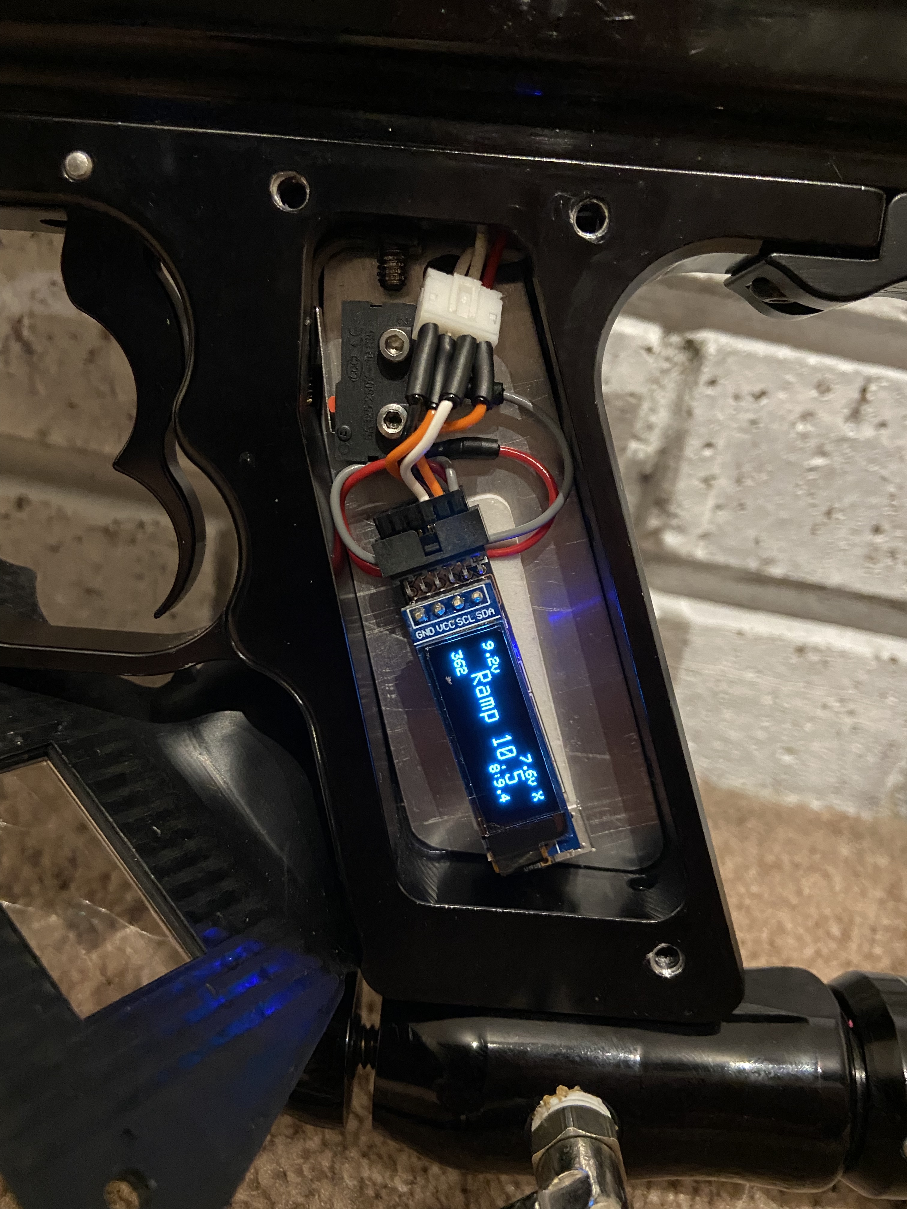

                        Morlock Matrix, I like it! Install wasn’t bad and I like the programming procedure.
                          Alexndl commented
                          And now I want one of those board...

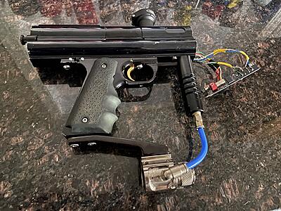

                          Mine just came in and now trying to get it installed in my old Droid. Doing it cleanly is going to be a challenge, but getting this gun up and running with current modes has been a goal for awhile.
