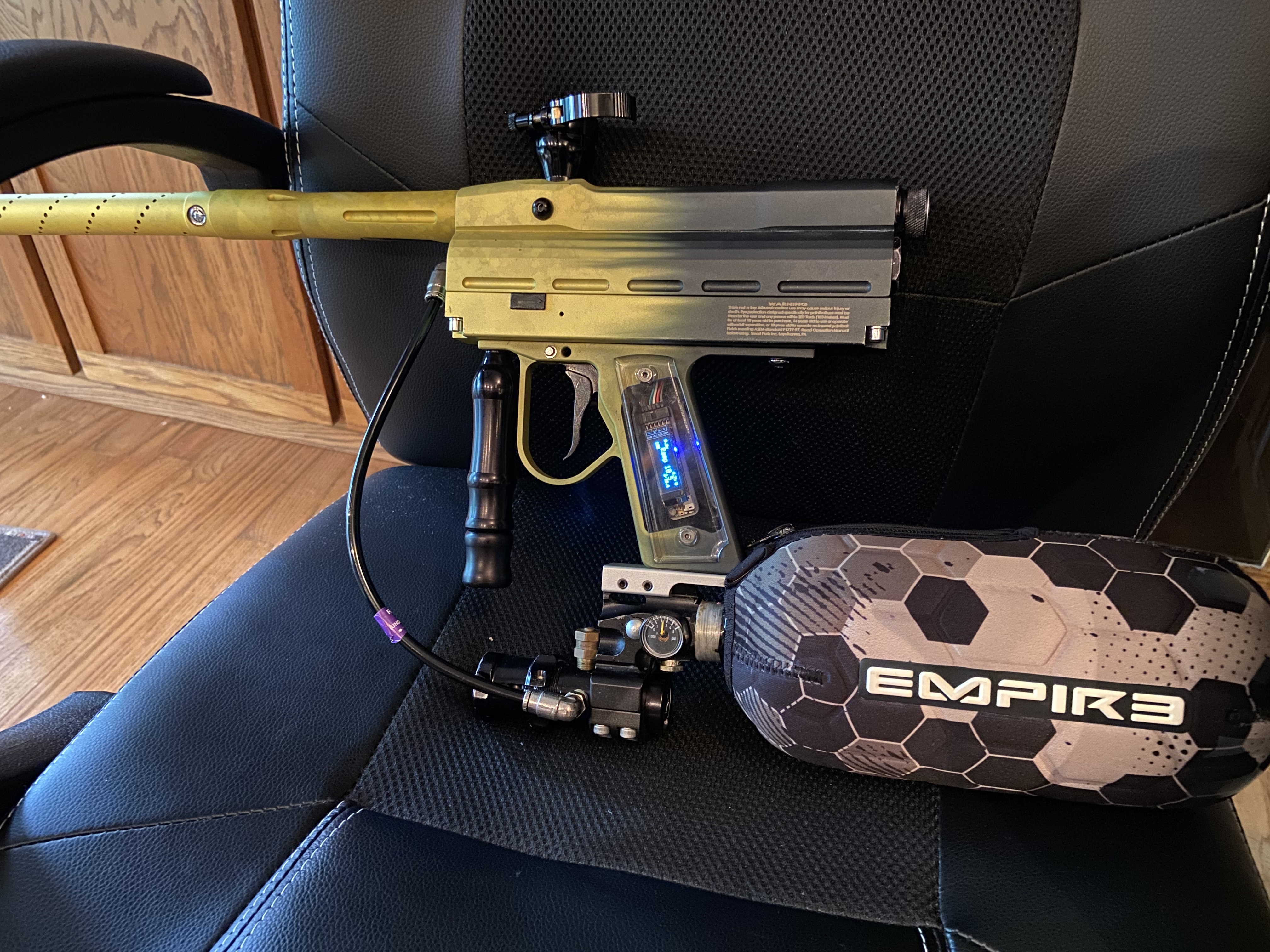

        Got the old Shoebox running.

          Nice! I ordered 3. Just waiting now. Curt was nice enough to send a email explaining the delays. Really appreciate that. It’ll be great to truly modernize my Racegun. Maybe build a EP Mag too.

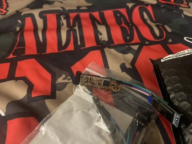

                              #60
                              Thank you Curt!

                              • Altec
                                Altec commented
                                Not sure if I'm doing this comment thing correctly! Haha. I picked up three. Two for my old Raceguns, and a spare. No Dragun project! But I have been looking out for a T1 recently to build with a Alias frame.
