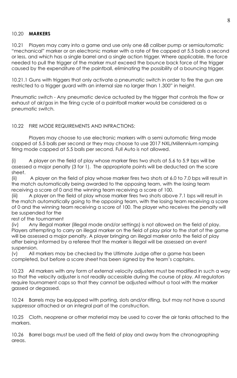

      #18
ID:	129040 Clip from the ICC rule book but this is pretty universal when it comes to Mech Tournament play.
      • fullofpaint
        fullofpaint commented
        5.5 is REALLY slow, you can do that with a Tippmann steadily. No real advantage to allowing ramping when everyone else is shooting way faster. Plus easier for the guys who are switching from one format to another at an event. Just lower your MROF and your good to go, no need to fiddle with fire modes too.
        The idea is to discourage electro play. It’s a disadvantage especially with today’s modern Mech markers. But even in Mech you can use an electro if you really wanted to.

          Originally posted by djeclypse
          When you say "modern mech" what are you referring to? Would double trigger be allowed with a mag, cocker, carbine, etc? What about the cheaper entry level mechs of the past ten years that had doubles out of the box, such as the ER3 if I recall?
          Read the rules Chuck posted above, specifically 10.21.1. As long as the gun isn't pneumatically switched it can run a double trigger. So basically all the modern mechs, and I think the Automag (?) are banned from double triggers. Haven't actually seen someone run a Mag so not sure what the ruling is on them.
          The current rules really are the bets mix of accessibility and keeping the spirit of mech tournaments. Limiting hoppers is just frustrating. Nobody wants to play with a hopper that can't keep up with your gun, we solved that problem over a decade ago now, why would we want to go back to that.
            I would think Mags should be allowed - the trigger controls the on-off, which could be viewed as a pneumatic switch, but also controls the sear.
            I would probably draw the line at Xvalves and ReTro valves since they do violate those rules (return force more than what is required to pull the trigger) but Classic valves should be fine.
              Classic valves are allowed

            Yeah Mags are kinda blurred. Your trigger operates both a sear and a pneumatic valve. On a classic valve should be no reason to discount it with a double trigger. The xvalve get the boot for the double triggers purely on there higher return force with higher input pressures.
            I can attest that the eNMEy with a single trigger is faster than any of my classic valved mags I have owned with a double triggered frame.

              Classic valve mags look OK if you read the rule carefully. Return trigger force is less than pull force. And since mags trip both a valve AND a sear, it's not a single action pneumatic switch. So double trigger OK. Trigger guard opening isn't restricted.
              Cockers are dual action (sear and pnuematic switch) just a different design.

                    Can confirm. Played the ICC twice with a lvl10 classic valved Mag with a double trigger
