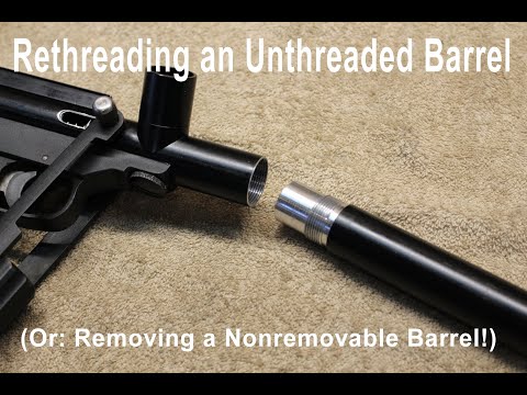

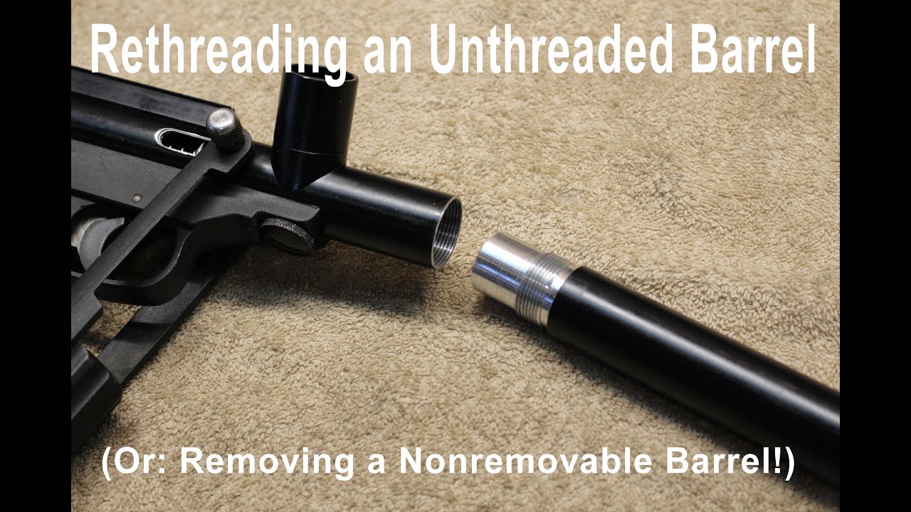

    An MCB'er sent me an older Nelson pump, with a unibody with a 14" bull barrel, which he wanted made removable. With the help of a bandsaw, the job was easy.
    The main reason I made this video, however, was simply to get a little more experience shooting and editing a video. Still a green noob at doing so, but I'm getting better, and this mod was a nice, quick, simple one.
    The only major flub was the camera apparently glitched when I was doing the threading, and didn't save the clips. But I thought the rest came out reasonably well.

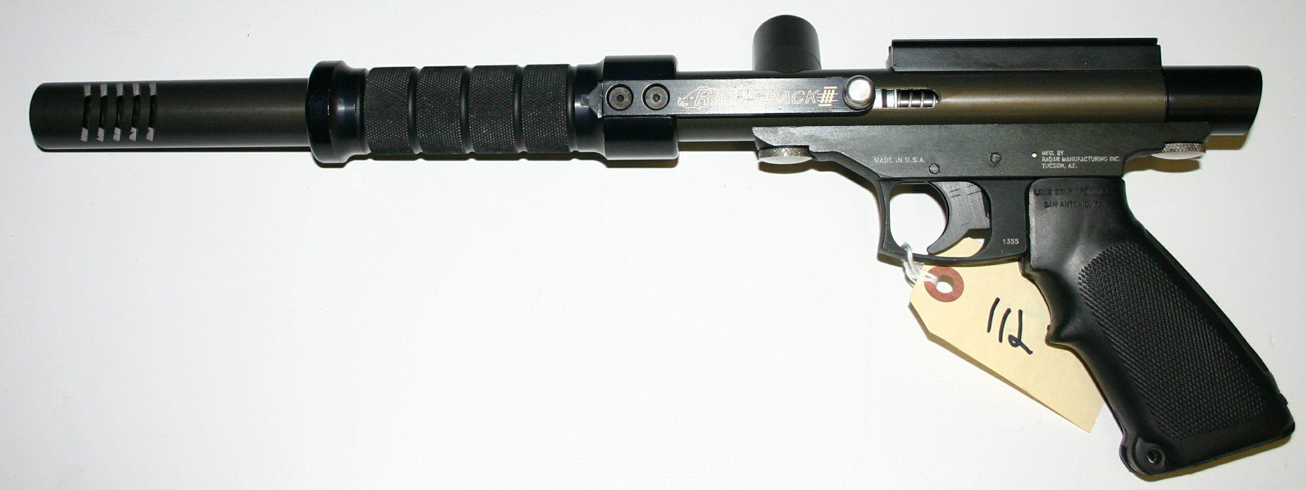

    Both my Razorback III and Bushmaster have fixed barrel syndrome. The Razorback has shark gill barrel venting, so I don't think it is a candidate.
    It would be a real challenge to get the gills straight, and it seems almost cruel to ask someone to do that.

        Two other things: You of course lose about 1-3/8" of barrel length in this mod, and it's worth noting that the newly-made removable barrel can also be Freak-bored. (The customer for this Blackhawk intends to use LAPCO sizers, which is another option.)

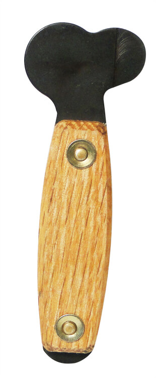

                    Where did you get the tool at 0:33 for removing the frame screws? That looks like it works a lot better than a quarter or flat-head screw driver.
                      -I made it, of course.
                      Back in the old shoebox Shocker days, I was working on so many of them that I made myself a set of custom-fit "screwdrivers" for the various body plugs. That way I wouldn't be scratching up the anno using a regular screwdriver.
                      Used to sell 'em by the set, too.
                      While the shoebox work has long since faded away, having a wide, non-marring screwdriver for things like those thumbscrews and other features has been very handy. Point in fact, that small one has been used so much it's nearly worn out. I either need to make another or mill it back a bit to refresh the edge.
