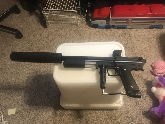

                      #29
                      It’s a 16” smart parts Freak bored with a freak xl adapter
                      The shroud is from jt tac 5 recon
                      The fill is a waterproof and reusable air filter cut to fit
