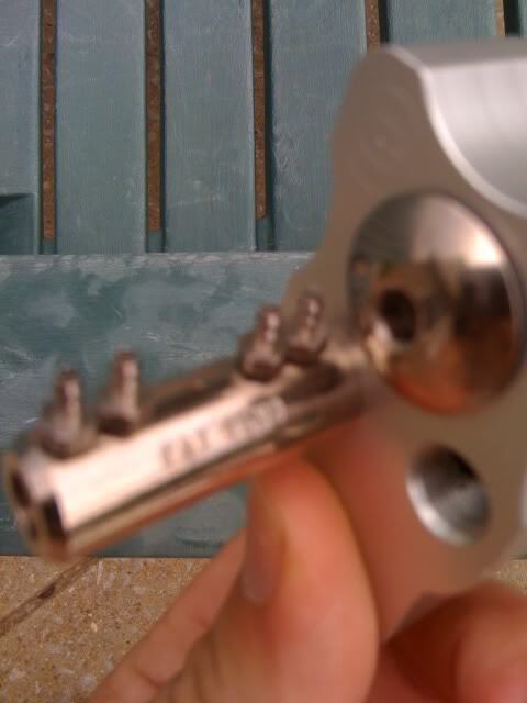

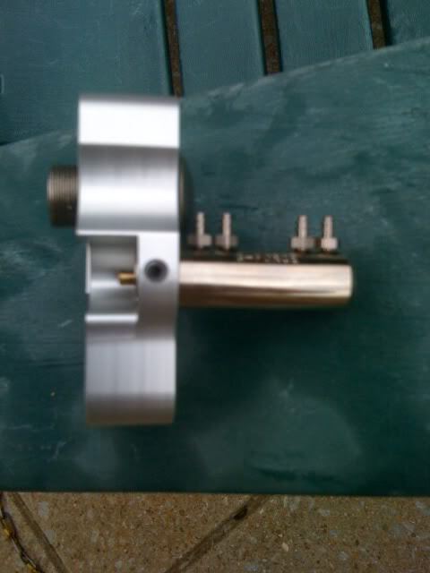

        Ha! I had some old photos I saved from my Photobucket account, before they became greedy bastards.
        For those unfamiliar, the Gemini kit (made by GForce, who tried making a pneucocker-like gun at one point, and eventually produced a limited number of automag pneu frames) had a 6-way (or whatever) and a custom front block that allowed the use of two lprs. One LPR would control the higher recocking pressure, while the other controlled a lower bolt-closing pressure. The idea was to pinch paint instead of chop.
          XEMON commented
          That's really cool, never seen one like that.
          It is two 3 way in one body ... Clever!
          Thanks for sharing the pictures.
        • Brokeass_baller
          Brokeass_baller commented
          No problem. It was a neat idea. Sorry the pictures are so blurry. I'm pretty sure I took them with my old iphone 3g about ten years ago. They didn't have the best cameras. Lol

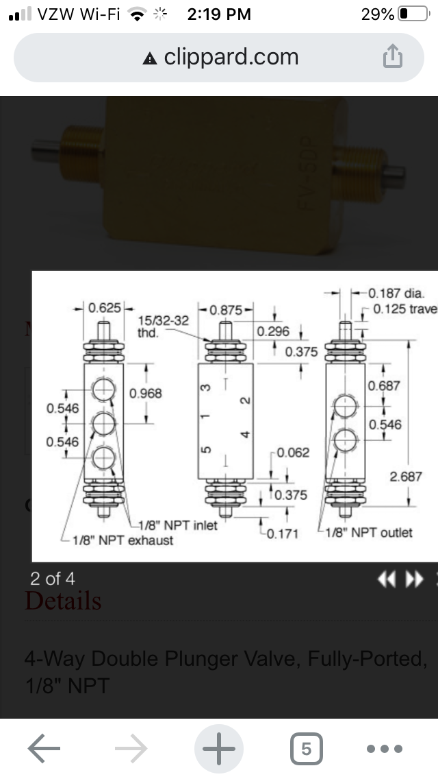

        I wonder if the Clippard FV valves would work? They 2 separate inputs, and direct to 2 separate outputs... but with a single exhaust.
        https://www.clippard.com/downloads/P...Page%20120.pdf
        • Brokeass_baller
          Those look like spring return poppet switches.

        Thanks for posting those pictures! That is the kit i would really like to replicate. So what is the the valve? Is it a 5 way or 6 way?
          XEMON commented
          Looks like 2 3way actuated by the same rod ...
        Where are you seeing two separate inputs? I see one input and two outputs on all three valves on that page you linked.
        • Hp_lovecraft
          • 376
          C6596C33-05BE-428D-83A7-7C19DC0A3BF6.png This is the one, but looking at the dimensions, it’s huge. Haha
