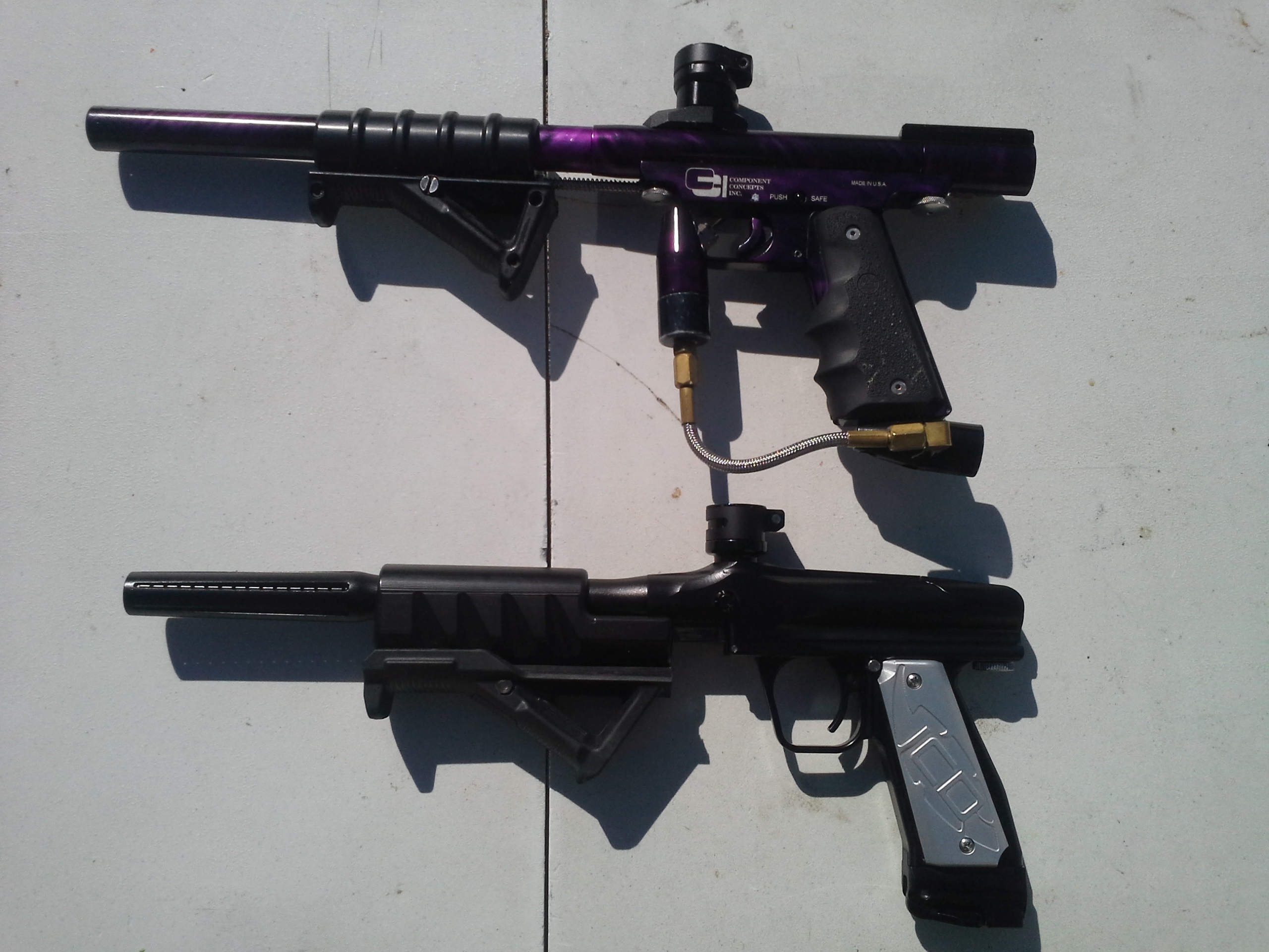

    I love AFG's on pump handles. Just mount a rail and slide it on.
      XEMON commented
      I've done that on a phantom and it's super comfy 👍

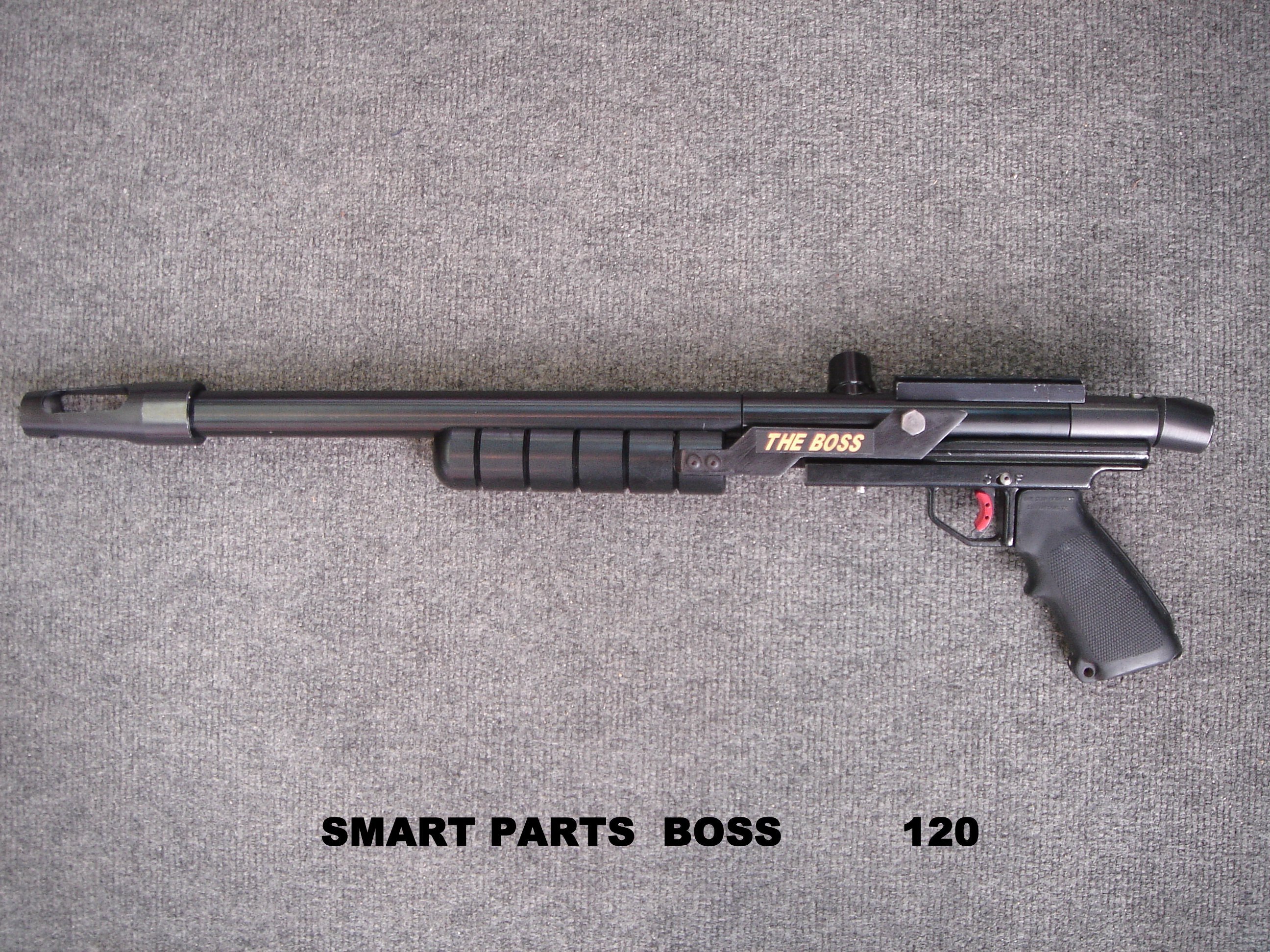

      Smart Parts Boss had a factory undercocking setup. Its quite smooth and has a return spring on the guide. Click image for larger version

      • Toestr
        • 2876
        • Poland, Onterrible
Name:	SMART PARTS BOSS.jpg
        Is this rebranded Line SI? Or a clone?
        • capitalpaintball
          • 308
          • Coventry, Rhode Island
          I'm pretty sure they stole it. its cast, not aluminum, so it weighs a ton. there is a steel guide threaded into it, that slides into the pump handle.
          • Grendel
            • 1980
            • Lexington, SC
            Not sure they stole it but they did not design or manufacture it. I did a bunch of testing on them when they were getting ready to come out and it [SP Boss] actually performed quite well and had an excellent if unorthodox pump design for the time. As capitalpaintball (Hi Dave) says it was a heavy beast. Take a close look at the muzzle bread it is threaded and solid metal it alone weighs more then a current phantom 12" barrel. I wish I had kept the one I tested (they offered it for cheap but not free to me) but at the time I was a Phantom user.....
