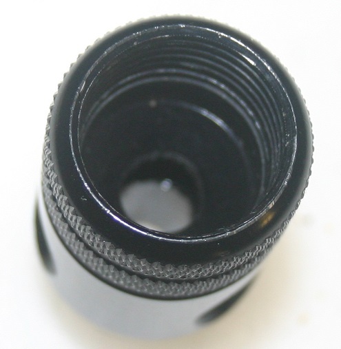

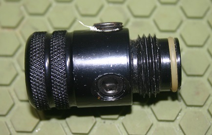

            So, you are using an air source with an on/off? You need to flow air into an ASA, and need an extender that has gauge ports, but no actuating pin? And you don't want it to unscrew with the bottle/source?

              Walker. My thought was machine a pin for one of these exact extenders.

            My air source does not have an on/off. I currently rely upon an ASA on/off which is the reason why im looking for a extender with ports AND a floating pin.

              Critical Hammer. Ill try to remember to snag a reg extender of mine and bring it to work and see if a custom pin in one of those would work. If it does. Id make one and make sure it works and sell it to you for cheap. Id also love to make it happen for myself as I use those reg extenders for under mounting my havoc to randomness, and as of now Im forced to put my SP fixed pin ball valve on off on a tank. Then use the ball valve on said assembly. Not only does it make for a gangly assembly. The ball valve almost needs to be installed and removed on an empty tank as it depresses the pin a bit early and preaurizes the ball cavity.
