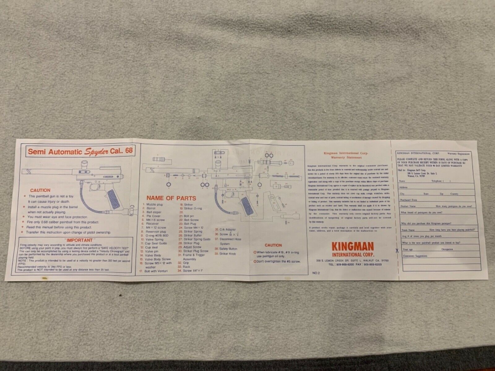

        Look at the parts listing and diagram in the owner's manual of your Spyder and you'll see the size of the striker oring is not listed yet all other oring sizes are. This is true for every year and model of Spyder.
        Click image for larger version  Name:	spyder classic parts diagram.jpg Views:	0 Size:	293.2 KB ID:	256616
        • MrBarraclough
          MrBarraclough commented
          Isn't that the o-ring (or one of them) that deliberately uses tank o-rings in order to reduce the number of different sizes needed?
        • glaman5266
          glaman5266 commented
          MrBarraclough Yes. Spyders used to have a fatter striker. Eventually Kingman slimmed down the striker so it took the same size o-ring as everything else in it. Now basic Spyders only need one o-ring size for the entire marker.
