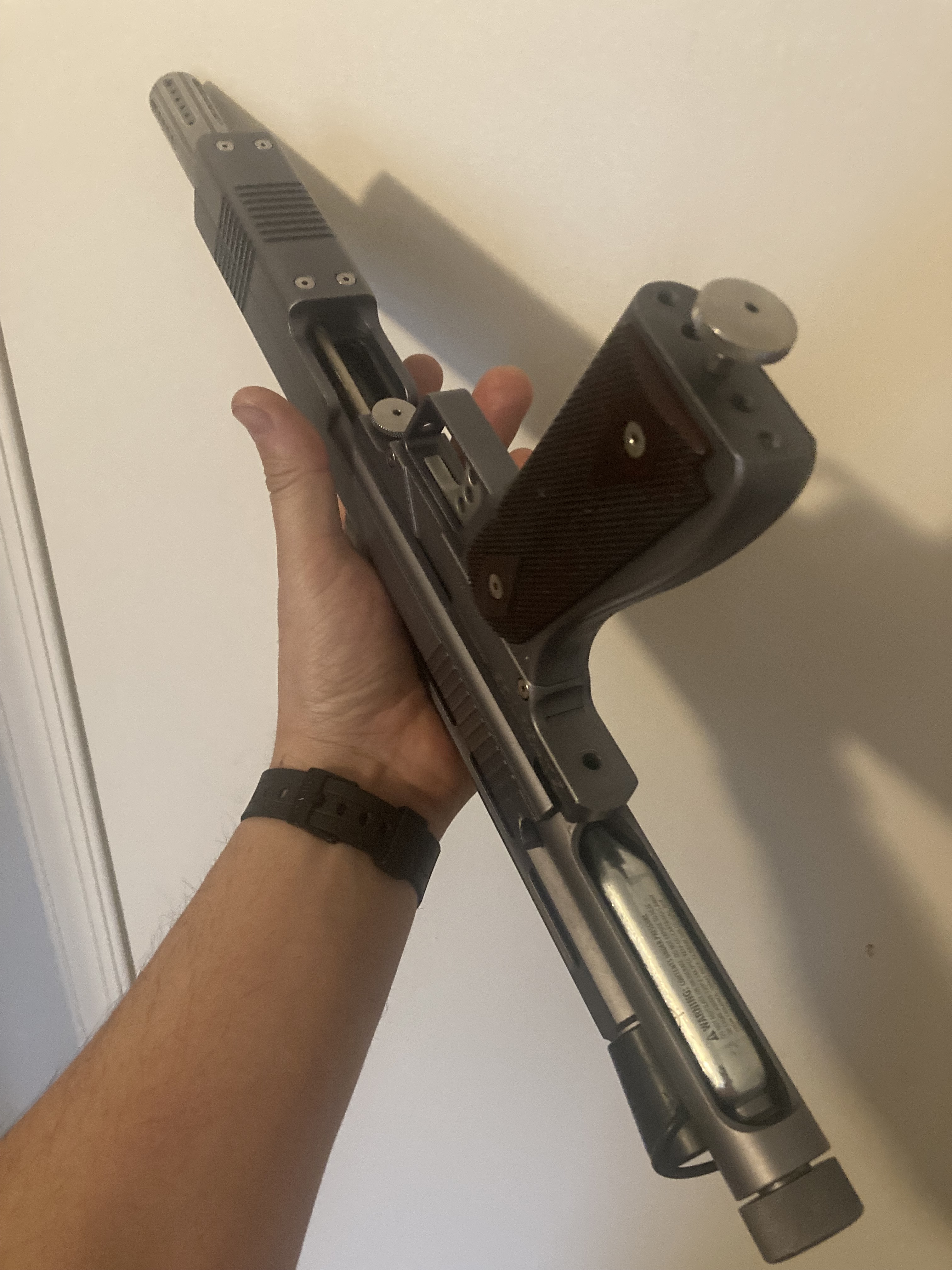

              #128
              The "Blade", the early semiauto made by one of the Team Navarone players back in the early 90s, had a reversible feed neck; you could have it left feed or right feed.
              Doc.
              Such weird guns. The detent is a coil spring running perpendicular to the barrel, and the plug in the back of the top tube can be used as a barrel plug.
              They have a gas-thru frame with no rubber grips, so they get really cold when you use CO2 (which of course you would have at the time).
              The second generation added a vertical adapter.
