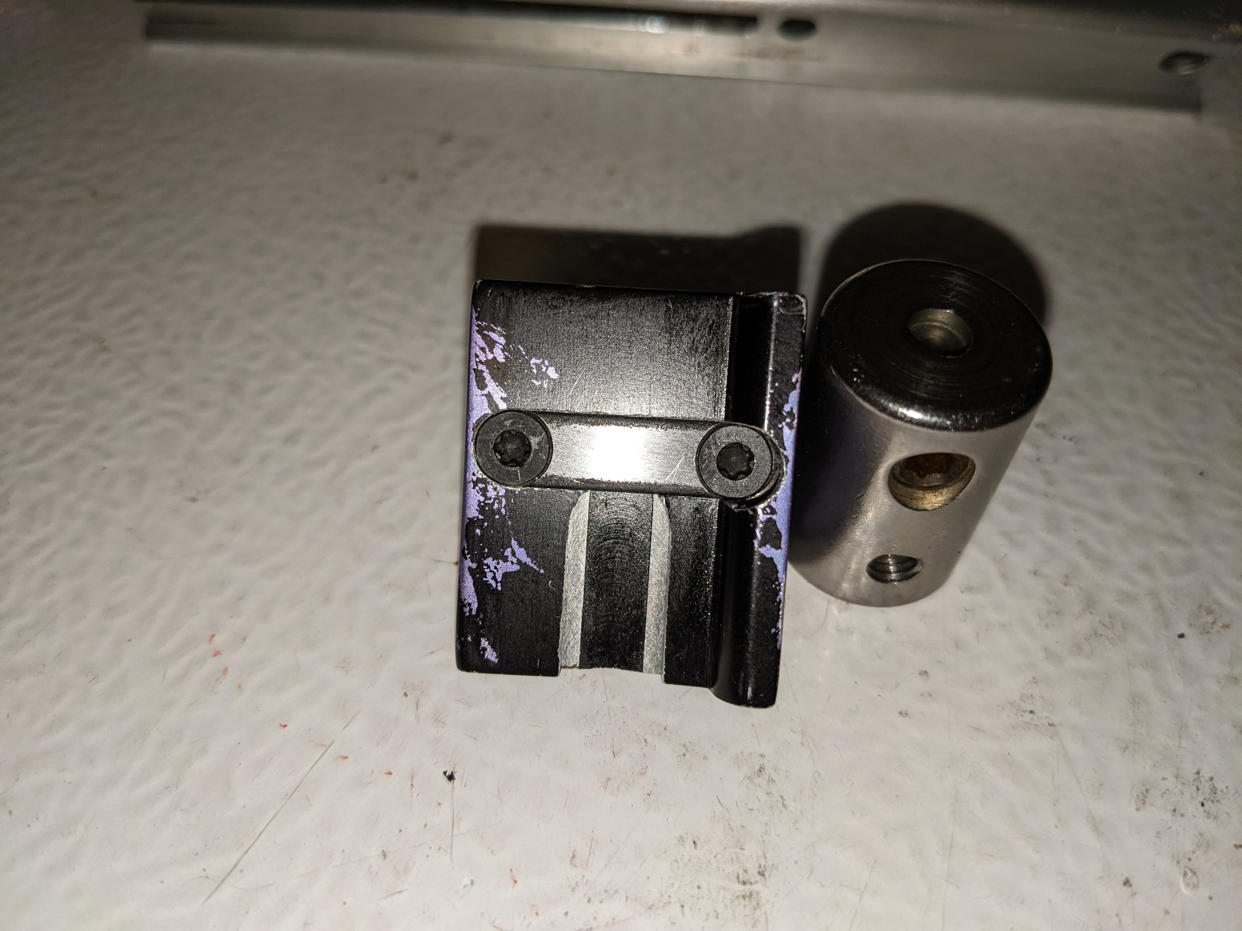

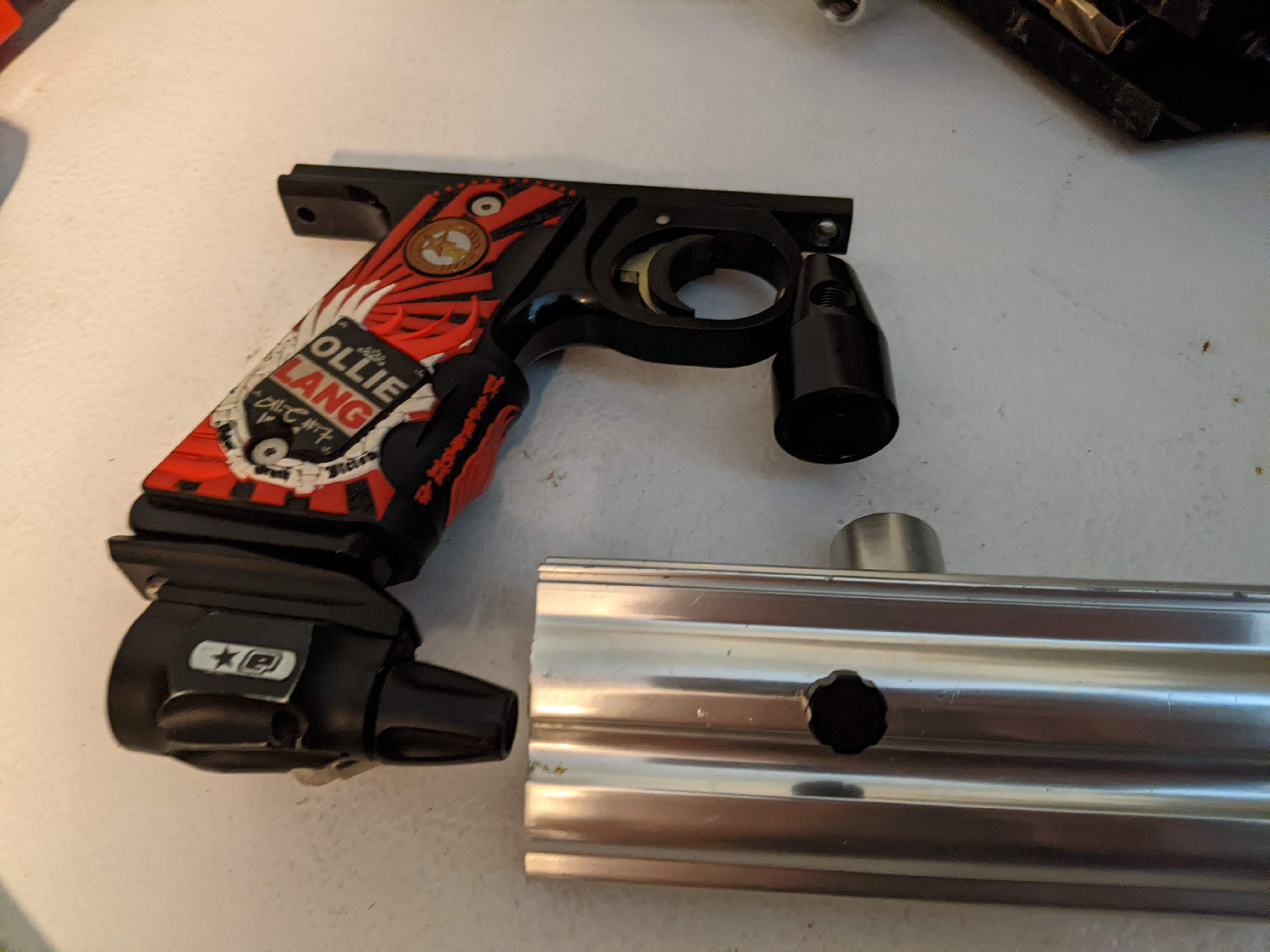

    So I had some small things I wanted done, and I didn't think it was worth bothering one of the Paintball machine shops since it seemed like simple stuff to me. So I went to a local place and I described what I needed and showed them, they said that it was really simple stuff and they could do it in between jobs. I should have discussed prices, that is on me, he just said it was simple stuff, so I figured it couldn't be too much.
    What they did:
    -Tap a cocker detent into an old sterling body
    -Drill a hole so I could mount a Phantom ASA onto a Sterling grip frame
    -Tap a 10-32 hole in a hammer for a micrococker
    -put a steel bar in a micrococker back block
    I will say they did a really good job especially with the Microocker back block, but I was blown away when he told me $360. I told him that was way more than I was expecting, and he told me the back block alone took 4 hours. I said I didn't expect that at all I was thinking like $75-100. And he said that people off the street have no idea what they have invested in the business, and he pointed to his shop and said there isn't a machine in there worth less than $200K.
    I get it, but I figured most of this stuff was something they could do with a drill press. What do you guys think, is this the amount I should have predicted? What do you guys think this work should have cost?
