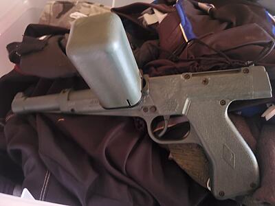

            Year-plus update:
            I was making a fresh run of Speedwheels, when a longtime reader contacted me about an old marker he'd found in his old gear, and wanted to know if I wanted it.
            Yes, it was a very silly question.
            Anyway, I now have a Rapide, complete with mags, to go with my Splatties, and can compare the plugs directly.
            They're not exactly the same, though they're awful close:
            The only significant difference is that the Rapide's threads are slightly tighter. The wheels I've been making are just right on the Splatmaster, but snug- but functional- on the Rapide. I think if I loosen up the threads just a touch- like .005 to .010"- they'll be completely interchangeable.
            Doc.
