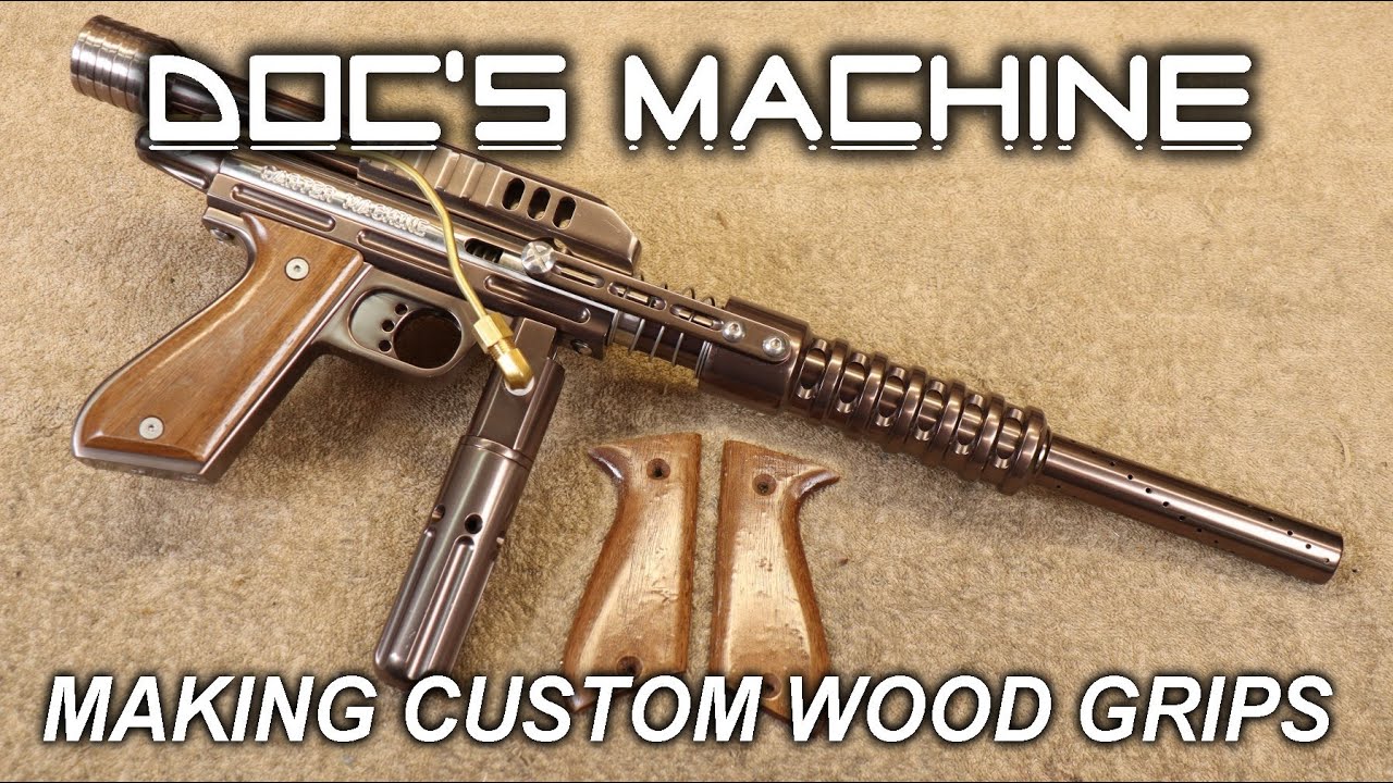

                  Something a little more finished- custom grips for an MCB'ers Buzzard!
                  Not only did they come out well (I'd like to think) but I also managed to put together a pretty decent video on making them. I'll link that as soon as it's done uploading through my ridiculously slow connection.
                  Doc.

                  And here's that video!
                  Doc.
