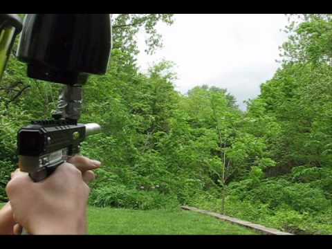

                          cockerpunk covered one in his old guns tour
                          https://www.youtube.com/watch?v=wIhXlspCe8U

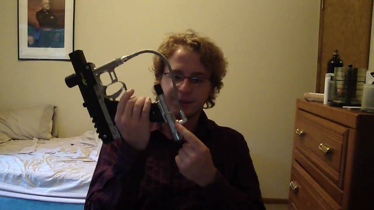

                          qmto did a vid as well
                          https://www.youtube.com/watch?v=d3GBozWmrJM
