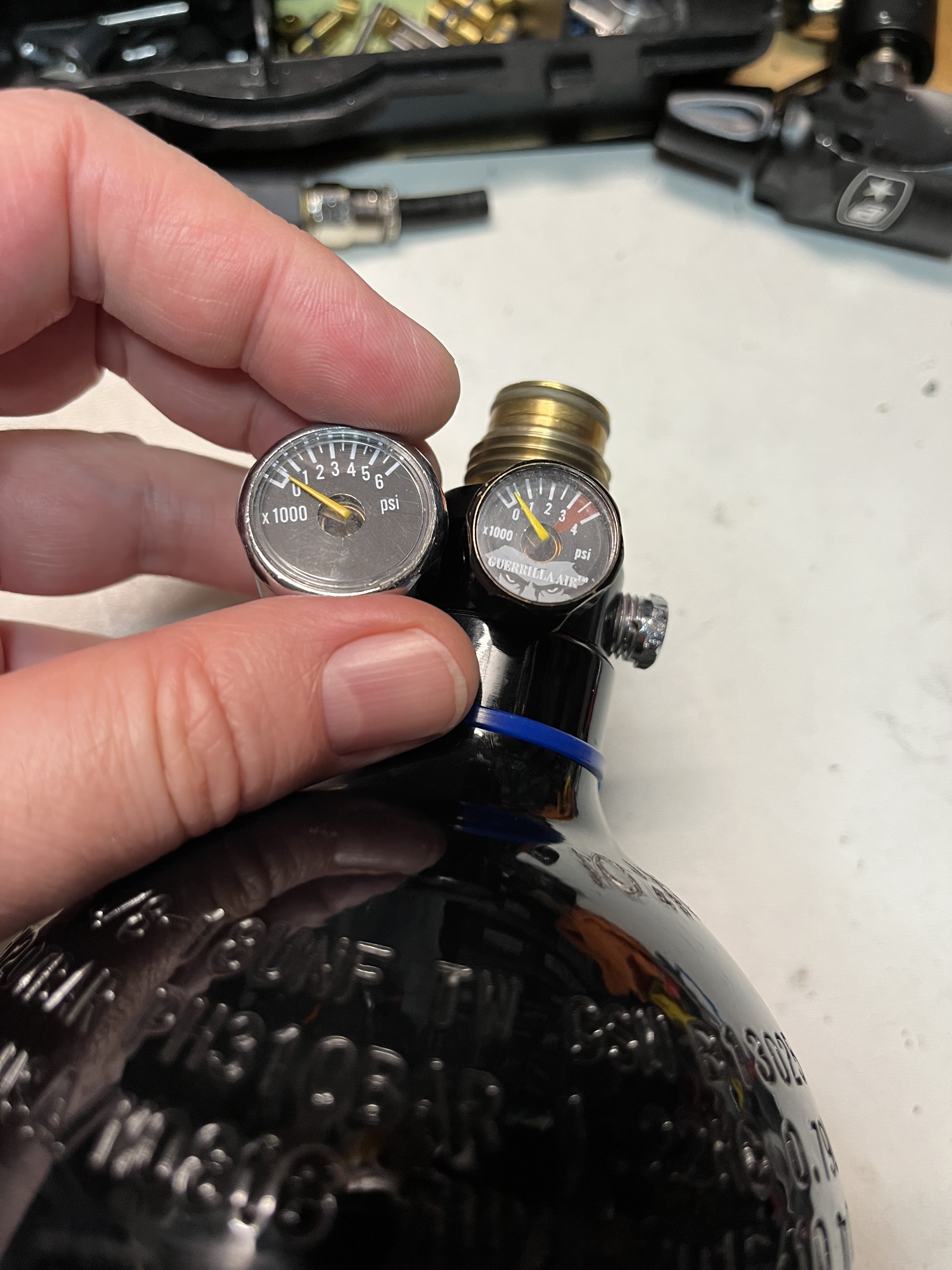

          If you are using a BBA setup, why do you need a smaller gauge? Just for a cleaner look and feel? There shouldn’t be any interference issues with the gauge like there could be with a bottom line setup.
          My feedback
            XEMON commented
            The gauge is hitting the feed tube ...
            On this specific gun, it's kinda of a pain to remove the feed system so I'd like to avoid that.
          • pghp8ntballer
            pghp8ntballer commented
            I understand. Seeing the pic below of the tank reg and gauge in question really helps. I’ve never even seen a gauge as small as the one currently on the reg.

          As far as I know, First Strike makes the smallest gauge on the market right now. Plus their newer regs have adjustable bonnet threads so you can make sure the gauge is pointed somewhere more convenient.
          Here's a picture of a First Strike gauge next to a regular sized gauge that comes on most tanks. The First Strike gauge is the same height, but it has a much smaller diameter.

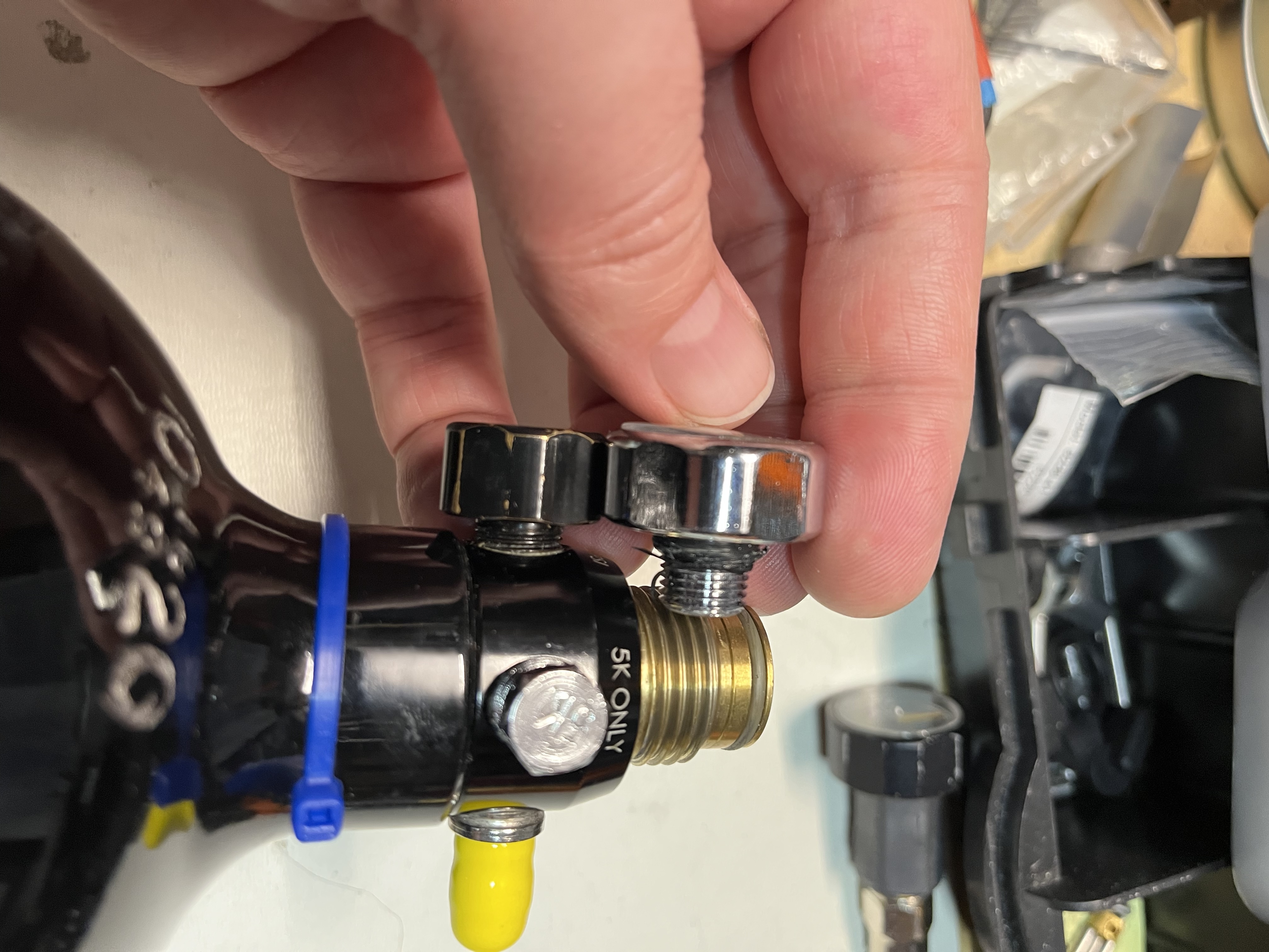

            Have you considered swapping the gauge with the fill nipple? Both of those have 1/8 NPT threads. There are some fill nipples out there that are crazy small, much smaller than any gauge you will ever find.
            This one from First Strike does not have a hex on the outside, which really cuts down the profile. You stick an Allen key inside the nipple to screw it in. It only sticks out about half an inch. The only downside is that the interior hex is weaker than an outside one. I did ruin one of these nipples once when I tightened it down too hard. I bent the top part slightly, just enough so it wouldn't fit inside a female quick connect fitting anymore. But as long as you're not stupid like me and just trust the Loktite instead, you should be fine.

              Dam ... I don't have clearance to screw the tank in the asa ...
              I played with a tank extender, I was hoping for something tighter but I may have to resort to that ...
