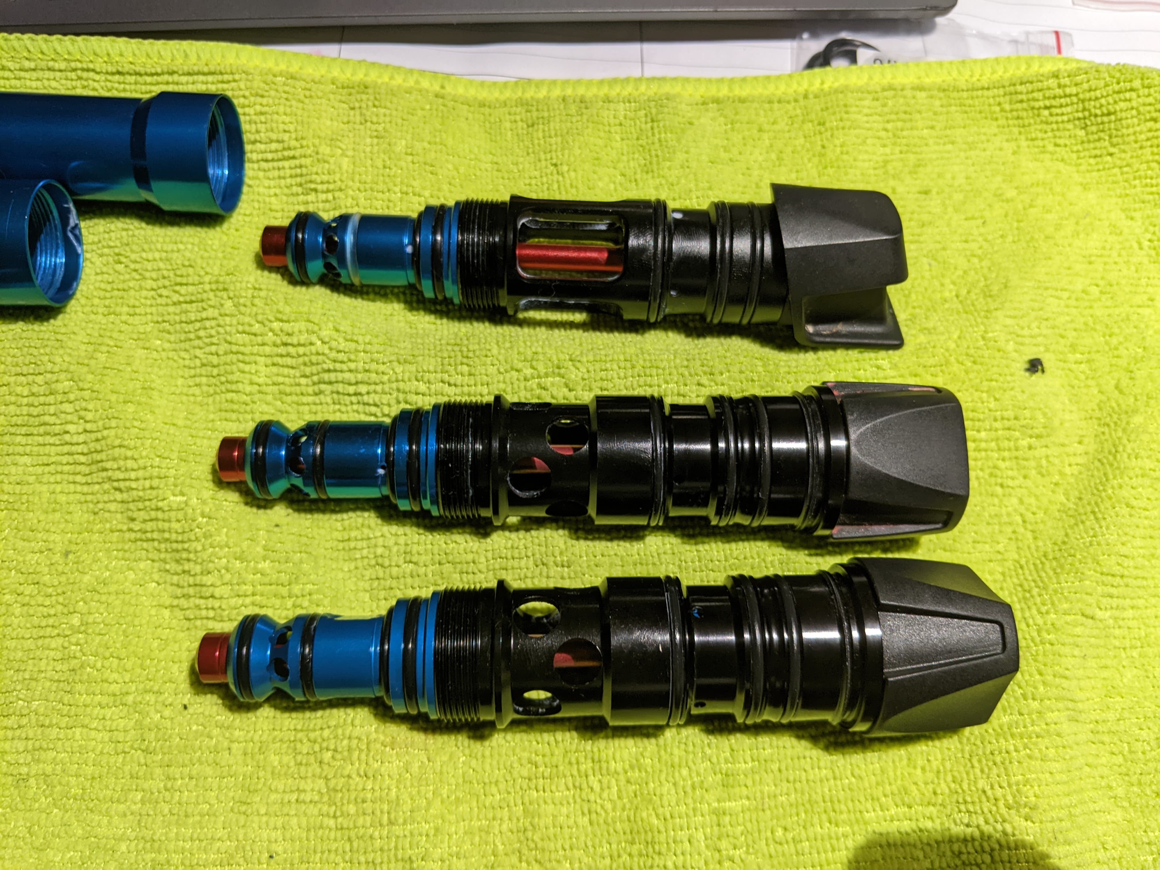

        All of the etha markers (except for the original etha) and the gtek markers have always been the "same" internally, and it's not as if PE was pretending otherwise. They will tell you it's the same gamma core in all of these guns and have done so numerous times in their facebook lives. They have the best bolt system in the game, and they get to streamline their production and offer the best performing gun to compete at several different price ranges. It's a win win for them and the consumer. There is more to the product than the bolt system to most players.
        I also think just calling the body "plastic" is doing the quality a disservice. The GRN is incredibly durable.
        All parts are the same as far as I can tell other than the valve body, and they added wrench flats to the bolt guide at some point. I think they have probably adjusted tolerances (oring glands) on some parts along the way.
        The GP core is a different story, but the simple explanation is the valve closes in a "poppet valve" fashion, with an oring on the spool shaft being used as a face seal to close the valve faster, resulting in slightly better efficiency. It's also very satisfying to shoot in mechanical form, it's a very different feel.
        Gtek, emek, and etha 2 internals pictured

          #19
          The one thing I can't seem to understand is why PE has never offered a version of the FL 3-way for the M170R. Without one, the Etha 3M and upgraded EMEKs actually have a slight performance advantage over the pricier M170R.
          Glass Reinforced Nylon is plastic. Created by a thermoplastic engineer.
          • uglyduckling
            uglyduckling commented
            I understand that it is a plastic, just wanted to point out that it's a particularly nice one. Many would assume that something plastic will be cheap/easy to break.
