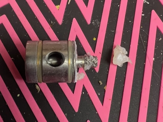

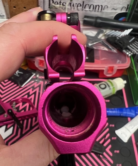

    Tried to play with my Empire Sniper yesterday and it’s blew a massive leak, which I thought was the valve o-rings. While cleaning I noticed chunks of white plastic falling out of the marker. Took it apart to discover this:

    Is the valve pin knurlled and not threaded to retain the cup seal? Odd.
    Time to find a new Empire cup seal. All the other "cocker" cup seals and valve stems I've seen are threaded
    Seems like an opportunity for some 3d printed magic for a TPU or SoftPLA replacement.

        One of the thing I saw on mIne was the 4 point around the cup seal seem to be draging on the lower tube wall of my trilogy. I was thinking sanding them to prevent binding issue.​

          This has barely been used either. Must have been a flaw in the plastic. My Karni pump has an ID valve and worked great yesterday. No issues at all over multiple rounds.

        I have installed a ton of these and never seen that happen.
        That is wild!
        Send an email to sales@inceptiondesigns.com with the pictures. I am sure they will replace it.

        I am pretty sure that is an empire valve stem not the inception valve stem. I want to say I have seen maybe 1 have that happen.
        the inception one should be fine.

          Ah. I may have mixed up which valve is in which marker! My bad. Going to update my thread to correct this
        • 4526
        Here’s a stock cup seal, so confirmed this was a stock valve. Thanks superman for catching that.
